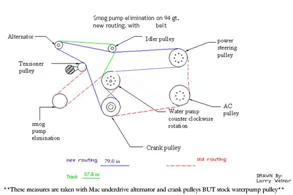

Well since this comes up ALOT in the forum, maybe we should all add our combos of belt lengths and routing and sticky it. Just a suggestion. I will start-
Wazee tensioner, power steering and idler pulleys
FRPP waterpump, crank and alt pulleys(Underdrive)
No A\C=
1020K6 belt
Routed the same way the belt would go with A\C.
Some one posted this awhile back I kept it just in case
I have a/c and smog pump delete with a short belt. I tossed the package, and don't recall what length it is. I used a goodyear gatorback belt on steel march alternator, crank and water pump pulleys with a stock power steering pulley. The simple way to measure is to use a fabric ruler (typically used for tailoring clothes). Configure this "measuring tape" such that you bypass the a/c and smog pulleys. The belt can be normally routed this way. Have a friend hold the tensioner as if it is tensioned half way. This will yield the belt size.
