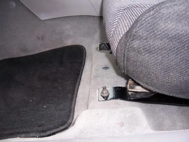

If by "sliders" you mean the seat tracks, then yes they bolt to the bottm of the seat frame. The extenders sold through CJPony Parts, LMR, American Muscle, etc bolt to the bottom of the seat tracks and mimic the floor pan of your Mustang.
The extenders look like this....
....and the seat tracks bolt to it, then to the floor pan like so.
