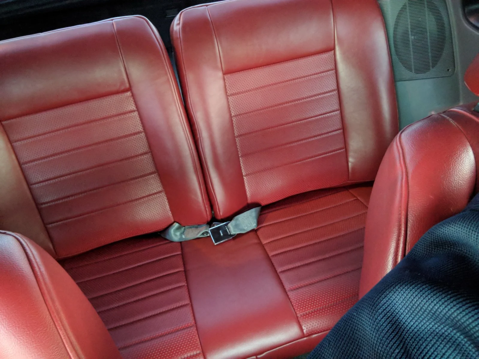

Well, as usual, life had different priorities and its been a while since I have made progress of completing this project. I have, however, been able to complete the seat conversion build. I did cheat a bit on the back seats. It was going to take a lot more time than I had to make the S197 rear seat molds fit, so I ended up taking the rear seats to a local upholstery shop and had them re-cover the stock rear seats with the S197 covers. The shop had to make alterations to the materials to make it fit, but all in all, they turned out OK. I need to adjust the backs a bit still, but other than that...this job is done!

Thank you for updating this even if it is a little on the long side. I just finished installing the front seats as well, but was scratching my head on the back seat as well. The only other person that I found that did the back seat did the same as you, and sent it to the upholstery store as well.
I was planning on doing the same thing, but are curious how much did it cost you to have them do the back seat?

It costed around $300. The only part they were able to reuse was the middle strip; they had to purchase and replace all the rest. Considering what little I gave for the seats, I am still ahead with what I invested in the back seats.
That back seat came out amazing. The color scheme looks great as well. Any more pics of the front and rear seats?

I personally like the stock rear seat recovered. I am not a fan of bottom portion on the S197 and S550 seats. Your passengers sit so low they cant see anything but the back of the front seats and plastic side panels. Job well done! Would like to see more pics when you get time.

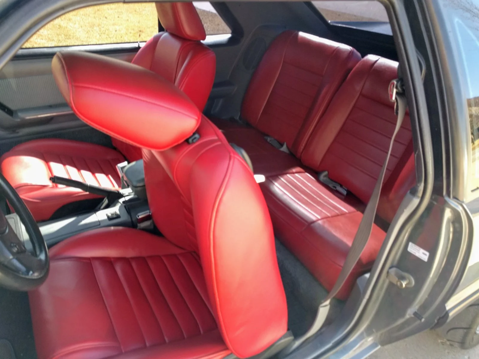

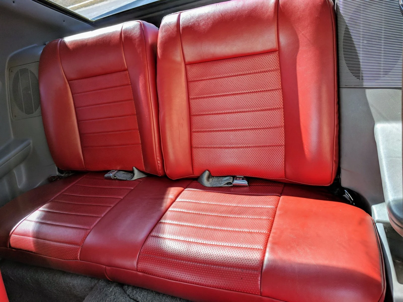

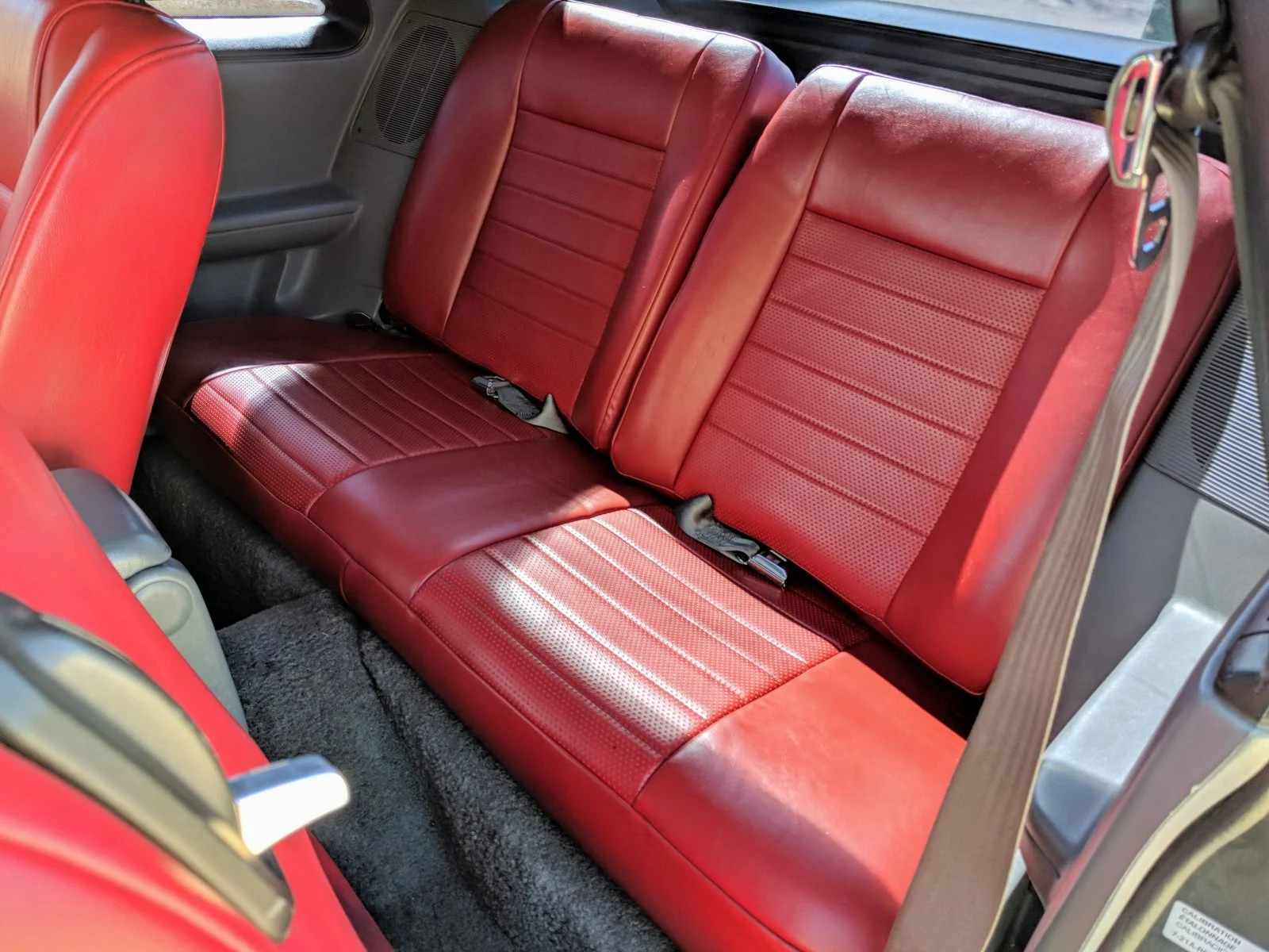

Actually...I did take a few pics the other day that I forget about... Again, the backs need alignment a bit...but these will give a better view of the entire set. I'll get a few more from other angles and better lighting this weekend.
