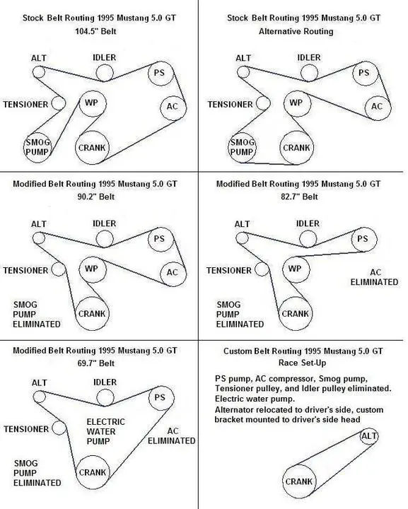

9 94gtfreak Active Member Oct 19, 2008 412 4 39 your moms house Oct 23, 2009 #1 Oct 23, 2009 #1 Like the title says. I'm think of running a shorter belt and finally ditching the Smog pump off the car (not hooked up anyway) and the A/C (it's winter, do i really need it?) but was wondering if anyone had the part numbers for the shorter belts?
4Jenna Founding Member Sep 12, 2001 4,326 6 69 AZ Oct 23, 2009 #2 Oct 23, 2009 #2 Tell them you want a 6 rib, and the XX.X length, thats the part #
