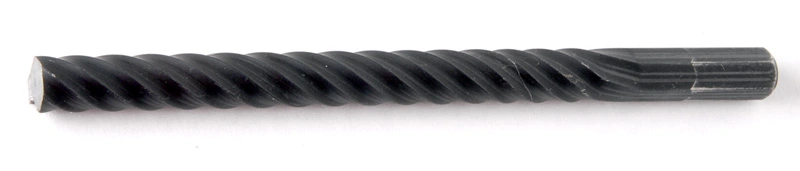

I just hope I got the engine shut down in time after I made a drill bit out of my oil shaft. :notnice:
This happened on the way to the track. I drove the car fully loaded with slicks, floor jack, tools, my daughter, two bottles of nitrous. A brand new tune I had overnighted from Don just for that day. I noticed the oil pressure (stock gauge) was fluctuating a bit. Kept going, I can't believe all the people HERE saying how the stock gauge is an idiot gauge that either works or doesn't... it isn't accurate AT ALL. I'm here to kill that MYTH. Mine works great. Sure it doesn't have numbers, but when the needle dips, the oil pressure is too!
We made the 1.5 hour drive to the track. Got within a block of the entrance.... my oil pressure dropped. I coasted up to the stop sign across the highway from the track. Waited for traffic to clear. Even made the comment. Well I guess my gauge finally quite, the engine sounds fine. As I pulled across the highway. The noise started. I had to blip it to 2,500 rpms or so to shoot out of traffic, then I shut it down. We trailered it INTO the track. :bang:
Anyone ever changed an oil pump IN the car? Or should I just plan on pulling the engine again?

Looks like the stock shaft to me too. You can change it in the car...but it also depends on your oil pan. If you can get the pan off, it is cake. Use a STANDARD volume stock replacement oil pump. You'd be surprised how LITTLE oil the motor actually needs...it just needs it in the right places.
Get a hardened shaft and a new pump. Change em out and stick a magnent to the bottom of the pan to collect any shards/microscopic pieces of the broken shaft.
You'll be golden! :nice:
I had a problem like that with a 289 and a MELLING pump. I replaced it three times! (Pump AND shaft. The second two shafts were hardened and none of the pumps was HV.) We cleaned the pan and stuff, the first time. It was still clean for subsequent changes. I never did get the engine to run for more than about 20 minutes before it would twist the shaft like that. (That pic took me back. Kinda like a flashback.) We pulled it and put in a good, later model 302. I feel your pain, here.

For anyones INFO: I have a stock replacement pump that has been through 3 motors (all with stock pans)...Hardened FMS oil pump shaft. I have NEVER seen any failure let alone one like this. I have reved the motors to and past 8K as well. Get rid of that melling. Check the dizzy too...although it definately sounds like the pump.

That was a stock shaft, the hardened shafts will break not twist. Check the clearance between the dist, the sahft and the pump if it is too toight you basically have no play in the shaft and it will yeild to a failure.
I find most MSD dist need to be trimmed to obtain the proper clearance. Use the Ford Racing shaft it has a longer relief area ;) If you have any questions let me know....
