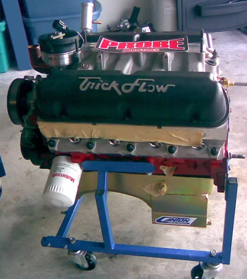

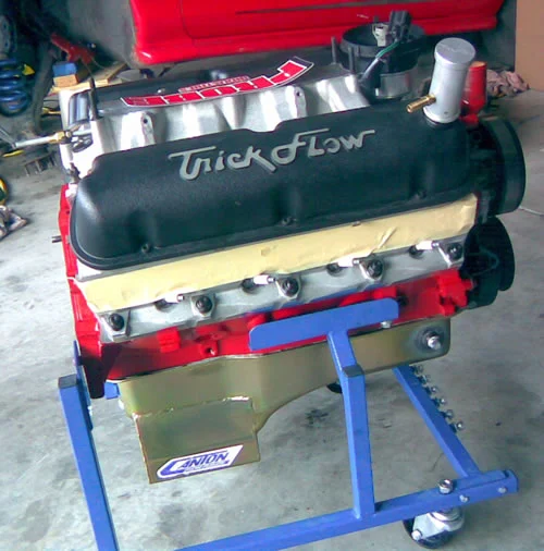

Squeak's old block looks a little different. :lol:

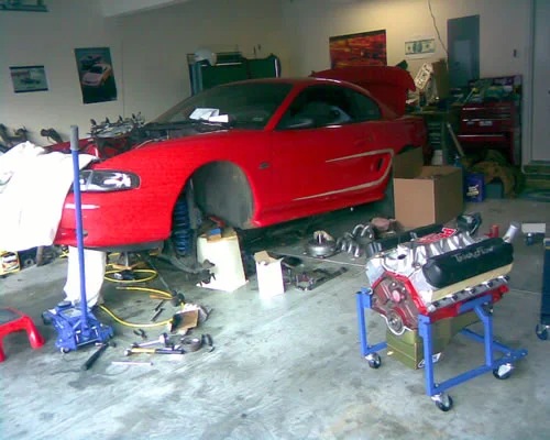

Here's my mess of a garage.....
I wish I had a garage like that...right now my car is sitting outside getting the **** beat out of it by the weather. Also my car would have been done so much quicker if I had one too. But on another note...Paul its looking good. I wish I had that engine too but enough about what I want.
It's the exact same setup. Stage II cam. All the major pieces made it. The block was changed due to it being decked too much when I bought it (used and pre-machined). When the oil pump locked up it did scorch the piston holes. So I'm glad I went this route. My pocketbook isn't so happy about it though. :bang:
