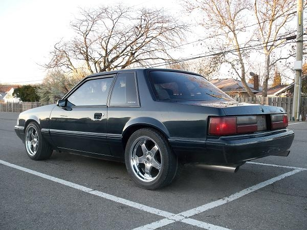

I think springs are a must for a fox body, nothing worse than the stock 4x4 stance. I put a set of Eibach Pro-kit springs on mine and it was probably the best exterior mod I ever did. 17x9's all around and no rubbing (unless there are people in the back seat.)
