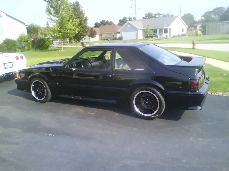

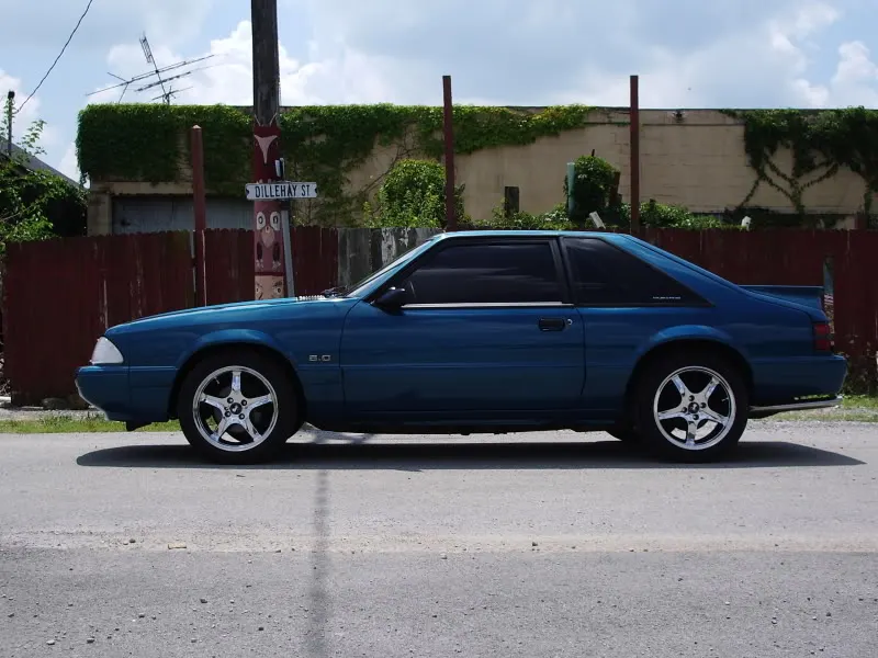

IMO every Fox needs lowered unless you're running fats and skinnies. There are some cars, for whatever reason they can sit like a trunk and still look nasty. When i was a kid there was this guy with a Cutlass that sat up really high but it just looked mean as hell. If it's not lowered, it has to have a teeny bit of rake to it or it just looks silly, and most stock spring cars sag in the rear.

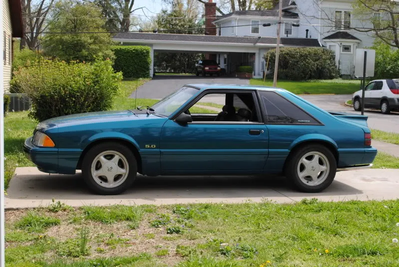

I don't think my car sits as high as some other hatches do with stock springs. But I do want that slight raked look of the Bs and Cs. I'm just going nuts being laid off and trying to find a job so I can finish getting some parts.
Well we installed the fronts today and the car rides awesome with the struts set at the third softest setting. The height is the same as before, so I'm hoping the new isolators settle. The driver's side spring had the last two coils broken off and was stuck in the a-arm!
