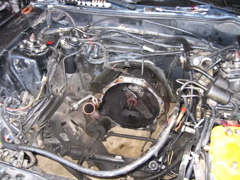

Its sitting on a frame machine..
so its a good 2-3 feet off the ground, and I have access to the entire middle of the car, so I think I will try and pull the trans out with it..
For my cherry picker I am going to use a bobcat.. I almost have everything ready to come out, will prob pull it tomorrow..

I pulled the engine with the trans a couple of weeks ago.. The only thing i didn't like was the gallon of ATF that leaked all over the floor from the end of the trans
