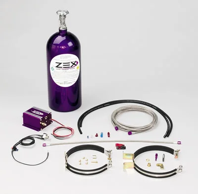

i've always been weary of running no2 on my fairly stock motor.... and to be honest, i don't know all that much about it. i've never been all that interested in the spray. i found a full zex kit (75-150 jets) with 3/4 full bottle, that has been bolted on but then never used for $450 obo locally (i'm in alberta, so that seems pretty cheap to me). my main reasons for not doing it is having to keep paying to fill up bottles , and i don't want to wreck anything in my engine although i know it's not as much of an issue nowadays than it used to be. is this a deal i should jump at, and why or why not? what can i expect to pay to fill a bottle, and how long do they last? i just don't know much about this so i'm looking for all the input i can get...
I would definately offer less. Check to see if it has accessories with it like a purge valve, gauge, bottle heater, ect. It is around $46.00 to fill a 10 lbs tank around here. Its definately fun! A 100 shot is great on a stocker with bolt ons imo. As long as its all in good working order that is.
I run a Zex kit...easy install for sure. Really all that's required for the 75-100 shot is to dial the timing back (10 degrees would be ideal IMO for a stock HCI car) and enjoy. Your only concearn is no hitting the bottle untill your over 2500 rpm and avoiding first gear. First gear only because you're going to loose traction and over rev is very likely. A 'window switch' with a gear select lockout would be ideal...and you will LOVE the punch. Soon you'll be making "can I run more NO2" threads I gaurantee.
so how long does a bottle last? i did some research and i guess it's about $80 to fill a 10lb bottle here.
i emailed the guy, he thinks its PN #82015 so this is what it should be (75-125 dry kit)...
and it lists at summit for $536. i'd imagine i could add another $100+ onto that to have it at my door when all is said and done.....
guy says he had it installed, never ran it, then had issues with the rebuild on the motor he was going to run it with, and ended up going a different route. comes with a 3/4 full bottle (because he gassed his sleeping buddies one night apparently:shrug: ) would $400 be a good deal?
so i'm sure it's a terrible idea to run with the valve open all the time right? i'm guessing i'd have to stop and crack it if i wanted to run the juice? what about the laws with this? is it street legal? what about at the track? any special added safety stuff i'd have to worry about? i've never been, but i will be to the track this summer.
what all else would i need (or would be highly recommended) on top of what's pictured? i'm thinking stuff like purge, bottle warmer, etc. . What would i need to keep it from kicking in in 1st gear (which is already fairly useless) and at a set rpm like suggested above?
thanks again!

No you shouldnt run it open all the time. but this why they make remote bottle openers. flick of a switch cracks open the bottle and your set.
or you can mount the bottle behind the passenger seat or elsewhere that is in arms reach.
or custom built into passenger seat ass cushion fast and the furious style. lol
I am currently running the same kit you are looking at buying. I LOVE it! No regrets here. Fillups are only about $38-$40 here...are you sure that its $80 to fill up where you are? You can get about 8-10 good 1/4 mile passes out of a bottle with the 100 shot. You really should look into a remote bottle opener though. I had an encounter with a supra where i wished i had one!
