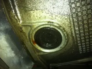

And is this an oil leak????? I dont know what section that belongs too.

thats your bell housing, where the engine and transmission come together. looks like what i call a seep not a leak. if you dont see lots of dripping on your garage floor i would not worry about it.
