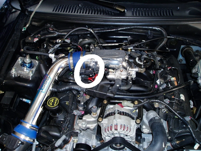

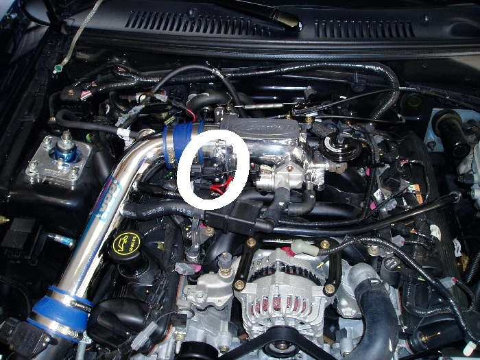

show me what the tps sensor is in a picture.

I have idle problems on my TB / plenum accufab install. show me a picture of the tps sensor.

04DarkShadowGT said:
If I am thinking of the right thing then...........
Its the black sensor on the side of the throttle body. I dont have a picture but you cant miss it, its the only electical connection to the t-body.
TPS - black sensor in the circle.
