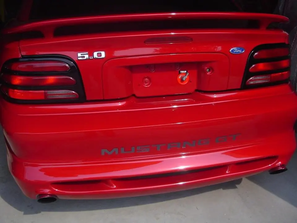

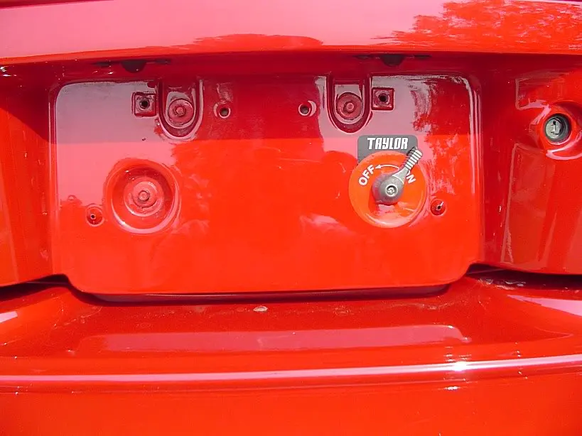

if you dont want to cut or drill then this method probably isnt for you.
someone over on corral did it this way and i did it the same thanks to his help.

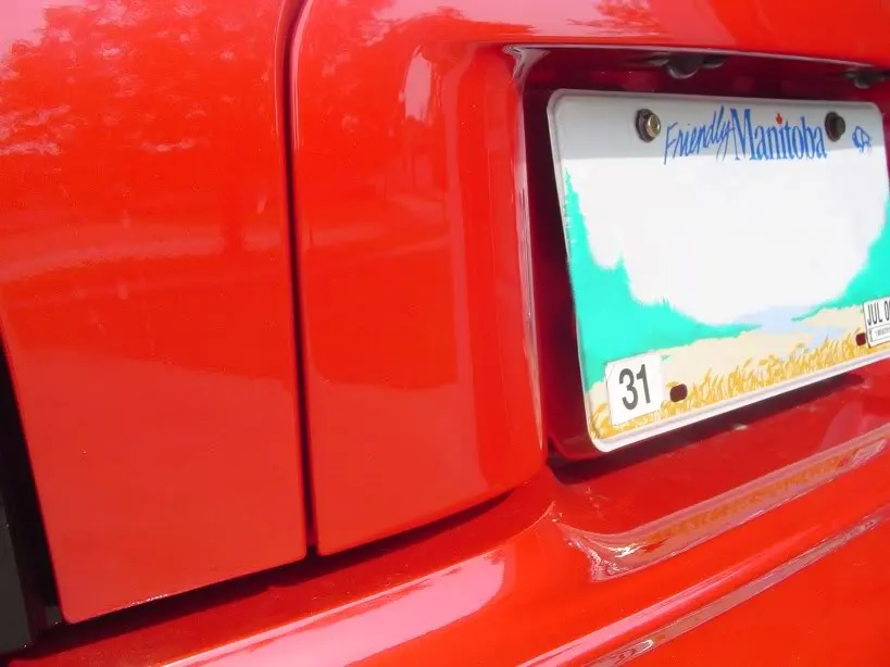

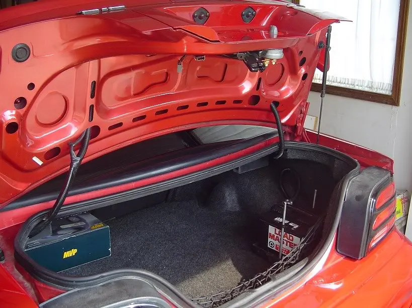

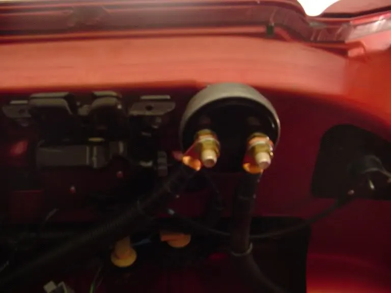

the switch is a Taylor brand. i removed the bolt where the switch is located and i drilled a larger diameter hole so the switch could fit through the trunk. i think i used a 1" bit. then i had to remove some of the sheet metal in the trunk but it wasnt much. then i fed the battery cables through the trunk lid to the switch. i got some longer bolts for the license plate and cut some rubber hose for spacers. when ever i get around to it, i'm going to pickup a fold down license plate frame so i can have easier access to it.
heres some more pics
