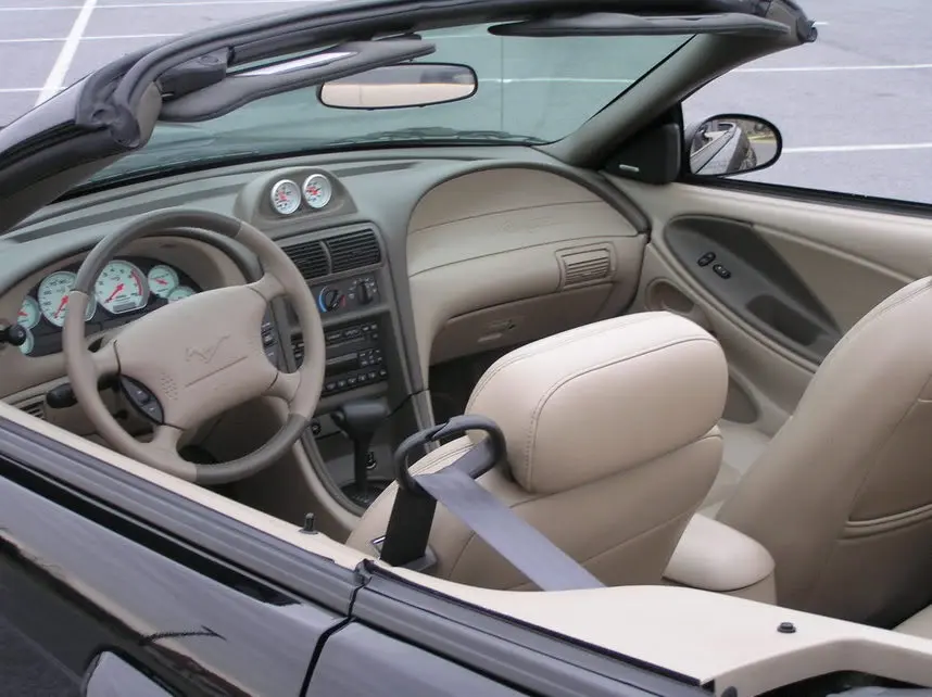

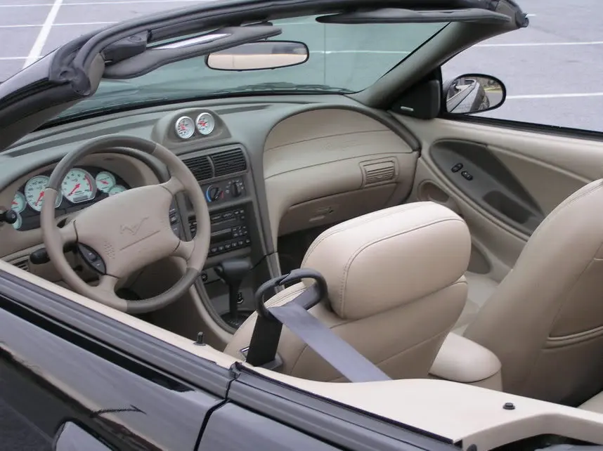

define simple, do you mean simco? here are more autometer lunar, I like the guages in the pod so my passengers can watch the fuel pressure and boost,that and the fact that I could not find the pillar pod for a 04 vert when I put them in.

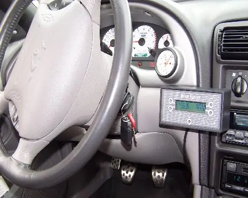

sumthin you wont find in a mustang, custom InfoCenter by W&S Motorsports
ACT (Air Charge Temp)
ECT (Engine Coolant Temp)
TOT (Trans Oil Temp)
Oil Pressure
Delta Fuel Pressure
A/D counts
A/F ratio
HEGO voltage
MAF Voltage
MLPS Voltage (is my MLPS OK?)
EEC command gear (1.2.3.4)
TC state (Locked or unlocked)

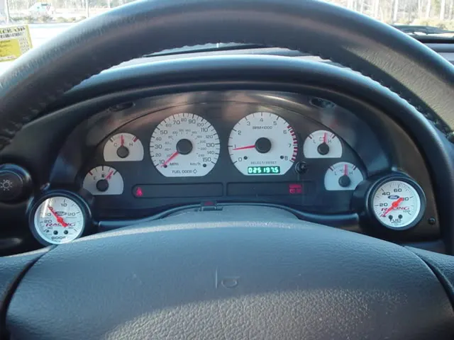

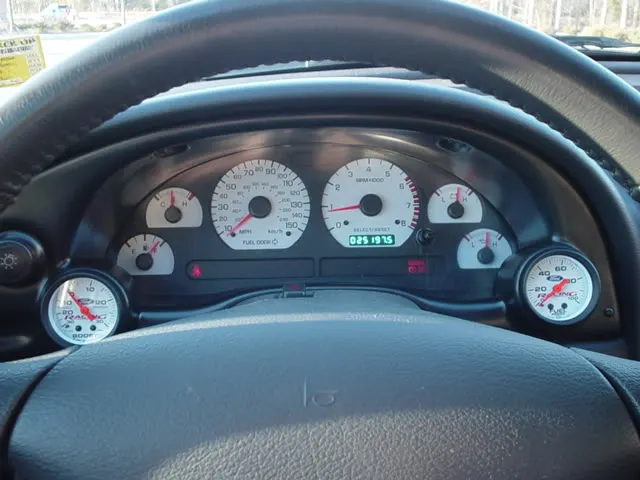

custom job from scott... http://www.customgaugefaces.com i told him what i wanted on them and he made them for me. they have the tbird wings logo on them and the ford racing logo, i used that cause if i ever get any aftermarket gauges, they will match the ford racing ones. i might have another pic around here of them close up if i can find it ill post it if not ill take one and post it.

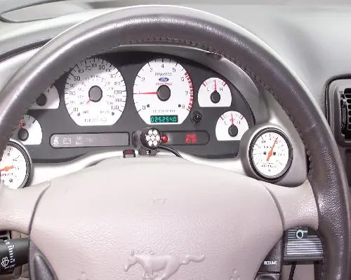

Here is my setup:
It is a Bullitt cluster that I got off of eBay with Aluminum Trim rings from Explicit Auto (http://explicitauto.com/explicit_auto_final_ecom2_002.htm)
The Bullitt and Mach 1 Clusters are direct bolt-in, you just have to swap the odometer from your original cluster to the new one so your car will start. I went with the Bullitt versus the Mach 1 cluster to keep the SOHC redline correct. The Bullitt cluster has a lower redline compared to the Mach 1 Cluster (SOHC vs DOHC), but other than that they are the same cluster.

I like that..subtle :nice:

What do you mean you have to swap your odometer from your original cluster????? :shrug:
Why would it not start if you did not do this??? :shrug:
