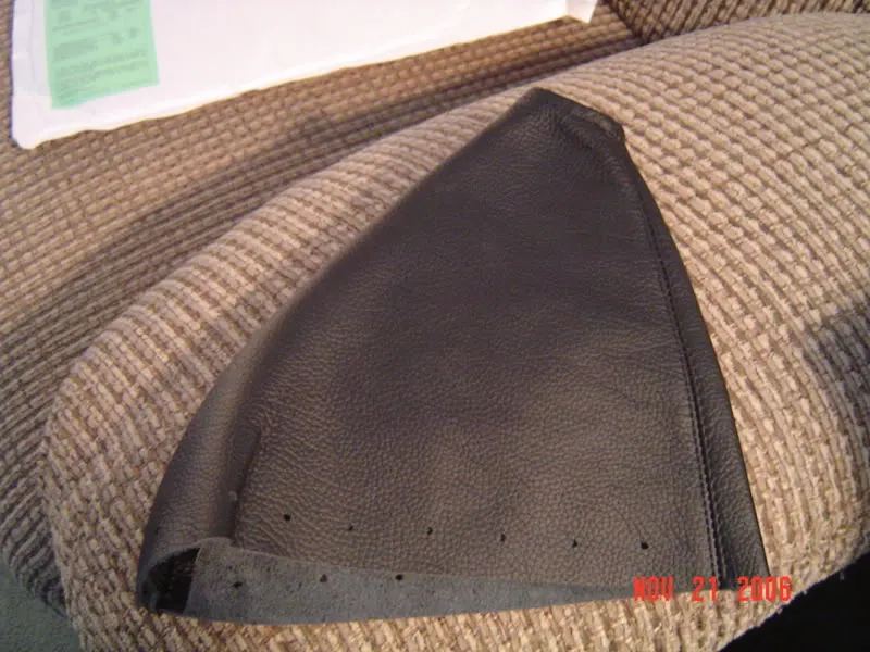

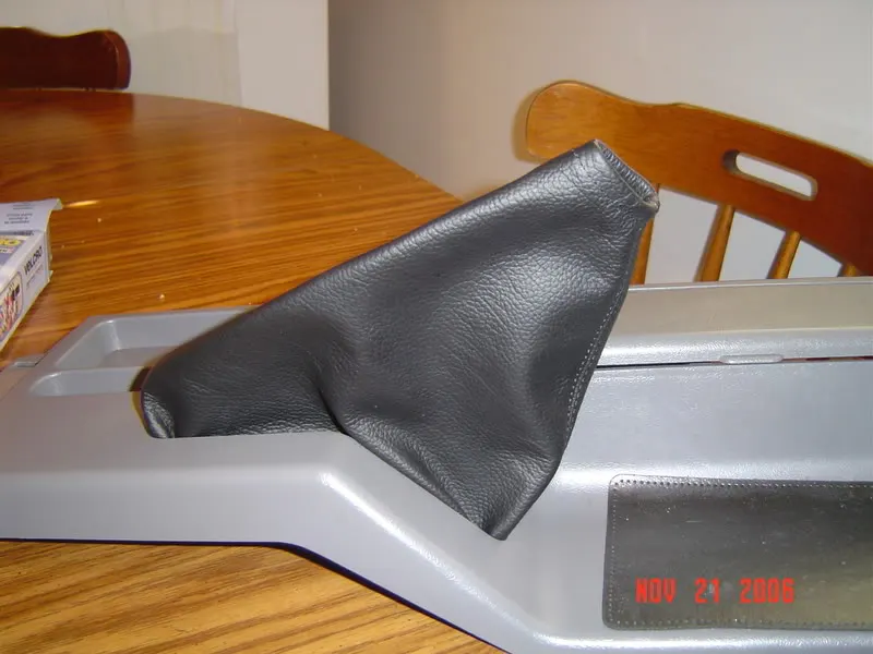

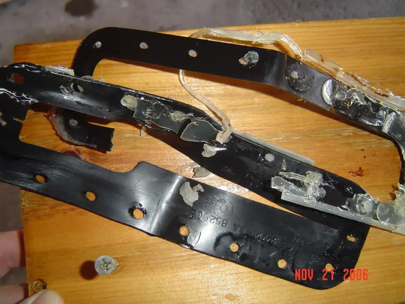

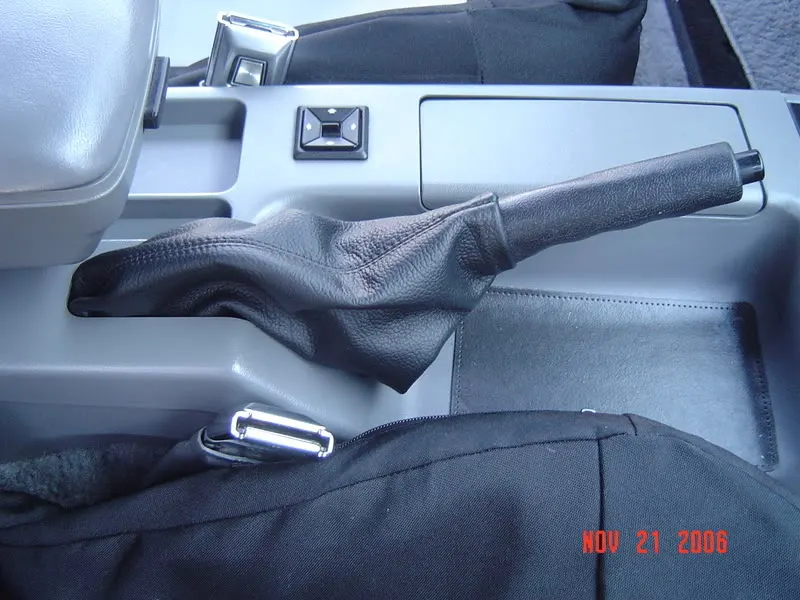

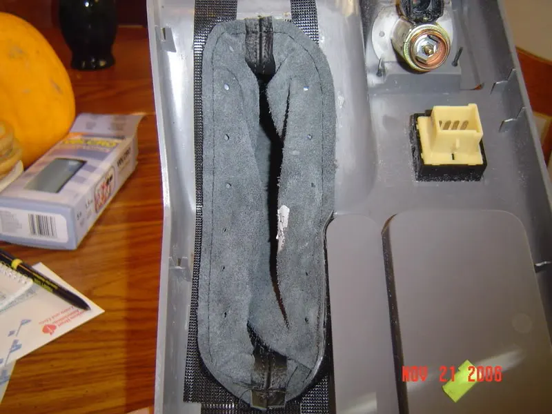

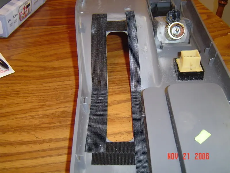

When i put in the e-brake boot, yes I followed the directions. I used the super strength velcro and applied it to the console. You can get it at wal-mart in the craft section. Just make sure you clean the plastic good with alcohol for a good stick.
Thanks, I can hardly believe it has been on the car 2 yrs this November. I moved to a house where I have to set the e-brake on a hill and it is so much nicer not having to worry about that silly rubber insert coming loose.

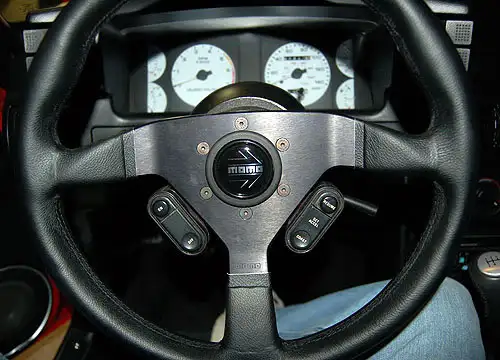

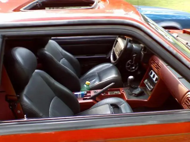

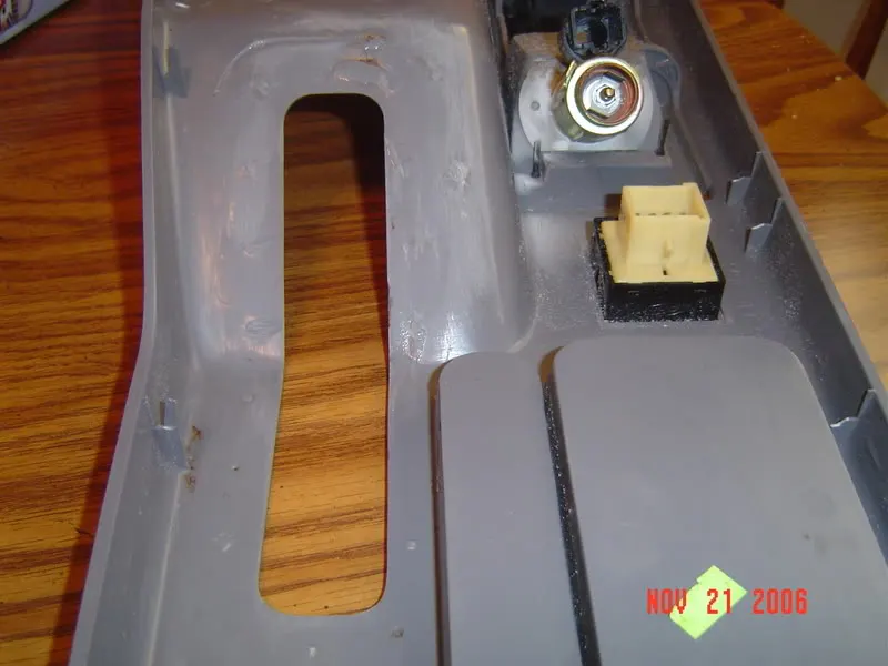

I made the gauge panel , switch panel in the cluster out of carbon fiber in my '86 coupe. I also cut some out & epoxied it to the passenger side dash piece. Still not finished, need a few more things to finish it up. Steering wheel kit is on its way so I can mount the new wheel. along with a pillar pod to mount my wideband & shift light.

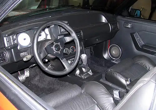

Yes, my shift knob is a cue ball. I can't justify spending $40 or more on a damn knob.
Better pic of the console before I put it in the car.
