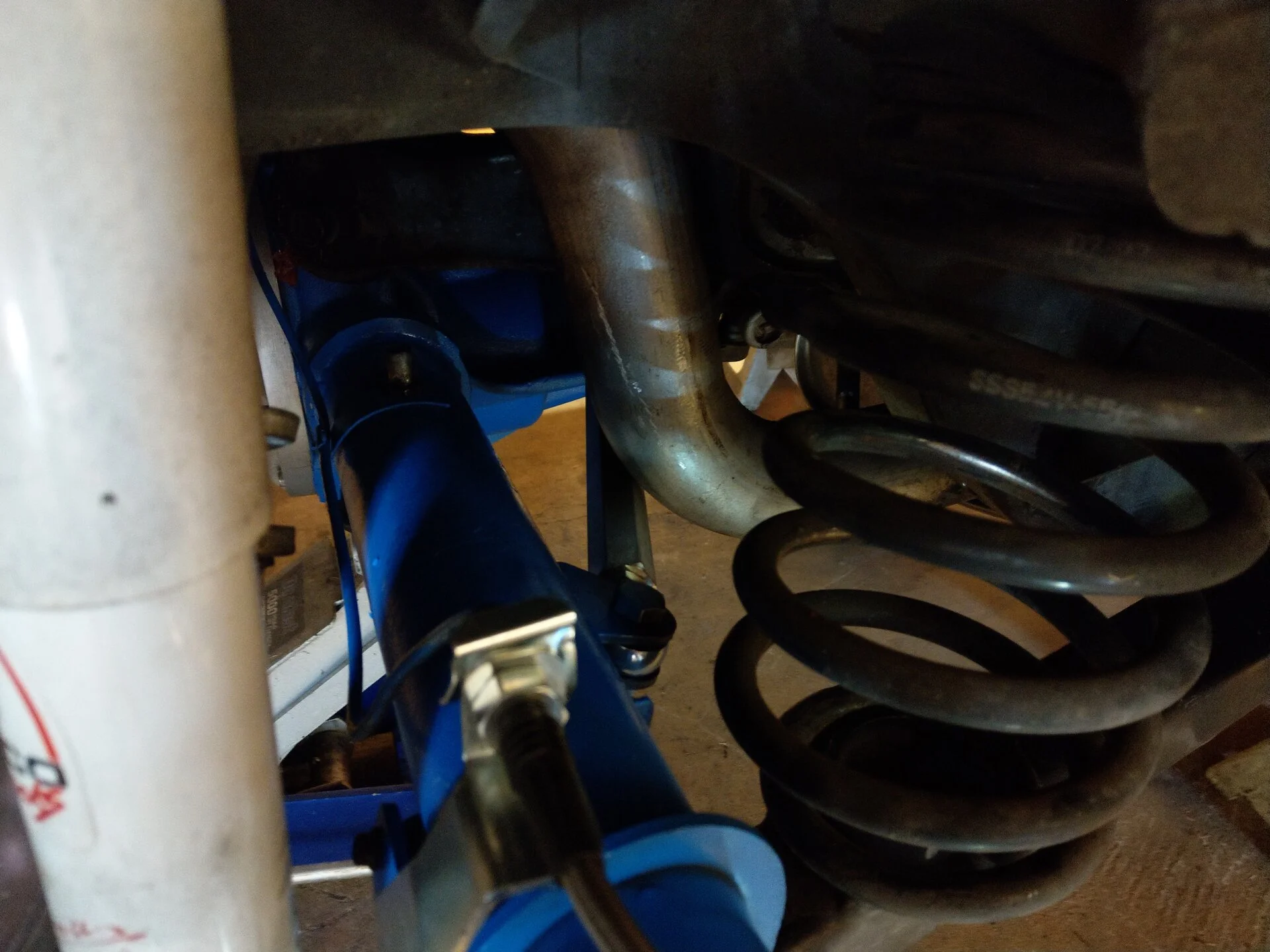

Things are always a hassle. The front bars for the axle sounded like a good way to strengthen it. However, they don't clear the tail pipes, not by a long shot. So I guess they will have to come off for now. I drove around with dumps on the car for over a decade, and I am not going back to that. I got tired of sitting at red lights and getting high on my own supply.
I'll have to go to a bigger exhaust when I get a new engine anyway. Any ideas for side exit exhaust with subframe connectors. Cutting the ones in there out is a huge hassle. Although I imagine that if I do 12 point cage, they will no longer be necessary anyway.

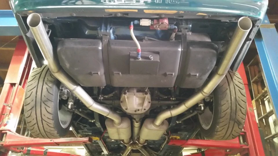

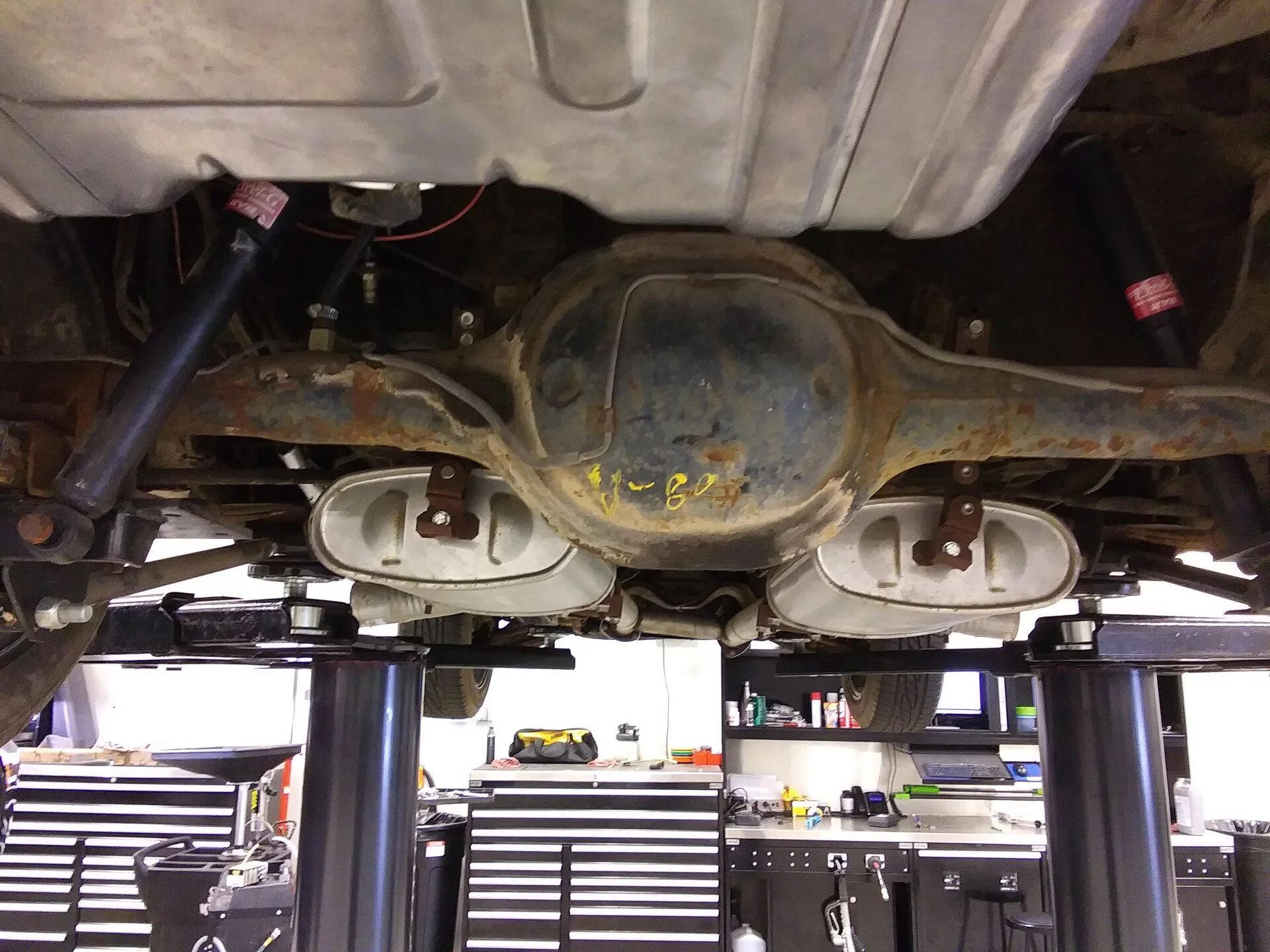

Dynomax makes a muffler that makes side-exit exhaust easier, it has the inlet and outlet on the same end of the muffler. Here they are on ElSuperPinto:
In the picture, my actual exhaust tips are missing because they were in the way of the lift, so I took them off. Having had this setup a few years, I'm forced to agree with Mike that it's a bad idea, even with the tips on so that the exhaust makes it all the way out of the car, it just drifts up the side of the car and into the cockpit through the windows when sitting at a stoplight, when staging at the drag strip, idling through a parking lot, etc.
I have plans to redesign it with 120-degree pipes to bring the exits back to the rear wheels, but I'm not 100% that'll solve the "getting high on my own supply" issue.
On the bright side, it's MUCH quieter than dumps in every way.

I'm forced to agree with you. I'm much rather have tail pipes. Not to mention real mufflers, which I don't think I can make work with a side exhaust. I'll have to get the car on a roll on life sometime and really do some thinking. There is almost nothing in the way of space between the upper control arm, and the frame rail. Maybe the oval piping will make it work. I figure I have at least 4 years to work on this problem.

Thanks for the advice. I went out there and looked at it again with the wheel off. It's going to require a lot of bends, but it is completely do able.

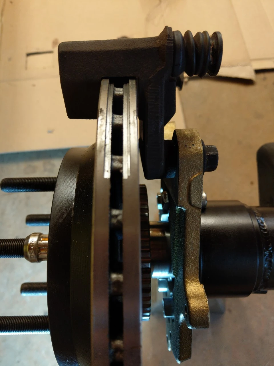

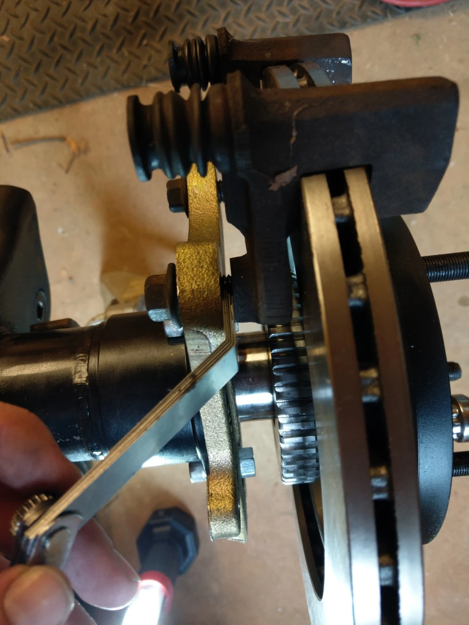

Yes, it's the finished product. So far I think I have several $ hundred flushed down the toilet. I'll update the write up when it's driving again. I don't want anyone to lose as much money as I have on this project. Stupid things like buying a forward brace kit from UPR, only to find out it doesn't clear standard tail pipes. Also, Moser Engineering might have a good product, but not a very refined one; The brakes were 12/100ths off on one side, and 14/100ths off on the other side. So you can pretty much count on having to shim the brakes to fit. By the way, shimming the brakes is a relative term. Technically Fastenal can get bolt shims out of Inidiana in about a week; in Imperial, not metric. If it's any help, the M12 flat washers from Home Depot are right about 12/100ths, and their lock washers are right about 14/100ths.
