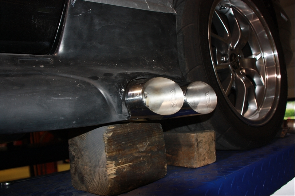

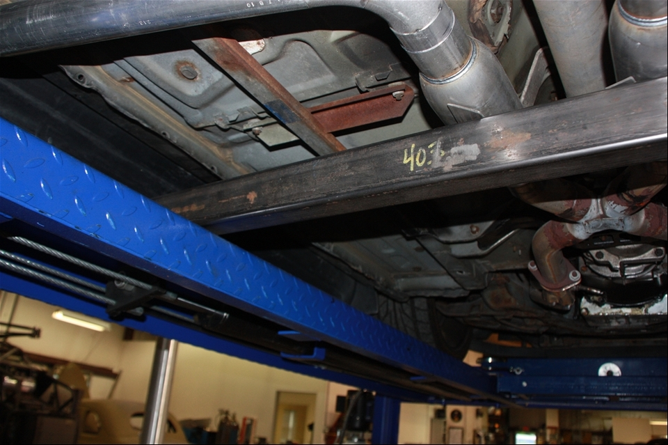

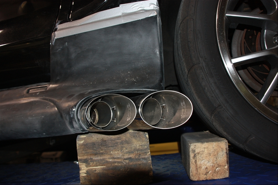

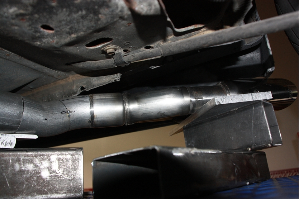

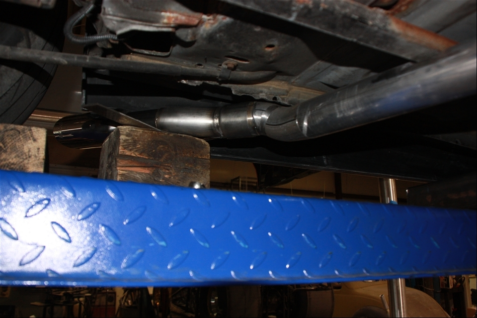

Dropped off the stang to get the side exhaust made. I ended up going with Dynomax race bullets for the mufflers. It was either that or the magnaflows, but after talking to them, they said they would be about the same db level and they were larger. Besides the fact that the dynomaxes were cheaper.
Little more expensive than I had wanted to pay for it but in the end I think i'll be happy. It's getting finished today so hopefully tomorrow I can stop by and hear it and take it for a spin.

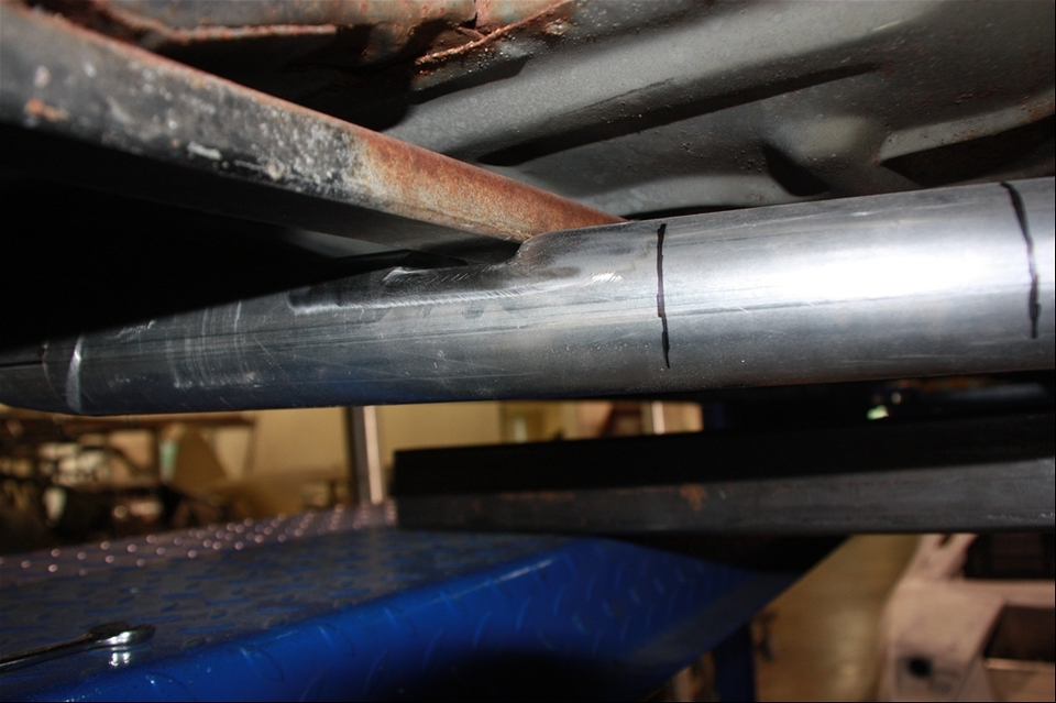

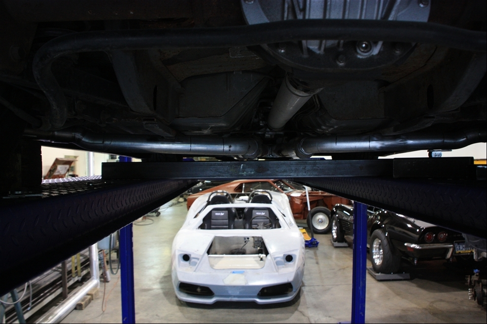

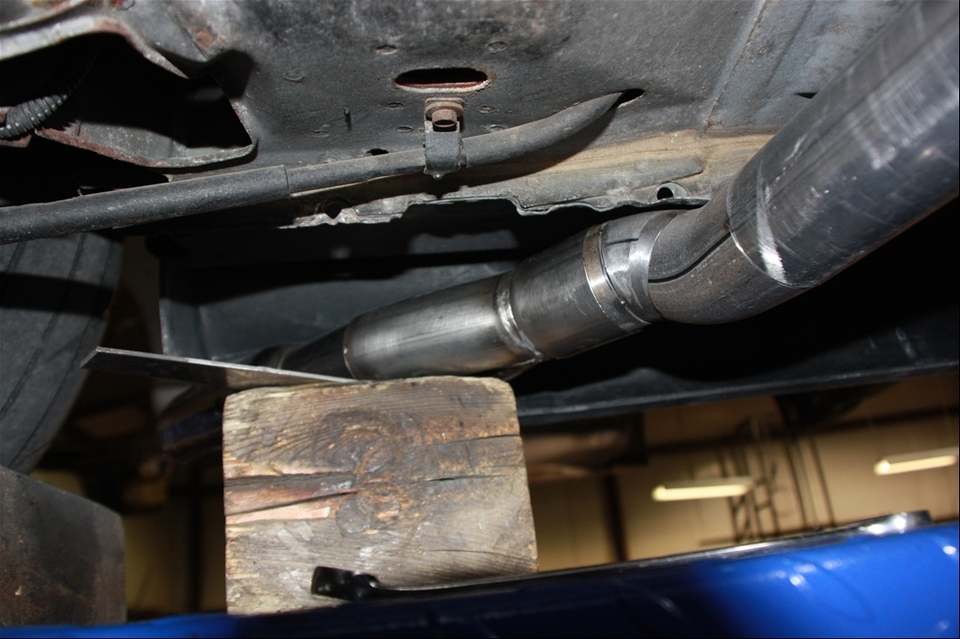

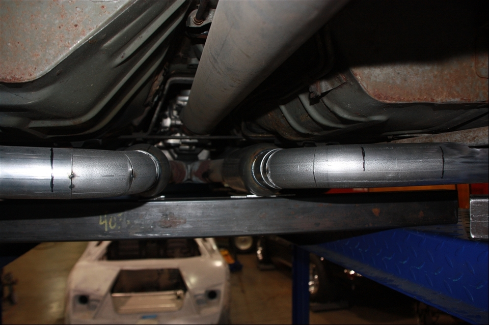

Everything is just tac welded up right now so its not the final fitments. Onto the pics:

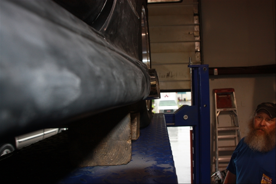

Clearance is about a half inch lower than the rear sway bar. Its hard to really see how it is in that last pic as its a bit too dark but looking at it, it looks like it shouldn't be a problem.

I'm probably going to have my exhaust redone later this summer sometime. I need to pick up a new pair of Stingers or at least do some tigging on the bottom to repair them (they've drug over a few too many things and aren't looking too great anymore) and I'd like to do subframes. I like the notch they incorporated into yours, I'll probably steal that idea :D
I'm interested to see how loud it is with those bullets. A local guy had a setup fabbed up using Loudmouth 1's and it was too much for him, but I actually think bullets are more mild than LM1's, lol.

Update: couldn't get a video because it was in the shop and parked in. He was already working on the side skirts. I was able to start it up and it sounds mean. my allergies are in full swing and as such my ears are pretty closed up but still, it didn't seem that loud at idle. I revved it a bit to like 3k and it wasn't that bad. Should be done with the body work by the end of next week but most likely it will be sooner.
Hollywood: Not really photo worthy at the moment, its covered in body filler dust and the side skirts are duct taped on.
