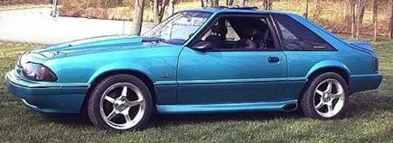

Thundercoater, I'd be curious to see what this "kit" is you speak of, I'm guessing you are not talking about side pipes but an exhaust exit forward of the rear tires?? I can't tell for sure but your sig pic looks like a GT and a side exit may be more work than it's worth with having to modify the skirts, would be easier on an LX, my $.02. BTW, where are you in Maine? I'm in Westbrook...
Hey REV - I am in Hollis not far at all; I just moved here about a year n half ago.

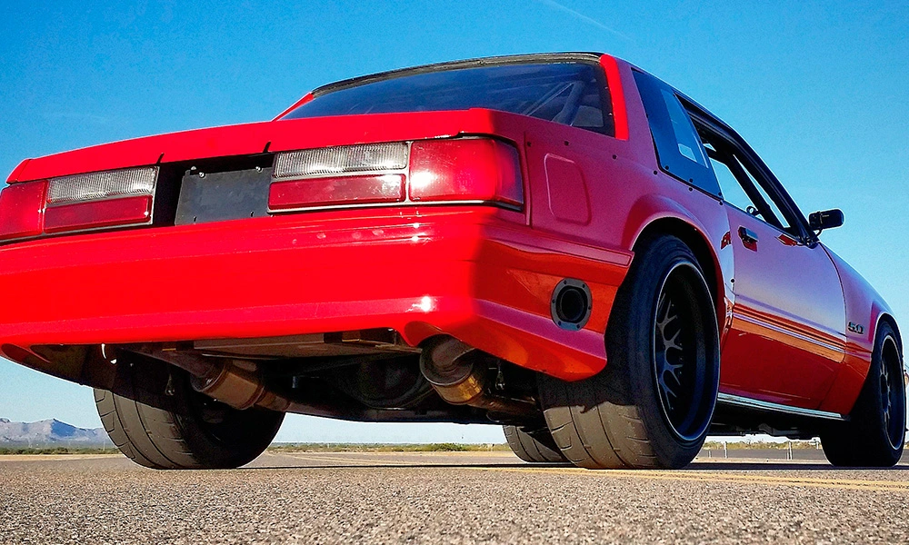

hey man new to stang net but not to mustangs. I currently have a side exhaust setup on my notch. It consists of bbk longtubes going into a mack pro chamber x pipe and then race bullets and out below torque boxes with dual tips on each side. It is loud not to bad in car or with windows open it turns heads like you couldint imagine and gives the car a very unique sound. If interested I can maybe get you pics of the setup so you can see how it is done. Since im pulling it off to rebuild motor anyway.

The problem with that is now you have a saleen front, different side skirts and either nothing in the rear, a saleen rear valence or a GT bumper.
Lx's with no tailpipes just look wrong, the gt rear won't look right with the saleen front and side exhaust skirts and a saleen rear valence with no tailpipes just looks stupid since there are slots for it.
No matter how you slice it, it doesn't look light and it will be mismatched.
