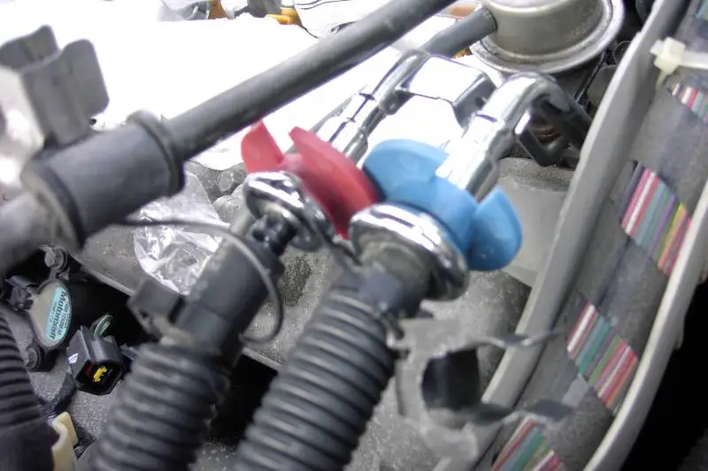

You'll need to pickup a set of fuel line disconnect tools from the local parts store. The set for your car, should look like these:
Bleed off fuel pressure from the schrader valve first!
Insert the tool into the disconnect. While pushing the tool IN you must pull the fuel connector APART.
May be a good idea to soak the connections with WD40 or Liquid Wrench. Another pair of hands can make it a ton easier as well.
