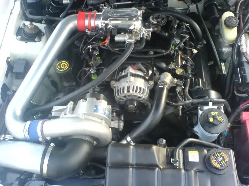

Bumping this old thread instead of starting a redundant 2nd one.
First time cleaning the engine today. Used 50/50 Simple Green and warm water. Put in a spray bottle and sprayed down everything avoiding the alternator and battery terminals. Let sit for about 3 minutes and then ragged everything down as my power washer is at the beach house. Doh!
After I was done with that, I used tire shine on all the rubber and plastic to get a nice shine to it.
Picture does the black no justice. Didn't have my digi cam on hand so I was stuck using my cell cam.
Thanks to this thread for all the good advice. :nice:
*EDIT* the washer top looks like butt because I missed it pre-picture. It has since been cleaned. :nice:
