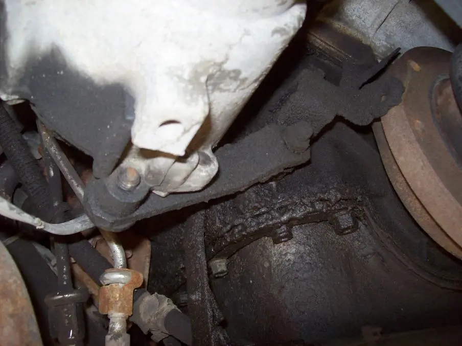

Does anyone have a picture of the smog pump bracket for the bottom part? Im going back together and kinda forgot what it looked like and all my stuff is kinda thrown together lol. Thanks

I just need to know what the bracket looks like that holds it to the block..lol

Well I tried to put pictures up, but evidently I don't quite know how. But I can tell you what the one on my 88 GT looks like it is basically straight around 6 inches long and bolts to the bottom of the smog pump and the hole on the other end goes to the bottom of bolt on the timing pointer. If this doesn't help if you give me your email address I think I can manage to email them.

Well I guess I did manage to get the picture in there, I'm better then I thought.

Aw well that would explain my problem lol I forgot it went to the timeing pointer, here I was trying to get it to go to that hole right on the block behind the pump, Thank you very much
