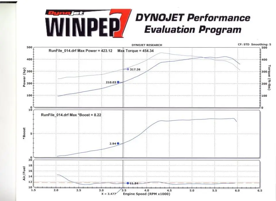

As for turbo I went with on3performance. I did upgrade my turbo to MpT70 and got pmas maf while I order my turbo kit.
I am making good power and only at 8.22 PSI I made 423rwhp and 454torque. Right now my gauge showes 8.5-9 psi so I should be well over 430rwhp.
