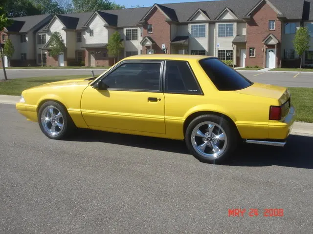

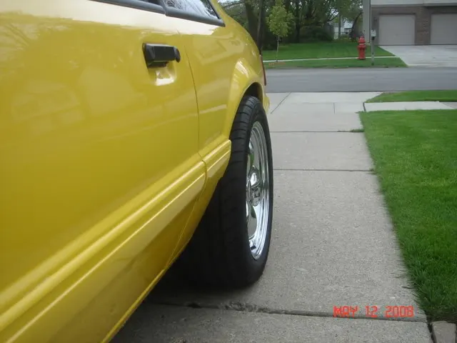

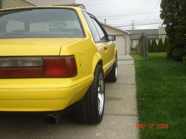

I have Steeda Sport Springs, P/N 8200 all the way around. Mega Bite Jr LCA's on the top mounting hole and two of their hard springs spacers between the springs and the spring perch. I also have stock shocks and struts.

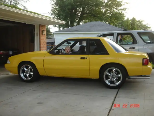

My nephew driving...hehe
I LOVE the way your rims sit flush with the fender... every rim in the world should sit like that!!!
Thank you! I like it too, and I actually have quiet a bit of room left in the well. I could widen the wheels about 1/2 or 3/4" to get more rim and tire under the car and maintaining the flush look on the outside. But our local guy is like 220 each to do that....:eek:

Yeah some 315s on yours would look killer :D. I just LOVE having wheels sit perfect it makes or breaks the car. Yours actually sit better than mine, in my opinion... I need like 1/8-1/4 spacer in the back...
Thanks 1990, yours will be there... :D
