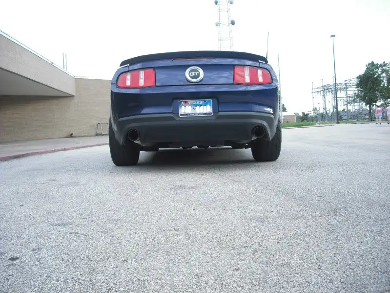

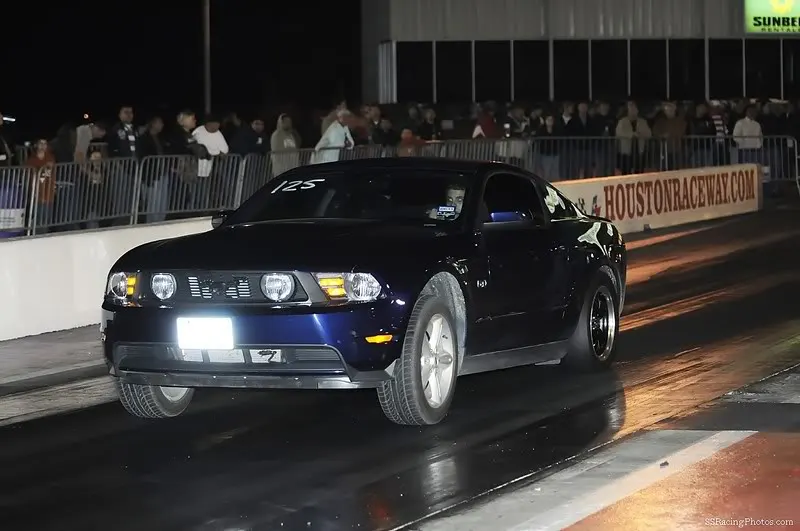

Bias ply are going to hook HARD at the track. You'll get a decent amount of sway on the top end with them and they aren't SAFE at all to drive on the street. I went that route for a long time.
The radials (as pictured) are able to be drove on while on the streets and hook well.

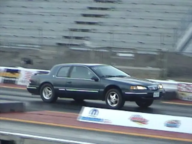

I used to dead hook everytime with 465lbs/ft on tap and a front heavy Mercury Cougar at the track. :nice:
...and that picture was taken back when my car still had an open diff. :shock:
