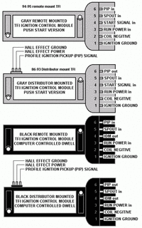

So there is a article on here that explains about the TFI and the difference. So apparently it’s a part classification error. From what This says there is no difference in the TFIs.
Here is the quote “Even though there are different TFI part numbers for automatic and manual transmission setups starting with 1990 Mustangs (Motorcraft part #'s DY174 for M/T and DY1076 for A/T).....they continued to use the "push-start" wiring setup until 1993 for both transmission setups. SN95's were the first Mustangs that used a different wiring configuration depending on the type of transmission, and had different color TFI modules as Hissin50 mentioned above.”
