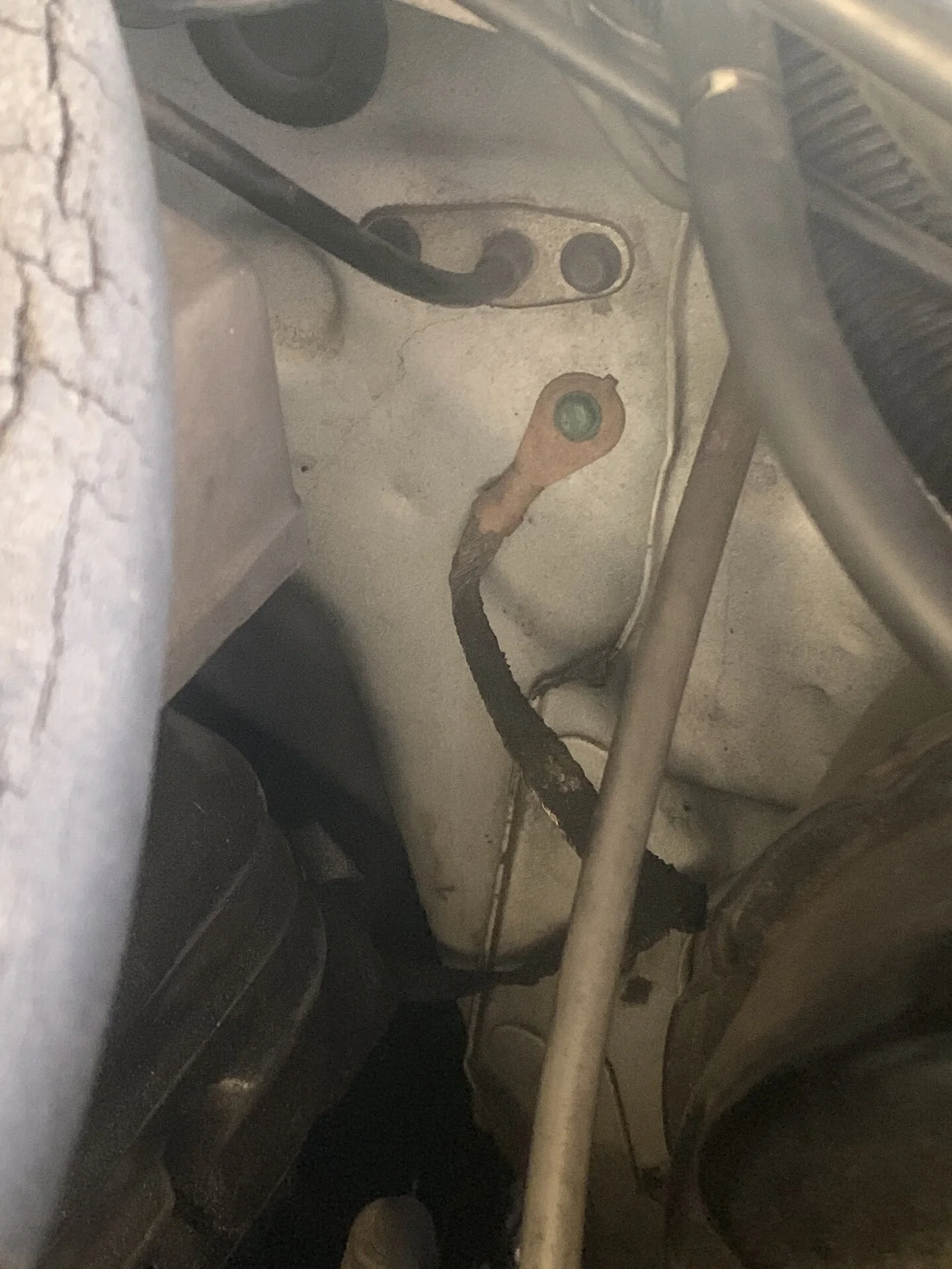

41 and 91 are left and right bank lean. The O2s are fairly new. The car did it before them to. Some one said check the ground on the 02s. I attached a pic of what I think the ground is. Maybe some one can chime in if that’s it.

That is just a chassis ground strap it does it actually ground directly to the O2 sensors let me do some looking at some schematics and I’ll let you know where the ground to the o2 goes and try to give you some information It will be Monday before I’m back at work in front of my computer I have everything on have you done any intake work recently and is the screen under your PCV clean I am getting down to the nitty-gritty on this problem I have been going at it pretty hard for the last week because it just irritates me I’ll try to remember to get the information Monday if you happen not to see a post or something from me post a little something to remind me I’m horrible about forgetting things sometimes

Yea I need to find that ground and make sure it’s good and clean it. After looking through the forums ground issues with The 02 can cause the 41 and 91 code.
