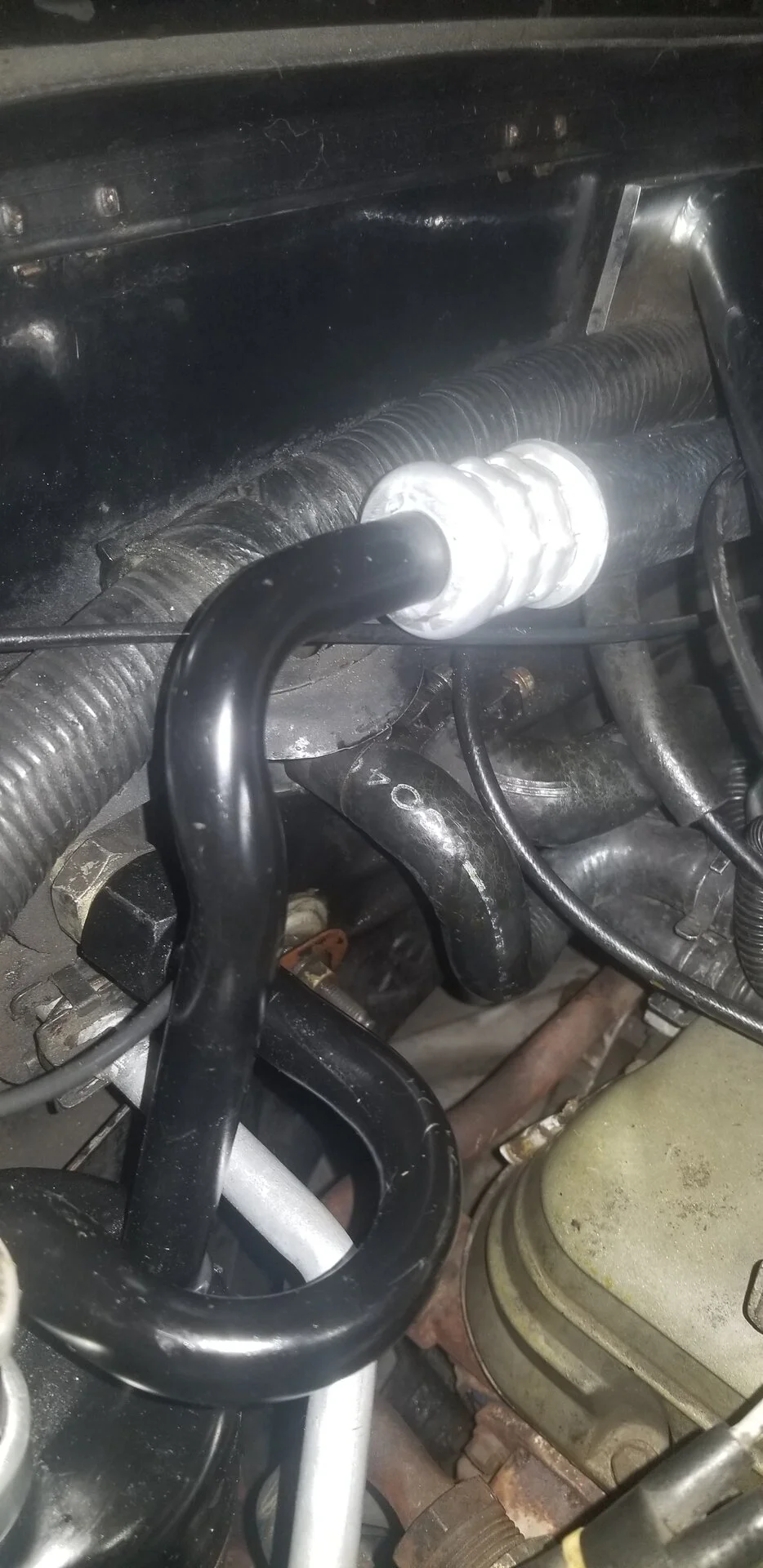

I replaced my heater core about 7-8 years ago with Lmr 's kit. Came with new core, foam seal,and hose restricter,hoses,and clamps.
Not an easy job, but it's nice having the heat work.

In the pic the hose clamp was loose on the heater core and the left side and was leaking down from there .

I have a hose removal tool, not this one, but like it.
