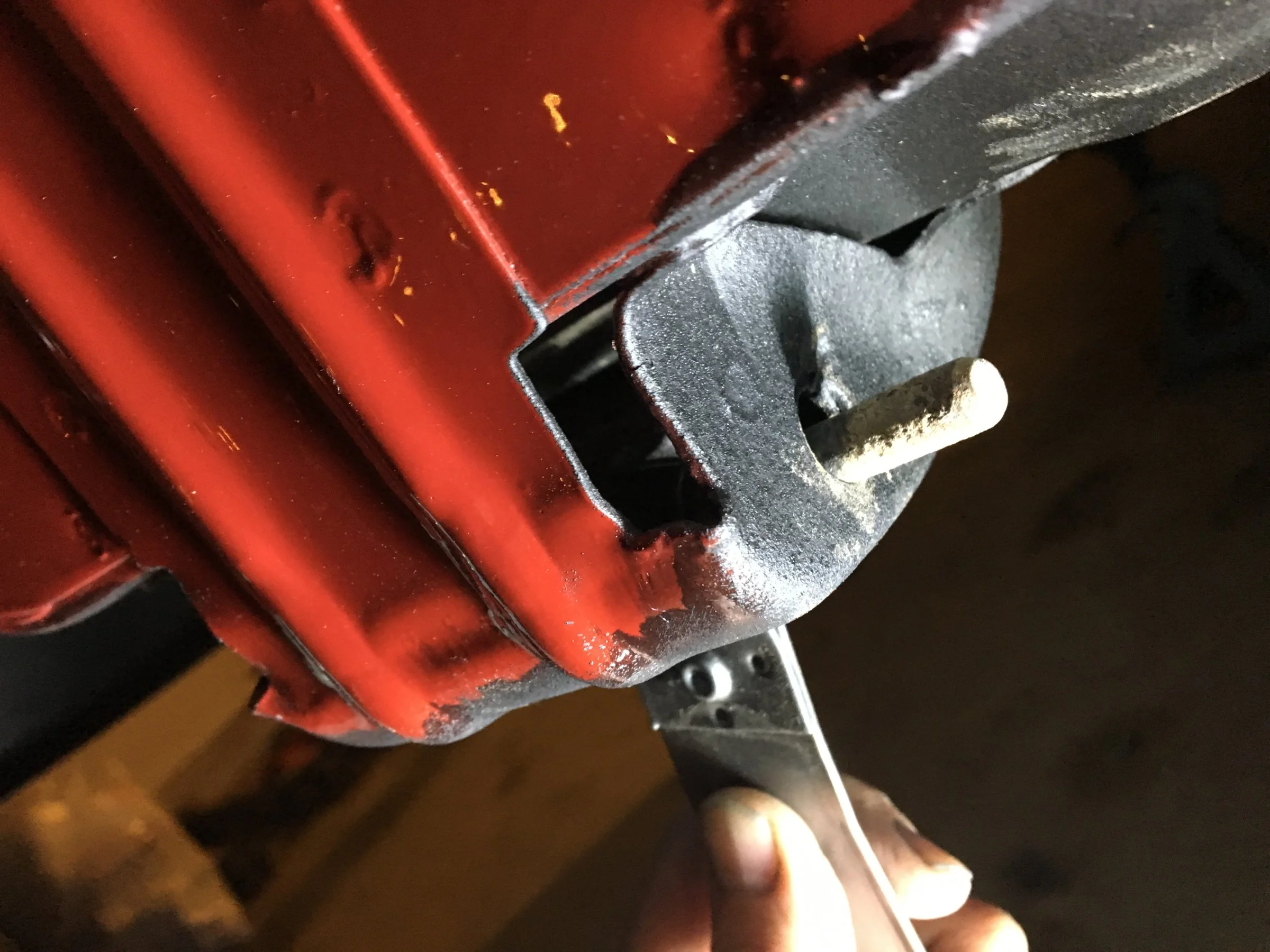

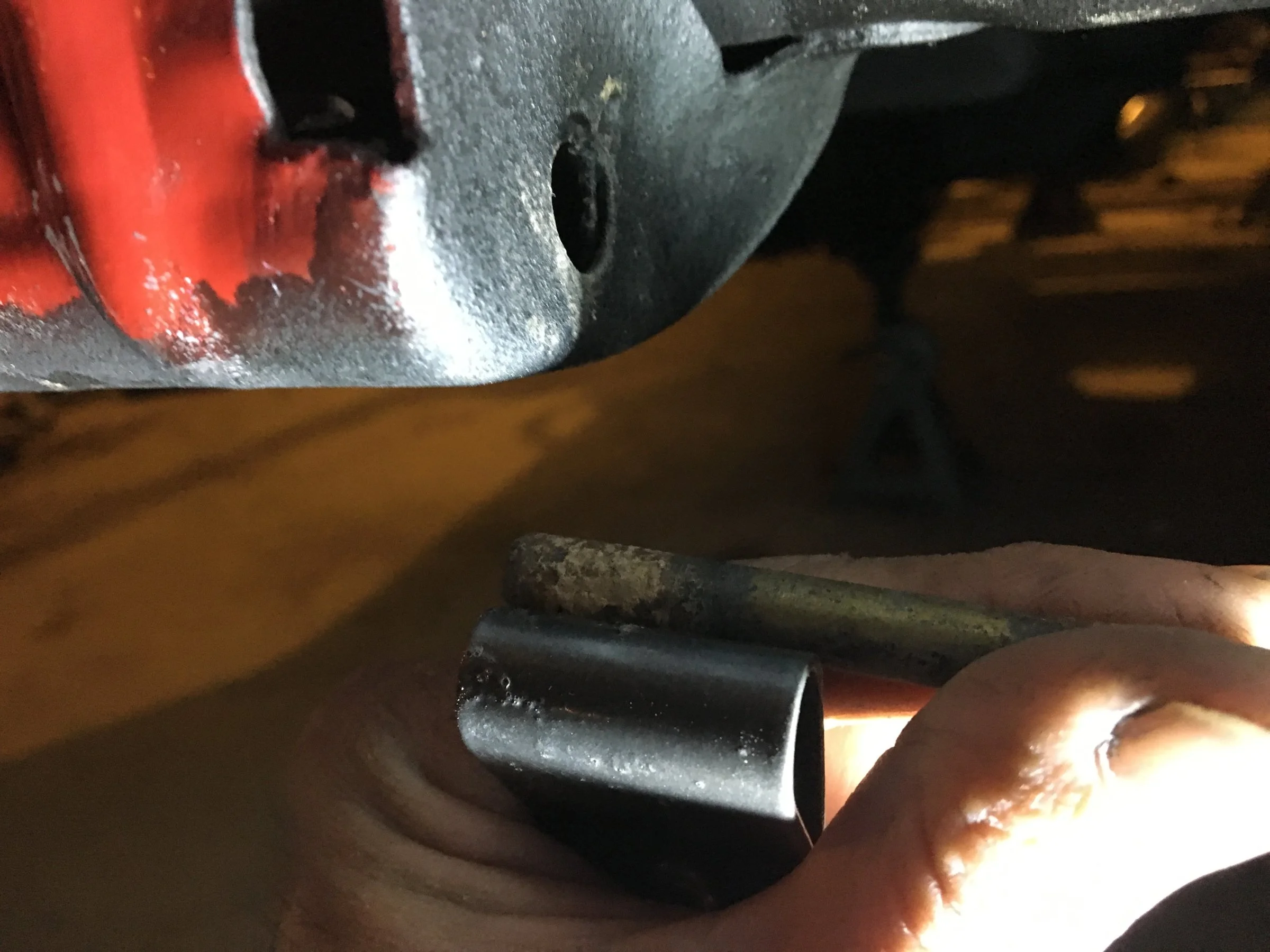

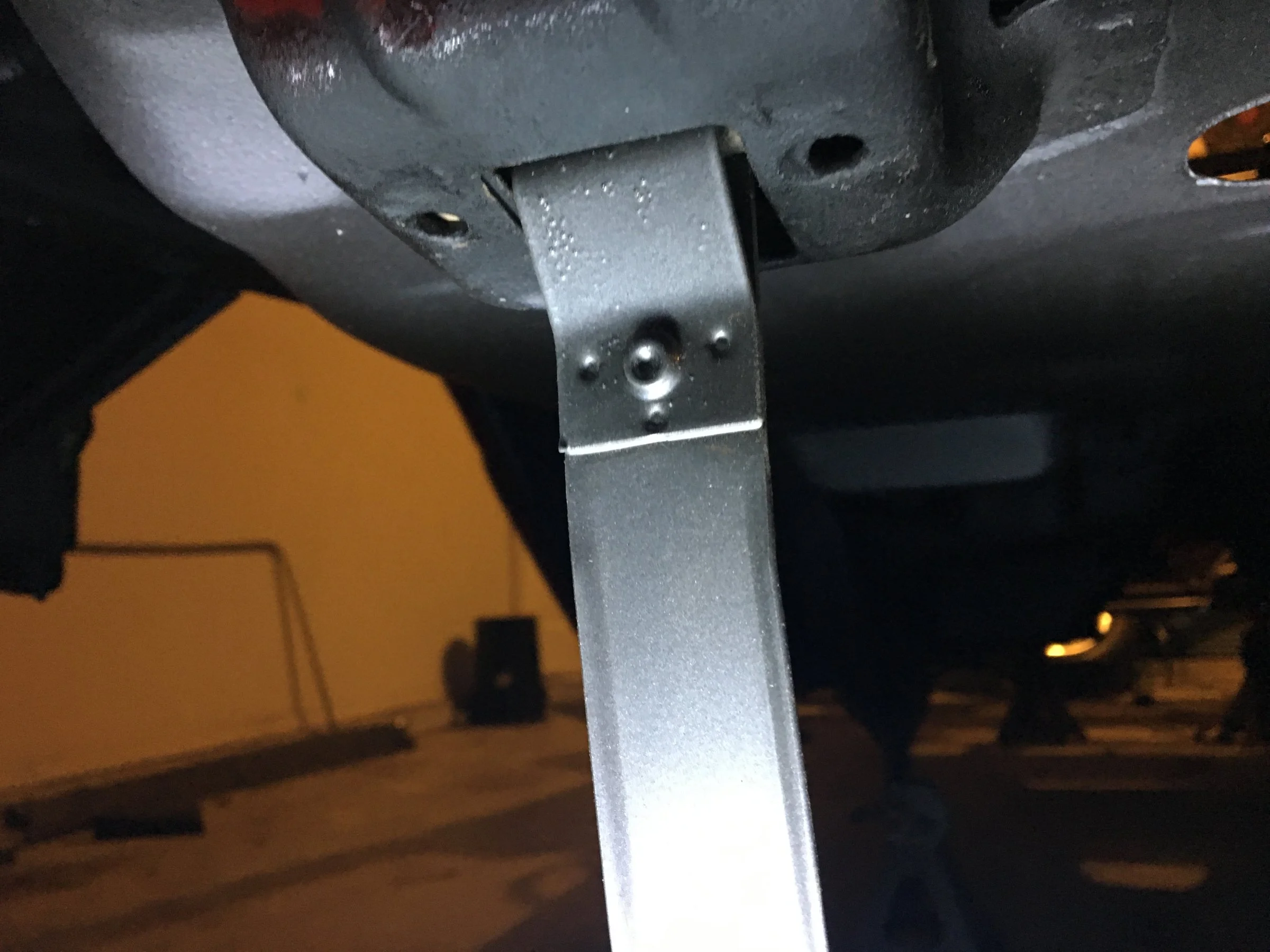

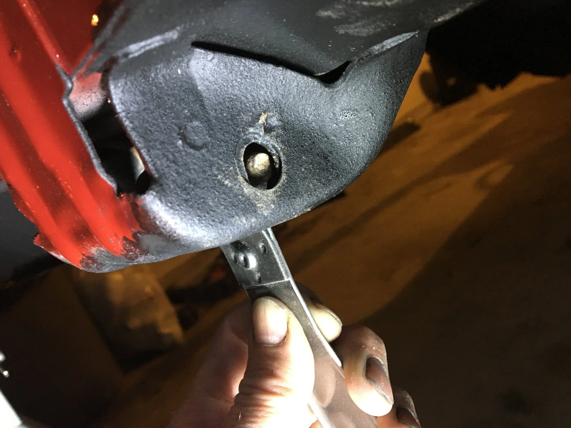

Ok, there is only one pin that is captured in the mount on the rear of the car, here are pictures of one of my straps that i mounted and then took back off. You just need to align the pin with the holes and use a punch or some such device to push the pin out from the mount. It secures itself in there, even though it sounds simple and might fall out on its own, it won't. Clever design on ford's part.
