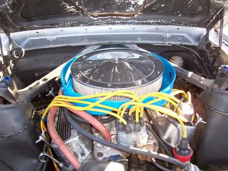

I modified a stock air cleaner base by removing the snorkel, blocking it with a home made delete plate amd drilling three 1/4" drain holes. Works well with scoop.

I too have basically no room between my carb and hood, but was able to fit a k&n 14x3 with a drop base.

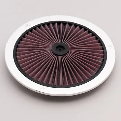

Be sure that with whatever you get, it flows enough to keep up with your motor. The one thing I hate seeing is a guy with a 1050 dominator, and yet he's running one of those foam Edelbrock air cleaners on his show car. They don't flow enough to keep up with the motor, so you're trying to basically breathe through a straw... it doesnt work.
My suggestion would be a drop intake 14 inch, with an open top as shown above. Make sure it is big enough to flow that which your motor demands.
