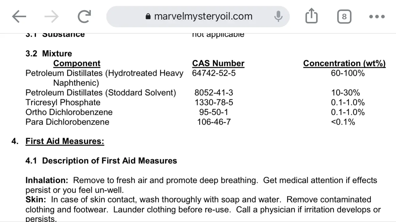

So why MMO and oil?
I just took the Mystery out of MMO and think it might not be on the market (in at least CA) for long without a major formula change. Please use gloves.
It is mostly a light, cancer causing oil, and some dry cleaning safety solvent that is also carcinogenic. I think a different fogging oil is a good idea. That’s too bad.

So why MMO and oil?

I was trying to ask - Do you think it will help dissolve the rubber piece or grab it get spit out with the extra oil?
I know some of the solvents in B-12 chem tool are hard on rubber and plastic in full concentration, (Their plastic bottles got brittle if stock was not rotated), and was wondering if MMO was, too. I do not think the pumped up lighter fluid would be too quick to dissolve rubber, but I do not know the effects of Stoddard solvent on rubber.
