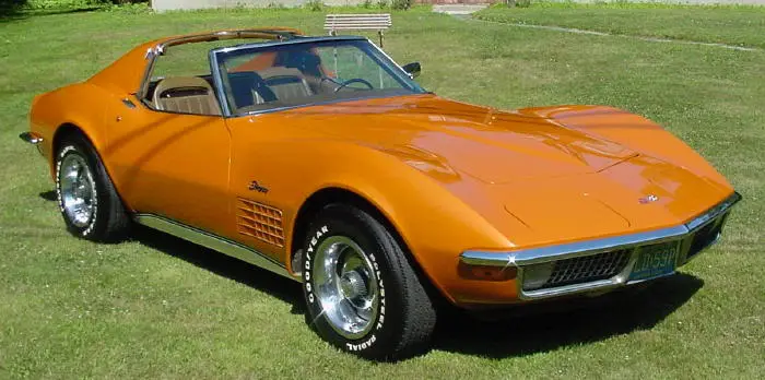

http://forums.corvetteforum.com/photopost/direct_data/1068/11739August_13_2005_007.jpg
Thanks again, Len.
Hey that vette is kinda sharp...i dont usually like many vettes but the 68-82 are some of my favorites, except maybe the 73-77 era...whats yours?...71/72?

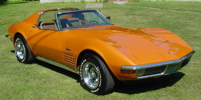

I ride around in this sometimes myself...
That's a nice vette quik91lx. Mine is a '70. It was barely driveable when I brought her home in 2000. It was originally an L-46 car (350-350) but all the good parts were already gone.
I built/blueprinted an old 454 engine to a little hotter specs than a 70 chevelle LS-6. I have a 4.11 posi rear waiting to go in. That's why my stang is my fair weather DD.
:SNSign:
Here's my site: http://www.corvetteforum.net/c3/themoneypit/ but it hasn't been updated in a while as the original site was free and then they decided they weren't going to support personal web pages anylonger. It's still viewable but I can't edit anything.
