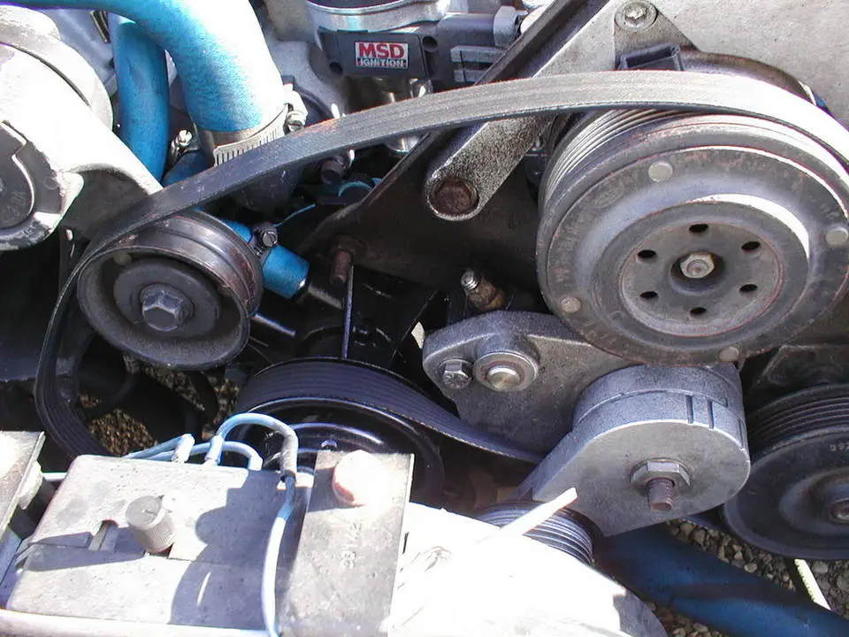

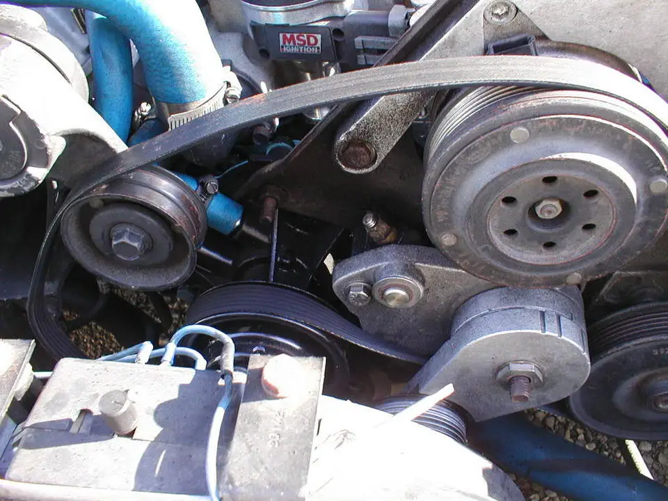

Here my problem, I got my car with the smog pump already gone, the guy just ran a shorter belt. Now every belt lasts me about 2 weeks then it starts rubbing together and then breaks. Does anyone make a smog pump delete that I don't need the stock bracket and hardware to use?
89 5.0 w AC
795.0 just helped me with this a couple days ago. works better. had the same prob before. you'll probably need about 1" longer belt.
Hey Bloop n Dave so I could run it like I drew it with a 72 inch belt? I didn't see powersteering on your drawing Bloop. Am I to assume you put the p/s where the a/c pump was? If so could I run mine with the p/s pump where it belongs? Thanks a ton sorry to TJ.
i only edited the drawing to show the belt route. yeah the ps pump moves to where the ac was. i dont think your drawing would work i think the water pump gets in the way. thats why you need a delete kit. 72'' is with UD pullies. they change the belt length.
ok guys here my problem, rerouting the belt isn't an option due to my S/C tensioner getting in the way
what are my options here?
