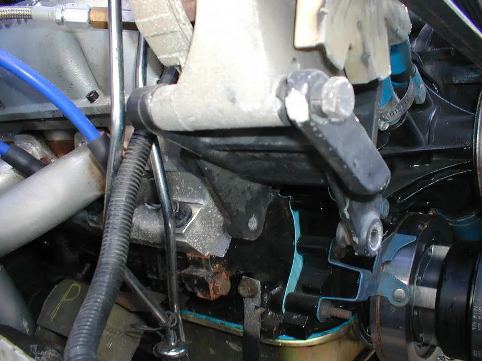

no one can tell me if all of the smog pump bracket is there?
865.0
Feb 23, 2006
24
Apr 14, 2007
#26
  • Apr 14, 2007
  • #26
I think that's all of it.
I just went out looking at my car and can't find anything much different. Although I have a different setup (different supercharger) than you. I have all the original stuff..smog pump...AC...etc. I took a few pic's but I don' t think they would be much help to you.
On my car I have a bracket connecting the alternator to the Smog Pump. Maybe yours had a similar setup and that's what your missing.
Sorry I couldn't be of more help
