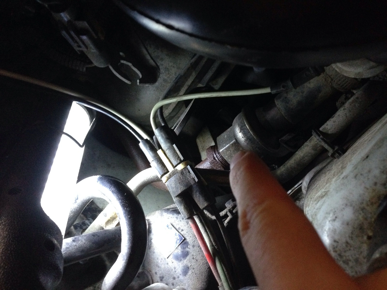

So I know most people buy the thermactor plugs but I'm looking at and wonder why people just don't cap it where the check valve screws on on the top hose. They have to make a cap that fits those thread sizes I would think. In other words, the hard tube would still run to the back of the head but the check valves and things would be gone. Is that possible and has anyone done it. Seems like it was be way easier to do that.

That's how i previously did mine. I wanted to remove the hard tube at a later date when i pulled the engine so i could install the threaded plugs.
Fortunately, that method allowed me to easily reverse what I had done when i reinstalled all my smog equipment a few years ago.
Do you happen to know the thread size of that thing by chance. I was going to look for a plug or just put a large bolt in the tubing and hose clamp it. I screw on cap would look cleaner and faster but in sure either would work. Once day when I get froggy and need the motor pulled and rebuilt I pull it then. Or when I swap heads.

I clamped an acorn lug nut into a piece of the smog pump hose and I'm done with it. Not looking to be a show car under the hood anyway. On the other hand, I'm very particular about it running just right. I'm good in that department so far.
