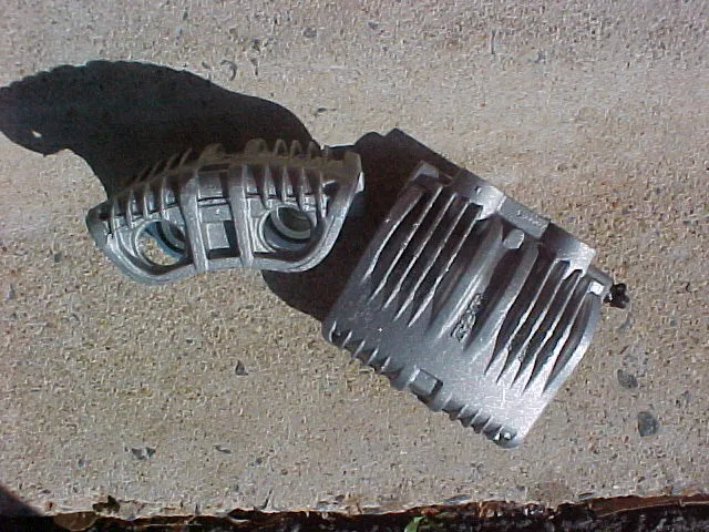

They have unique calipers and the spindles are F3 spindles which only appeared on the R (and only 107 sets exist so good luck getting a set). I beleive the redesigned F4 spindles in 1994 featured a provision for ABS and a dust shield....but are the same otherwise. There is an F5 spindle, but unsure what the differences are. I actually have an F4 spindle on one side and an F5 spindle on the other in my car.
But for all intents and purposes they are the same
These are the unique calipers
