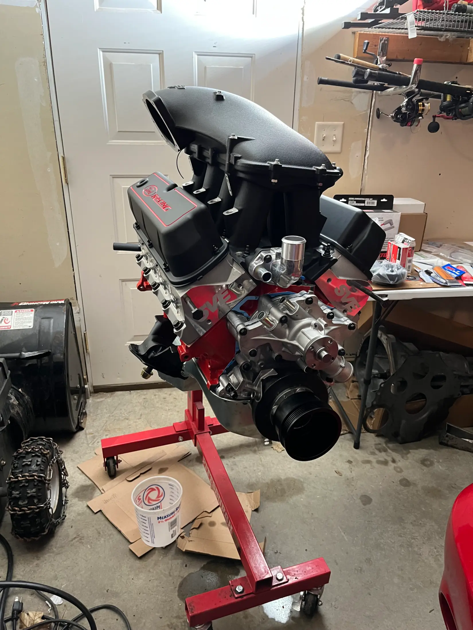

Hey everyone, I posted a little while ago about finishing up my first engine build, a 331 NA stroker. Now I need to feed the beast. I’m going to run 42# injectors, I still have the OEM tank/pump/lines etc. I want to be able to run E85. What types of systems are you guys running? I’ve looked at Evil Energy, but they have mixed reviews, trying to get a quality system. Thanks!
