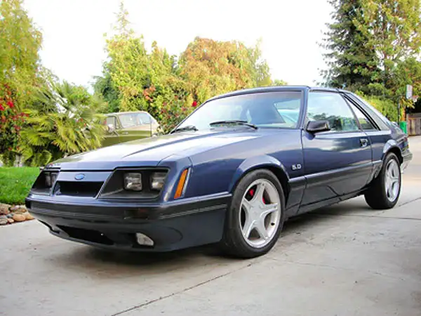

I did it on my 85. Tho I was able to use the rotors, calipers, and wheels off my 2000 GT. (Did a Cobra brake conversion and got Cobra wheels) I also got a master cylinder from a 85 Lincoln Town Car. It has a larger bore/piston to help squeeze the 2 piston calipers. Tho I stayed with drums rear. You should be able to find wheels, lots of people upgrade their stock ones. I got the spindles, hubs, axle shafts and drums out of a junkyard to help keep cost at a minimum. It helped braking alot, looks good and in my opinion well worth it. And in the future I could upgrade to 13" rotors and bigger calipers. At the same time I swapped in some C springs and KYB shocks. Since I was under the car I also welded in some subframe connectors. Just need to get my 3.73's installed. So after I install a strut tower brace I'll have a rigid chassis, good suspension, and stopping power to handle the power upgrades. So in short... Go for it!!!
