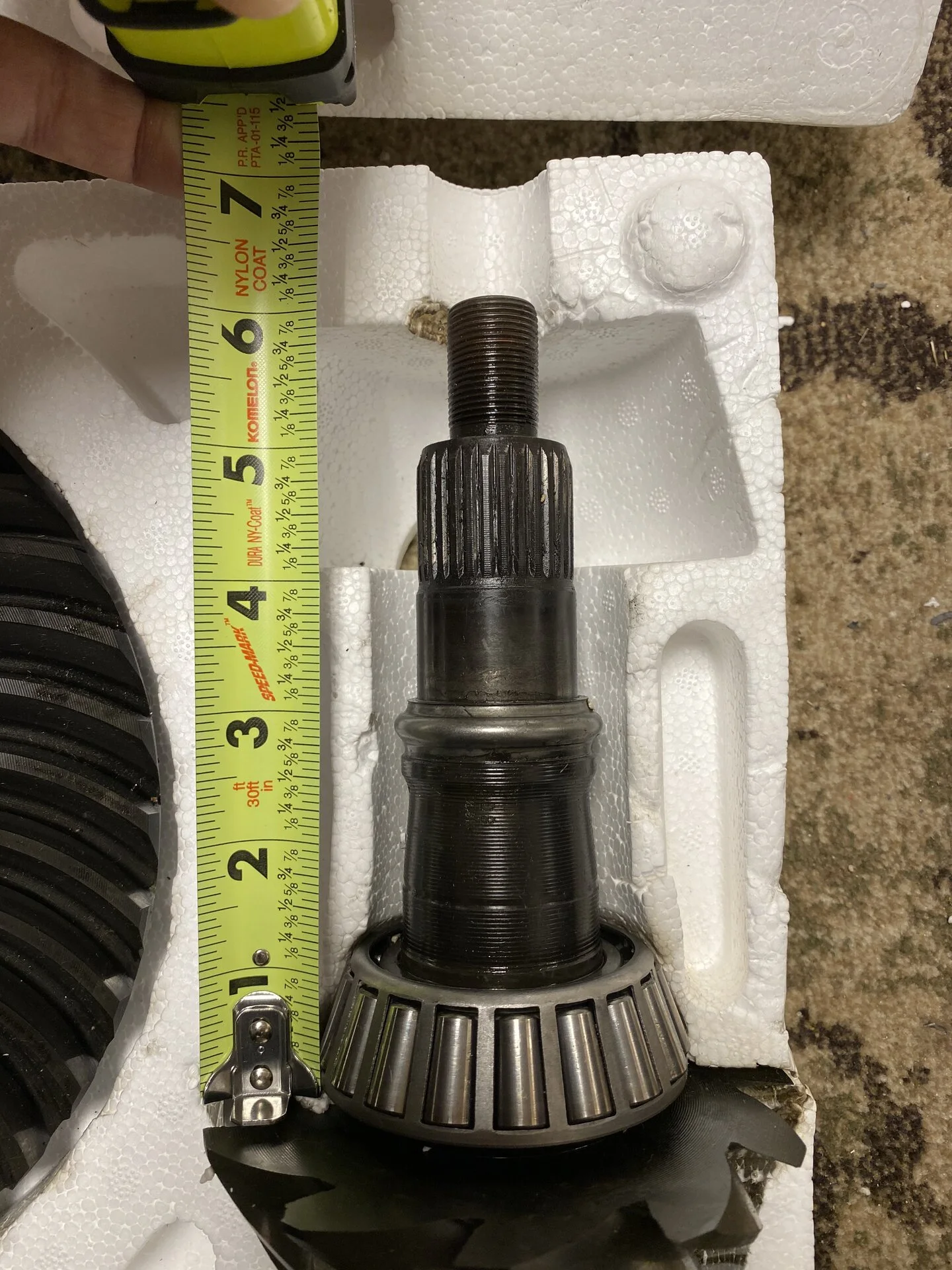

I ordered a new set of 3:55 gears for the SN95 GT. Listed part number was M-4209-88355. when they arrived the new set was much larger and wont fit. Can anyone tell me what I have. To my knowledge the rear axle is original and other 8.8 parts I have bought fit. Got another set coming but not so sure they are correct.

Those are the correct 3.55 8.8 ring gear and pinion.
honestly, it’s your existing gearset that looks wrong. You sure you don’t have a 7.5” rear?

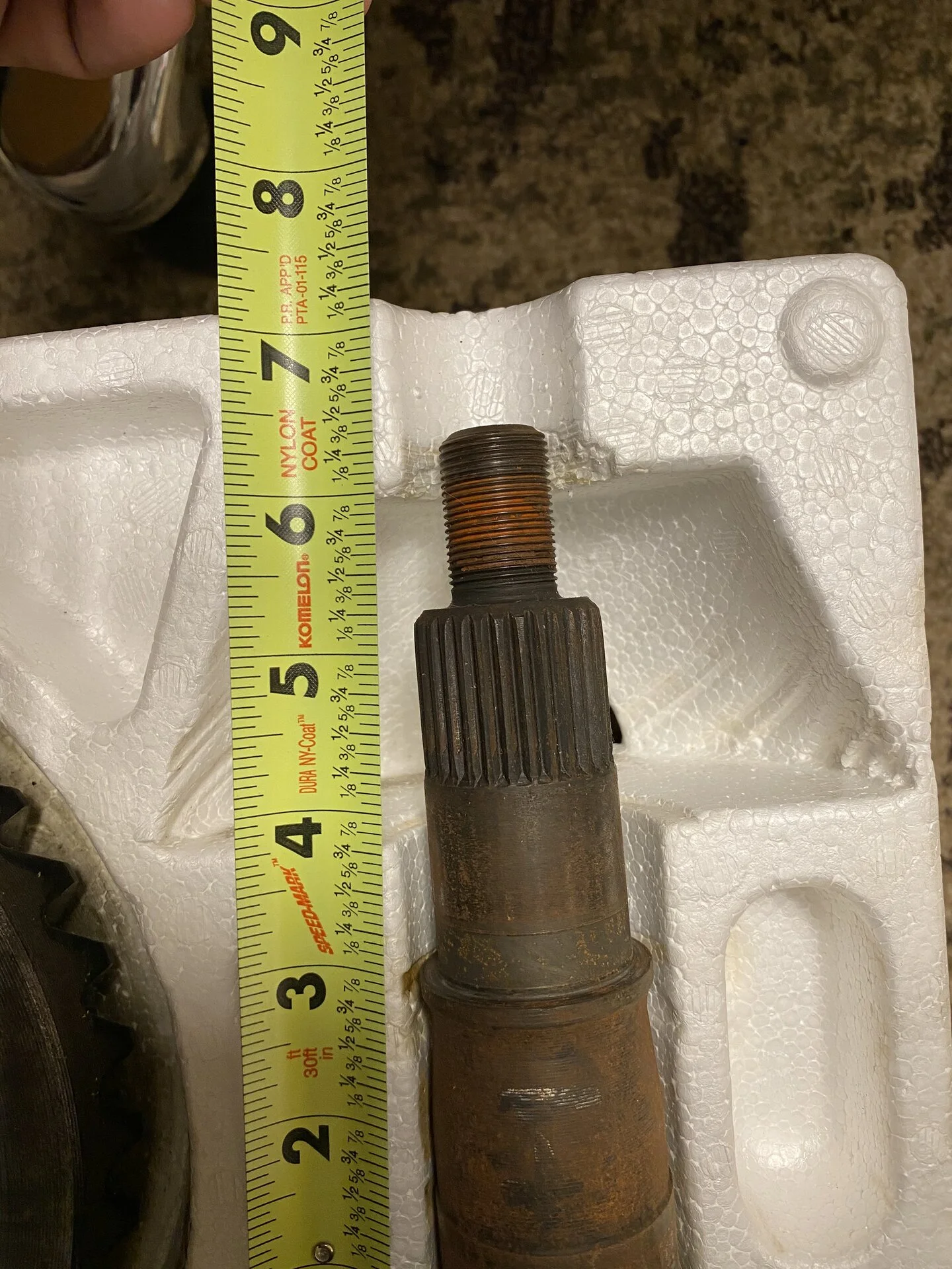

What is the lenght of your pinion? I have one I can measure in a bit and at least let you know what the proper length should be.
In the future, if you click on the pictures you attach to can add them directly into the post. That makes them much larger and clearer and easier to see. I’m just having trouble looking at your pics to ID as they are a little small and blurry.
Since it appears your pinions are dramatically different in lenght, maybe this will help. You can measure against what you have.
I had a few sets of gears so I measured a couple. I measured from bottom face of pinion gear to end of threads
3.27’s were 6 1/8” or so
2.73’s were about 2 1/4” long
