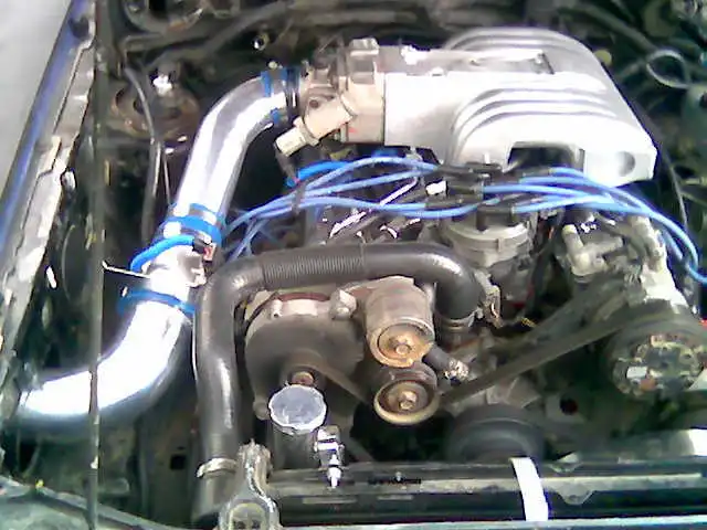

I have one and it is bolt and go except for the flange. You need a 4 bolt to slip flange adapter or have the flange machined off and sized for the slip on duct. Both ways will produce excellent results. Do a search and you will find the post on having the flange machined off.
As you see in the picture, the stock air box works fine.

ive got to change mine. didnt have time to fab anything up. i ordered the cold air for a sn95 so id have the flange, but they sent me one for a 86-93. sorry the pic sux, took it with my phone

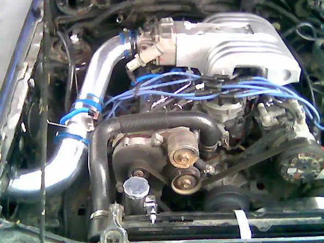

index.php
Thanks, that looks great!
