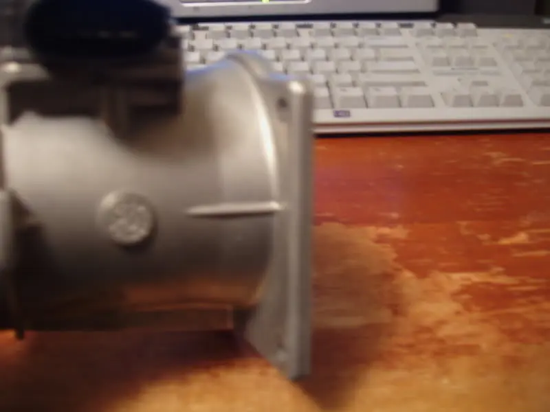

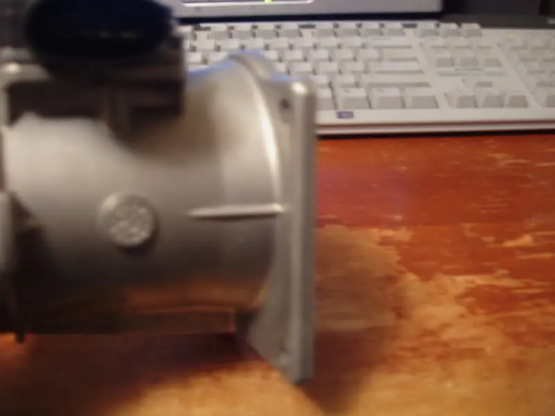

Well i snagged a mass air sensor off a 94gt from ebay. I was orginally going to have the flange cut off but there is a slight lip or angled part right behind the flange. Im not sure if the CAI and clamp would still seal properly. Pics so you can see exactly what i mean:

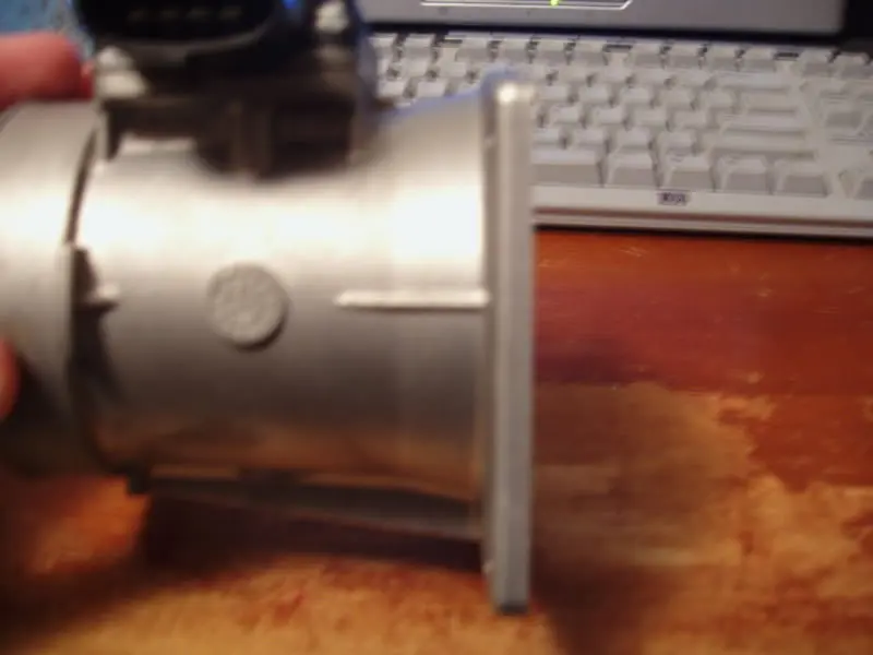

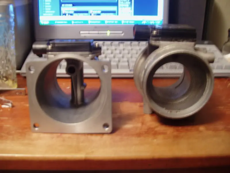

And stock vs 94 just to show the opening difference for anyone considering doing this. (stock is on right)
