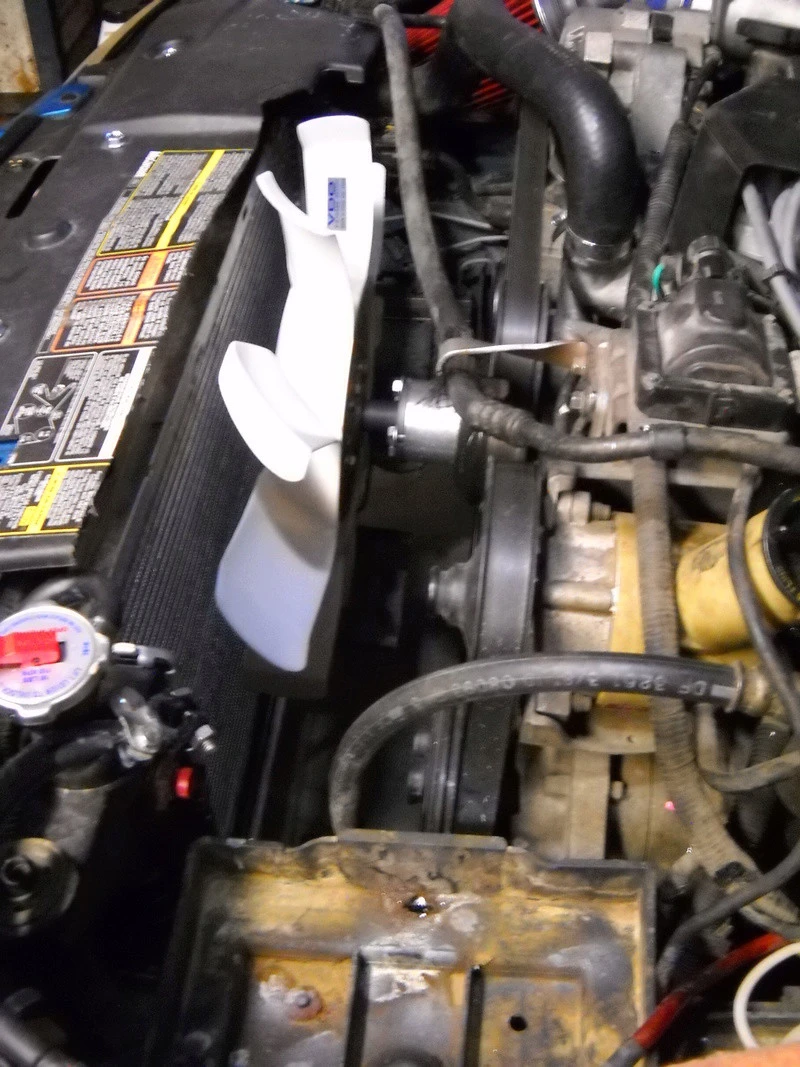

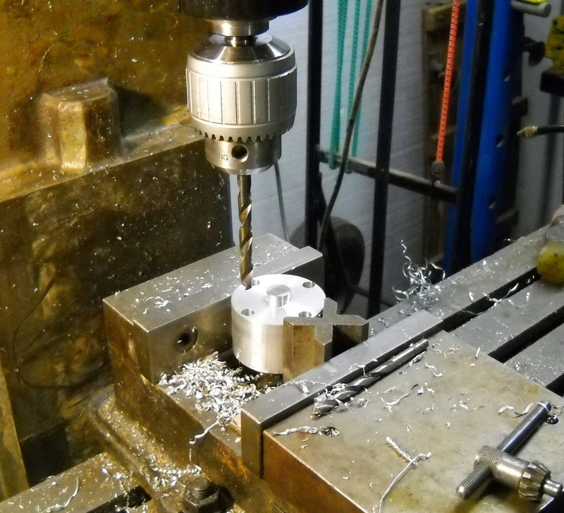

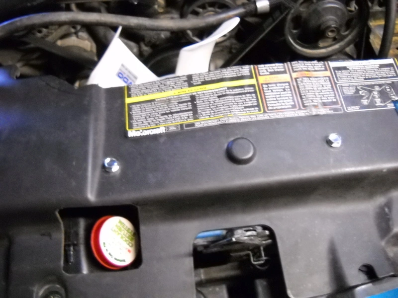

Anyway, I bought a Fox fan and clutch, made up the adaptor to mount it on the SN95 water pump, which has a larger pilot and bolt spacing, yanked out the ridiculous "catch bottle" Ford used (almost 2 feet high!), fan, big bracket, CCRM relocated to fender apron by MAF, and moved the Freon hose out of the way by fabricating a bracket.
Here's the adaptor/spacer being made up:

The big plastic huffer in place:
The new, smaller catch bottle tucked in front of the radiator. These SN95s have absolutely no room to mount anything the size of a half-gallon milk container!
Will I need a shroud? Drove it today to the P.O., 6 mile trip, 108 degrees out, gauge held quite steady at about 1/4 of the distance through the "normal" markings. Left it idling with AC on about 20 minutes after eng. had gotten hot, no change in gauge reading. 'Course, around here it gets over 120 degrees sometimes.....
So, we'll see! imp

That was the first consideration while doing the groundwork. With all the crap hung behind the radiator, it was a bit difficult to measure, but a 9" radius upwards from the waterpump centerline looked OK. Sure enough, the Fox fans are 18". It clears the underhood insulation mat by 3/4", which should be adequate until a mount breaks.....imp
