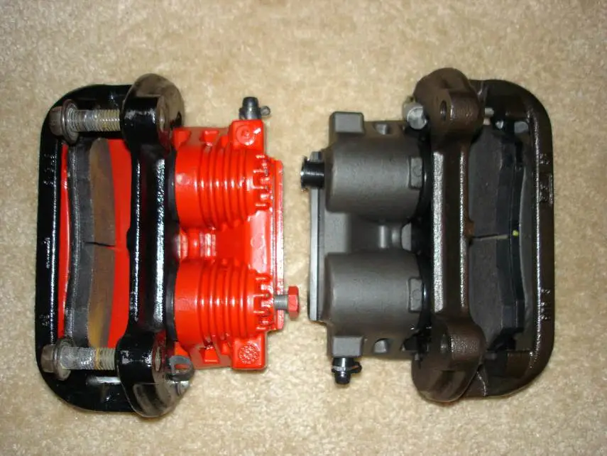

Here;s how you tell the difference.
Ribbed pistons on the left...94-98 38mm caliper
flat bores on the right....99+ 40mm caliper
There are also two different banjo bolt pitches. Coarse and fine. Don't worry so much about this until you have calipers in hand.

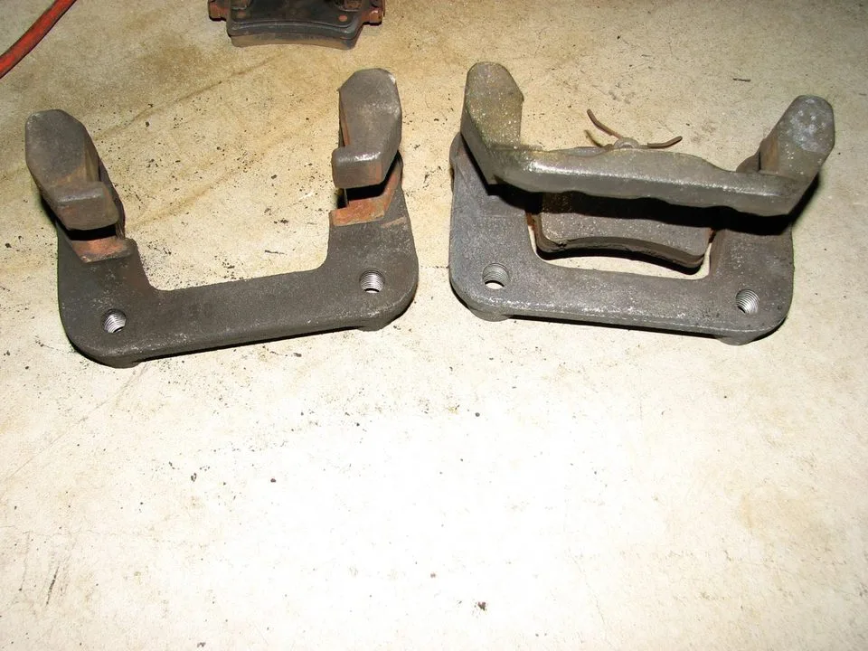

You would have to modify the rear brackets. The V6/GT rear calipers do not clear the Cobra rotors in the M-2300-M kit without modification.
Here's the bracket in question. The V6/Gt version is on the left. The rusty areas are where you would need to widen the channel.
And here's why. The channel needs to be widened to clear the thicker rear cobra rotor.
I stole the pics from this thread
