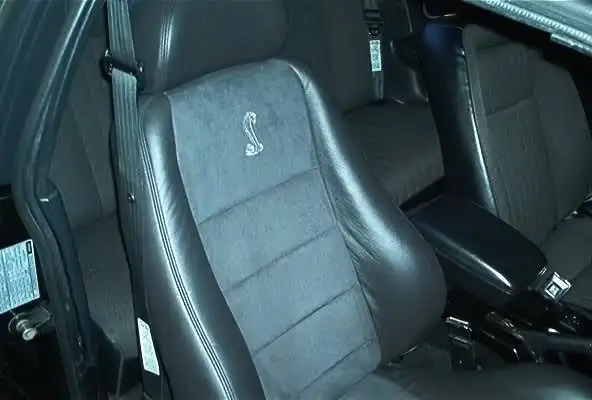

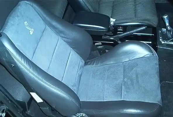

I put 2000 GT seats in my coupe. I used the power brackets that came with them and they bolt right up. Here are some pictures.

Wow, those look really good in there. Any issues with them fitting (hight, width etc)? Im guessing since their out of a 2000 then just about all year seat brackets should work. If you dont mind, how much did they both cost you with the track and everything?
Thanks.
I did not have any issues with them fitting. I am 6' 2" and weigh 220 and they were great! :nice:
The rears required some work to get them to fit though.
I bought the front and rears for $400 from a friend of mine.
