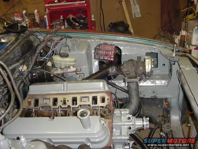

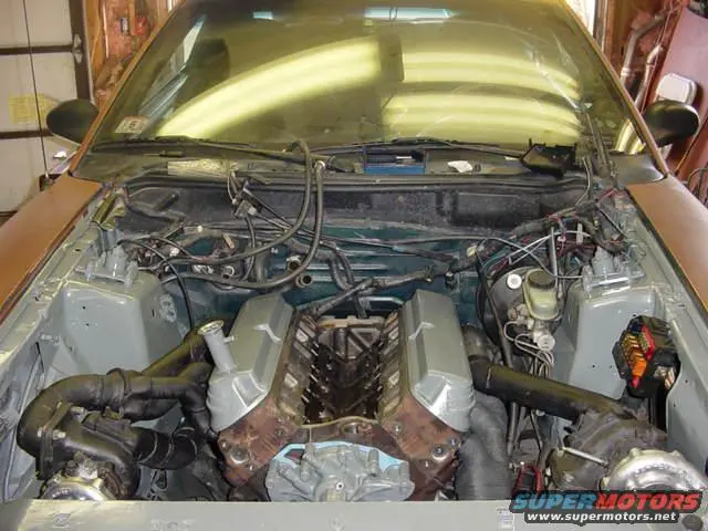

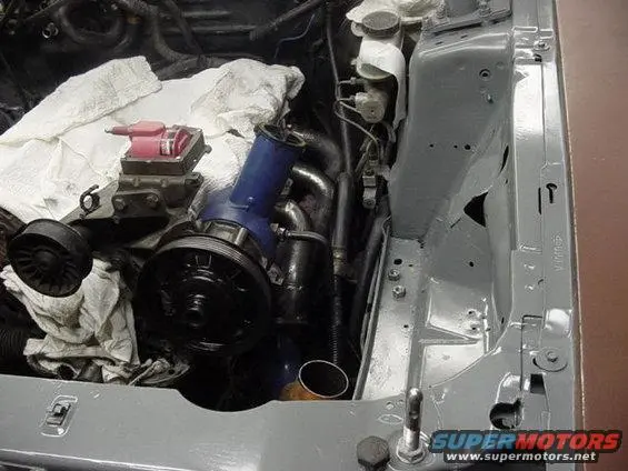

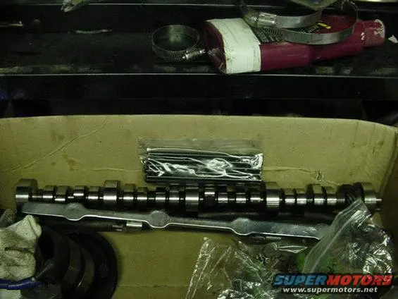

Anyhow, i Replaced the headgaskets and am installing a stock cam with my 1.7 rr's. The crane 2031 NA cam was causing extra lag and loosing power due to overlap. I plan on front mounting the turbos, moving my battery to the trunk, and the fusebox to the fender. I also painted my engine bay and Am hiding the wires, I also bondo'd some holes in the front Radiator support. Anyhow, enough talk- Here are some pics of my progress.

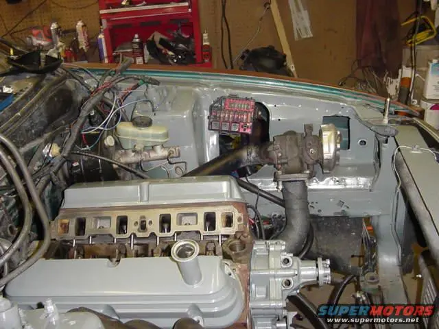

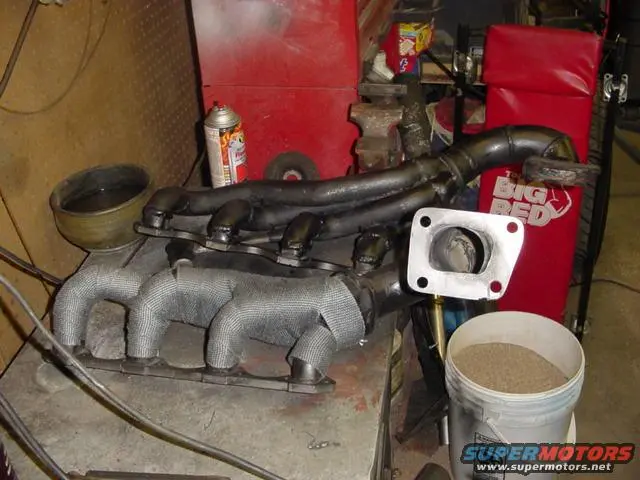

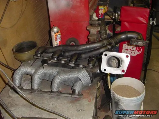

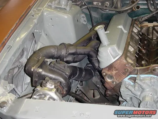

Today i Installed the heads with the new 9333-pt1 gaskets(coated with copper spray and torqued to 95 lbs with arp studs). I also finished the header flip with piping to the exhaust housing,...It will be wraped completely.

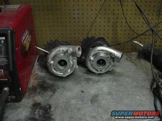

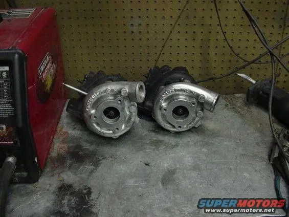

The Twins-Im contemplating fully polishing the housings
Header Build in progress(using old piping)

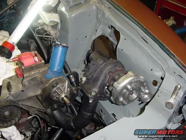

Header with turbo mounted

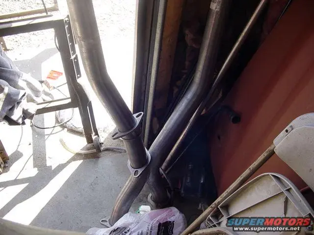

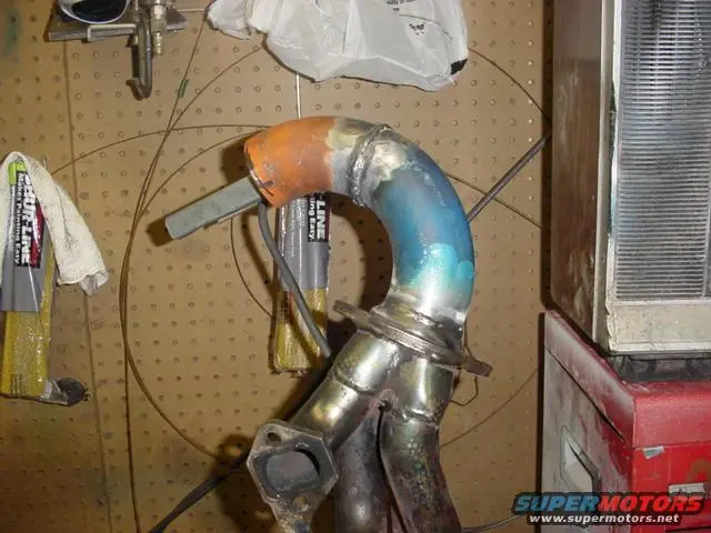

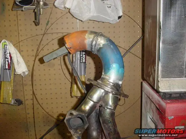

Ok guys, i finally finished my headers!...and what a abortion it is.....these headers have some CRAZY bends.....but to get it to work, it had to be done.
Ok, whell first of all dont make fun of my welds because i just got gas for my mig today, and im getting used to the settings.
Also, i know the bend into the turbo on the driver's side header is a bit extreme, but i needed every bit of that bend...it will still flow ok IMO, because the exhaust housing inside dia is actually quite small on these turbos, say 2-2_1/4"....and i ran 2-1/2 tubing.
This setup Does clear the smog pump, which i NEED, because i will be able to bolt up my stock 4 cat h-pipe when i need to run emmissions....otherwise it will have an X-pipe.
what do you think? Whats nice about this setup is that the turbos will both be pointed in teh correct direction(front) and the hot side out will be quite straight and easy. I will be mounting the turbos up and ill take pics.
Also, it will be 100% heat wrapped when im done

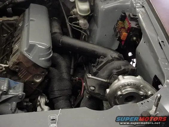

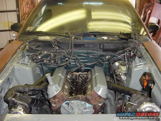

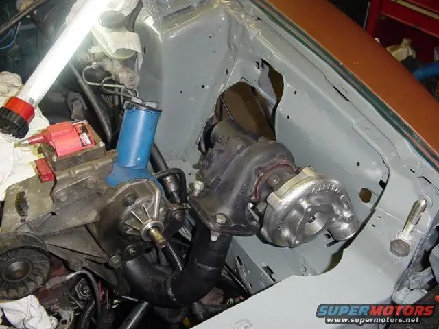

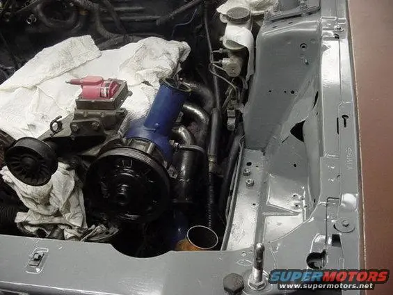

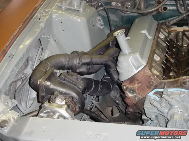

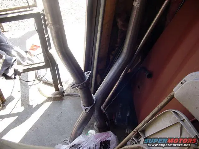

Ive got the headers mounted, Turbos mounted, and down pipes done,that connect to a stock h-pipe, but will be ran with an o/r X-pipe, then to some flowmaster knockoffs through the stock tailpipes.
I also punched and tapped the oil pan with a 1/2" hose on each side for a drain.
Basically now all that is left is to complete the cold side and get the intake manifold on!

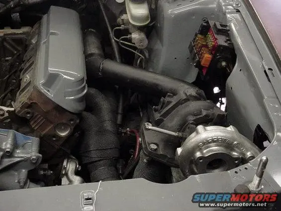

Here are the pics......Im still waiting for the heat wrap but here it is mocked up.
I was able to mount the fusebox above the driver's side turbo, which is nice because its accessible not being in the fender.
I know the welds are mean, but there getting wrapped anyway, and i think i got it down now for the cold side so it should look good.

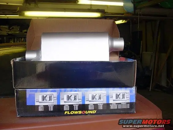

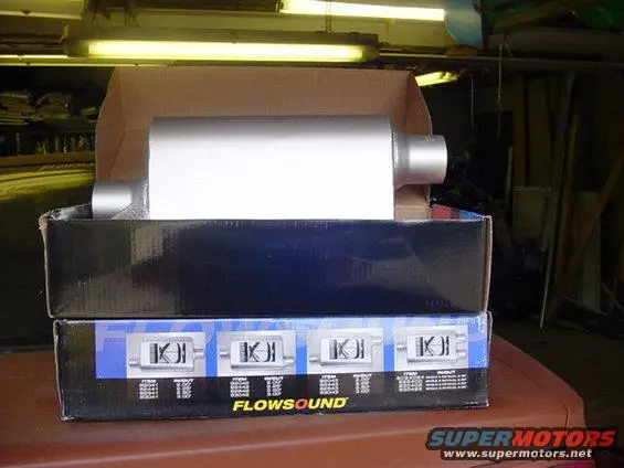

Mufflers:
X-pipe:

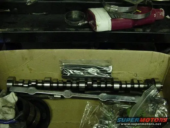

As a side note, I installed a stock cam and pushrods, is anyone interested in a Crane 2031 cam and some Trick flow pushrods for the cam? there only about a year old. I also have a Tilton diff pump that has VERY low hours that i have as leftovers now

you bastard, i thought you said your brother was going to buy that cam. i had to buy one locally for a lot more coin LOL just kidding

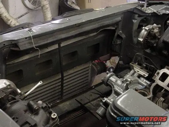

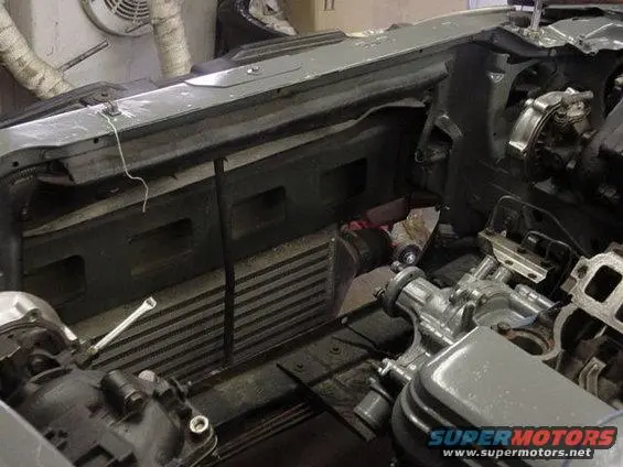

what size intercooler are you using? from the look of the pic you posted, it looks like the one i need
no, he actually cheaped out on me, he is gonna sell his mountineer, got a free bronco...sorry man it just happined. The intercooler is actually quite a small one that i had for my last kit, knowing that my piping would do alot of cooling. It should work fine for now tho....as a plus, i just mounted it directly to the bottom of the bumper and it was easy easy. Also its a 2.5" and rated to like 500hp or so.
Today i Got my lower intake on and torqued down, and my heat wrap arrived so i wrapped all my headers and downpipes. I got the sparkplugs in (autolight 104's gapped at .030) and now im going to tighten everything up good on the hot side and start on the cold side, which should go quite fast, as im only using 1-3/4 pipe for the crossover from the pass. turbo to the driver's side of the intercooler. Then through a y-pipe to 2-1/2 through the intercooler. easy easy. This is nice to build opposed to crawling under the car back and forth when i made the remote mount. Its going much faster and looks much better!
Oh, and the mufflers were from summit....i think they are very similar to flowmasters....but they look to have better built internals.
My car should be REALLY quiet now. Before with JUST the turbos only rear mounted it was about just as loud as when i had the offroad h and flows. Now with the turbos mounted front and mufflers rear its gonna quiet down alot....which actually will be nice because it got quite loud on the highway...plus where i mounted the turbos before....they were LOUD in the car, when they spooled, damn you couldent think straight.
