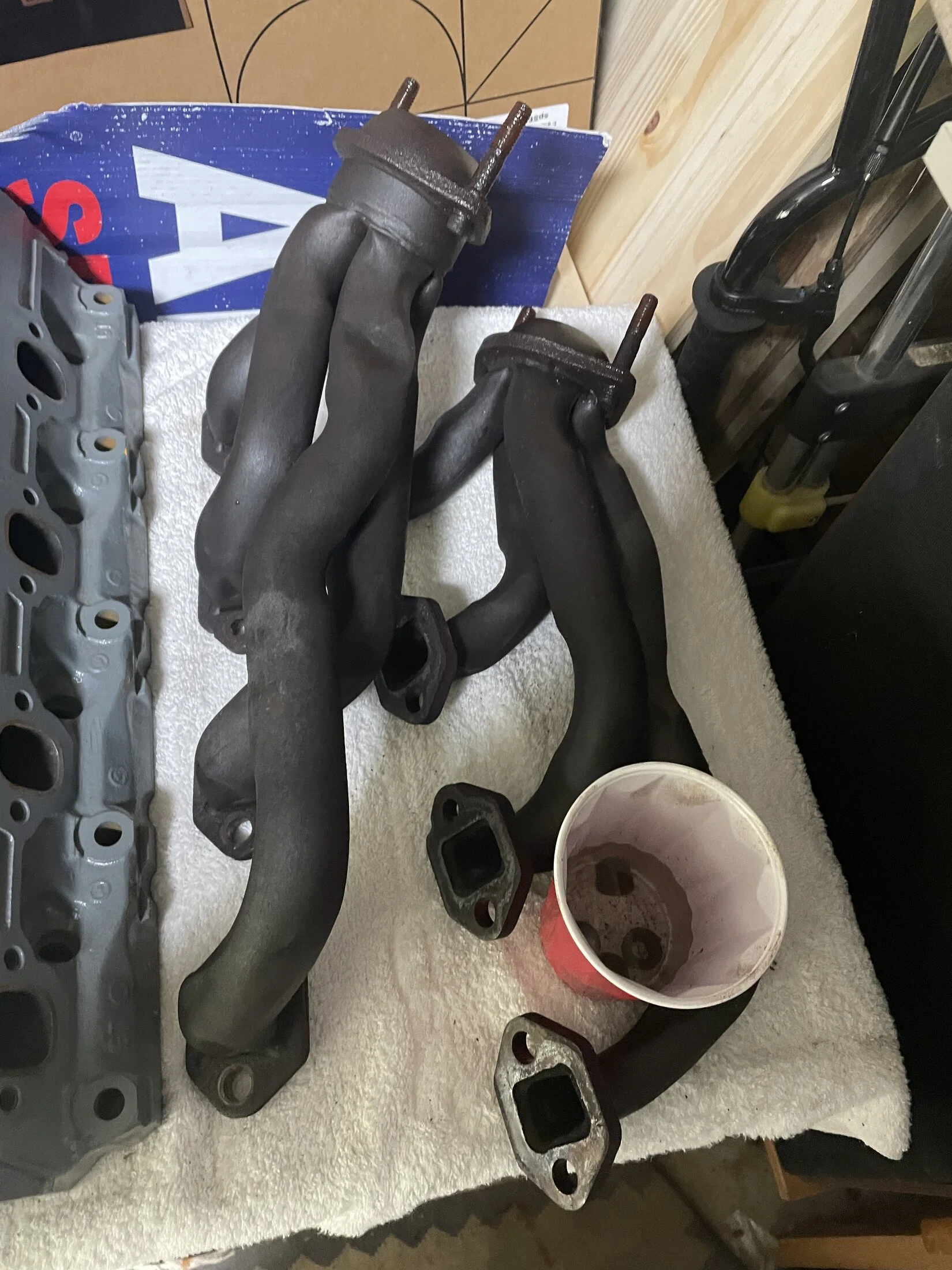

On the headers, run a die down the threads on the header studs and get those threads cleaned up. I just bought new nuts at Lowe’s (ran a tap through them) along with heavy flat washers and some lock washers. Has made it a lot easier since when needing to remove them.

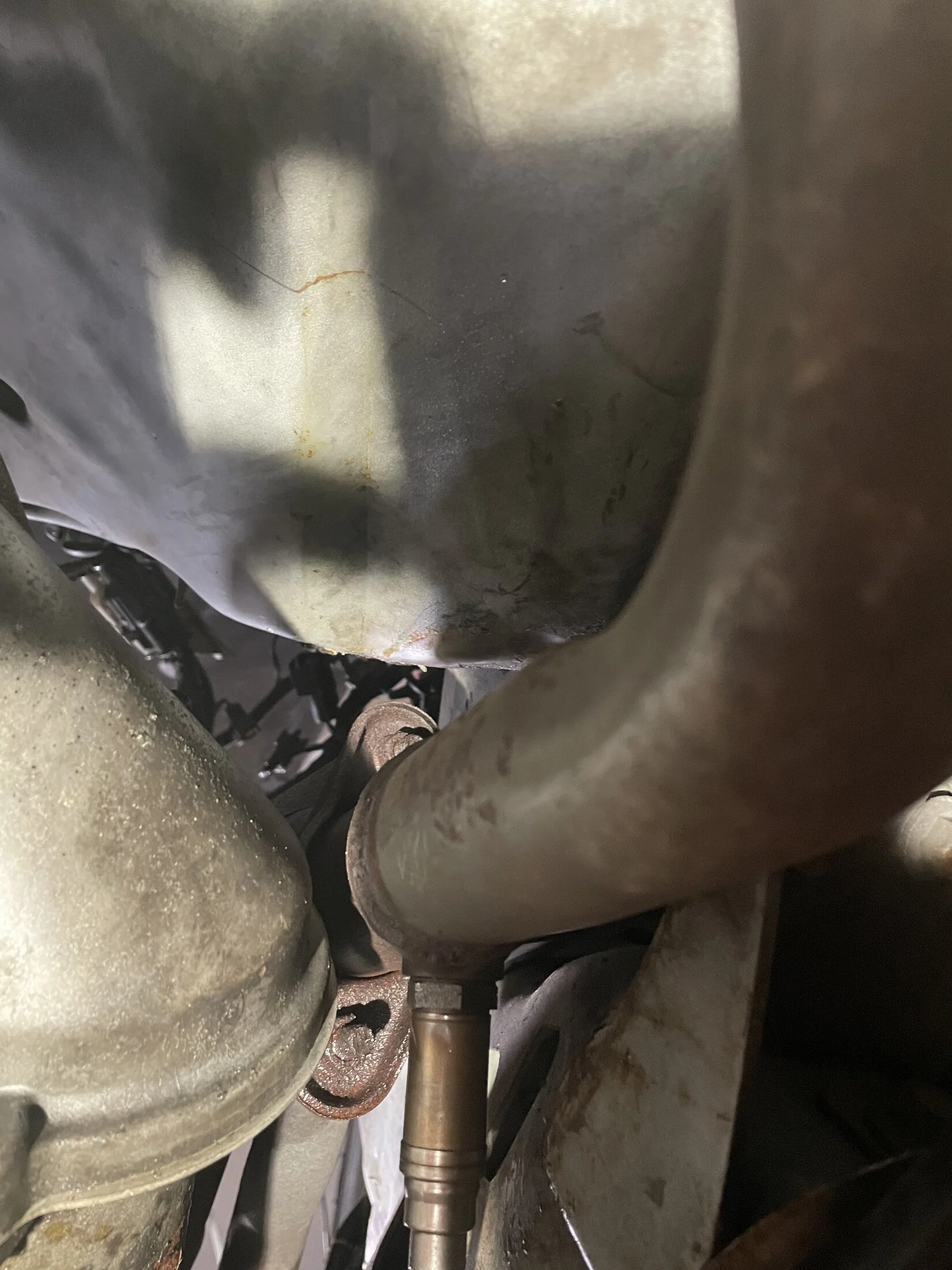

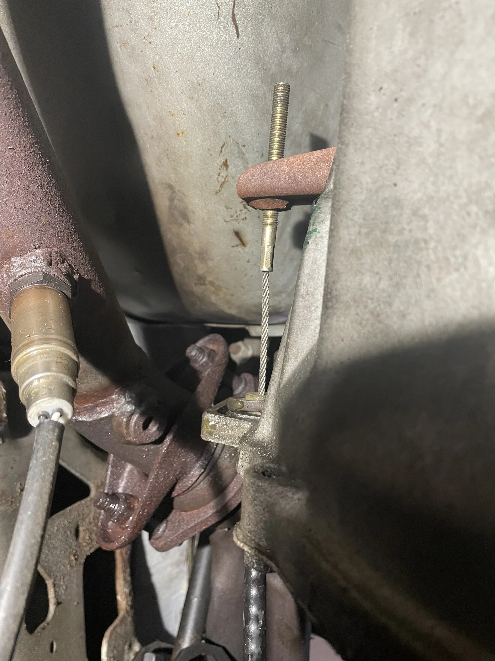

Much easier than I thought. Didn’t need a torch. For the passenger side under sensor did need bendy socket thing with shallow socket.
Funny how they marry up, just a ball joint kinda way.

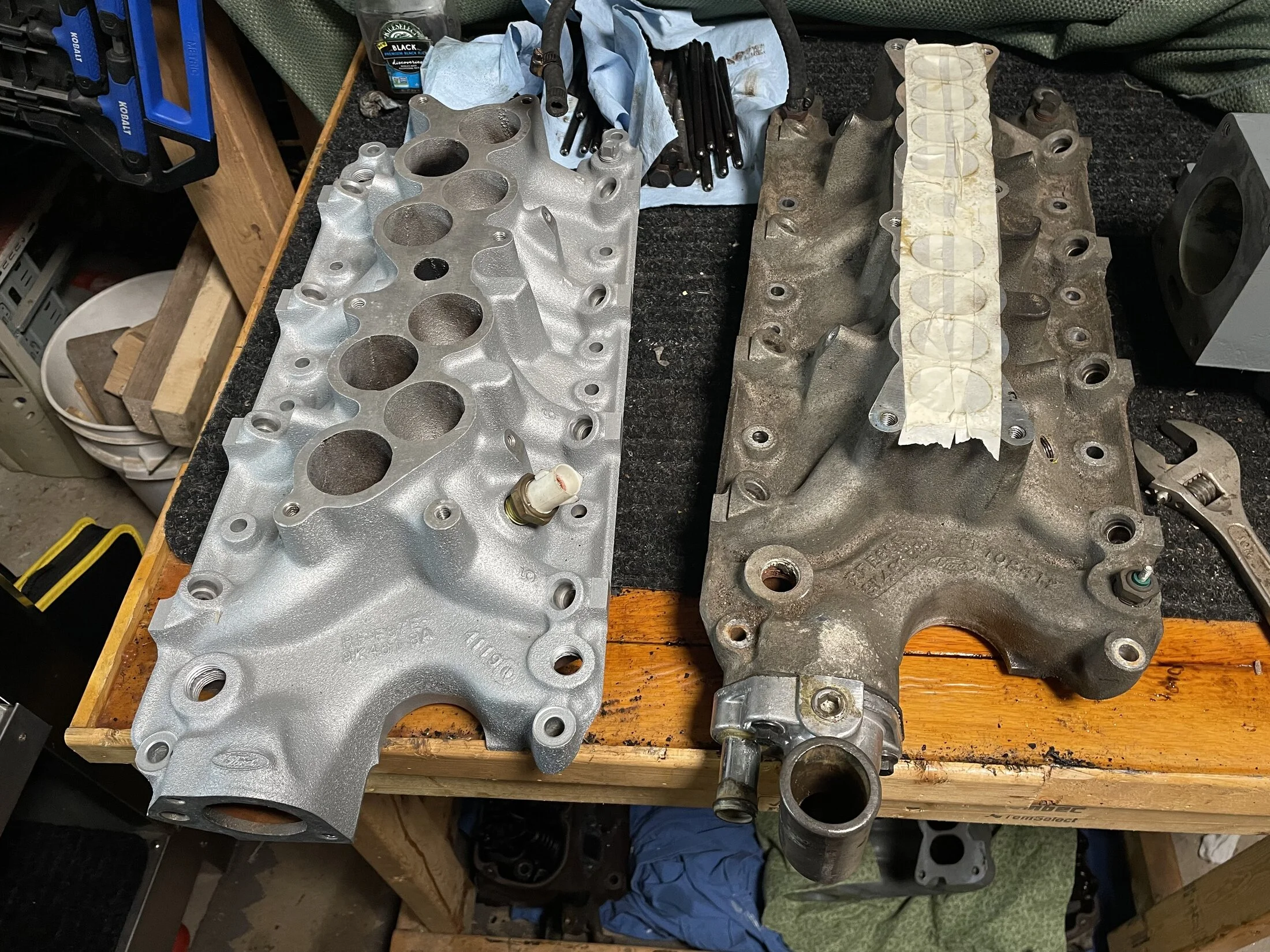

Riddle me this ...
Went to tap the new intake for the ACT sensor and it already fits. What am I missing here. Someone already did the work? Something else?

Looks like I have a "Ford Racing" lower intake?
The Most Complete GT40 Intake Information Page
The "Original" GT40 Intake As our foxes get older and more collectible people are starting to look at what performance parts were available in the early days and this post...
www.foxstang.com
Ford Racing
Sold as a kit from the performance catalog from 1998 to 2003, this is a modified Explorer lower intake to fit your fox. It would have the part number like RF-F87E-9K461-BA Which is a direct bolt-on for the Fox Mustang. There’s also a number RF-F2ZE-9K461-AA which is also a valid casting number. (Although I’m not sure if this is FRPP or not)

That would be my guess. One less thing to mess with!

I thought some of the early Explorers had the threaded hole? Maybe not.

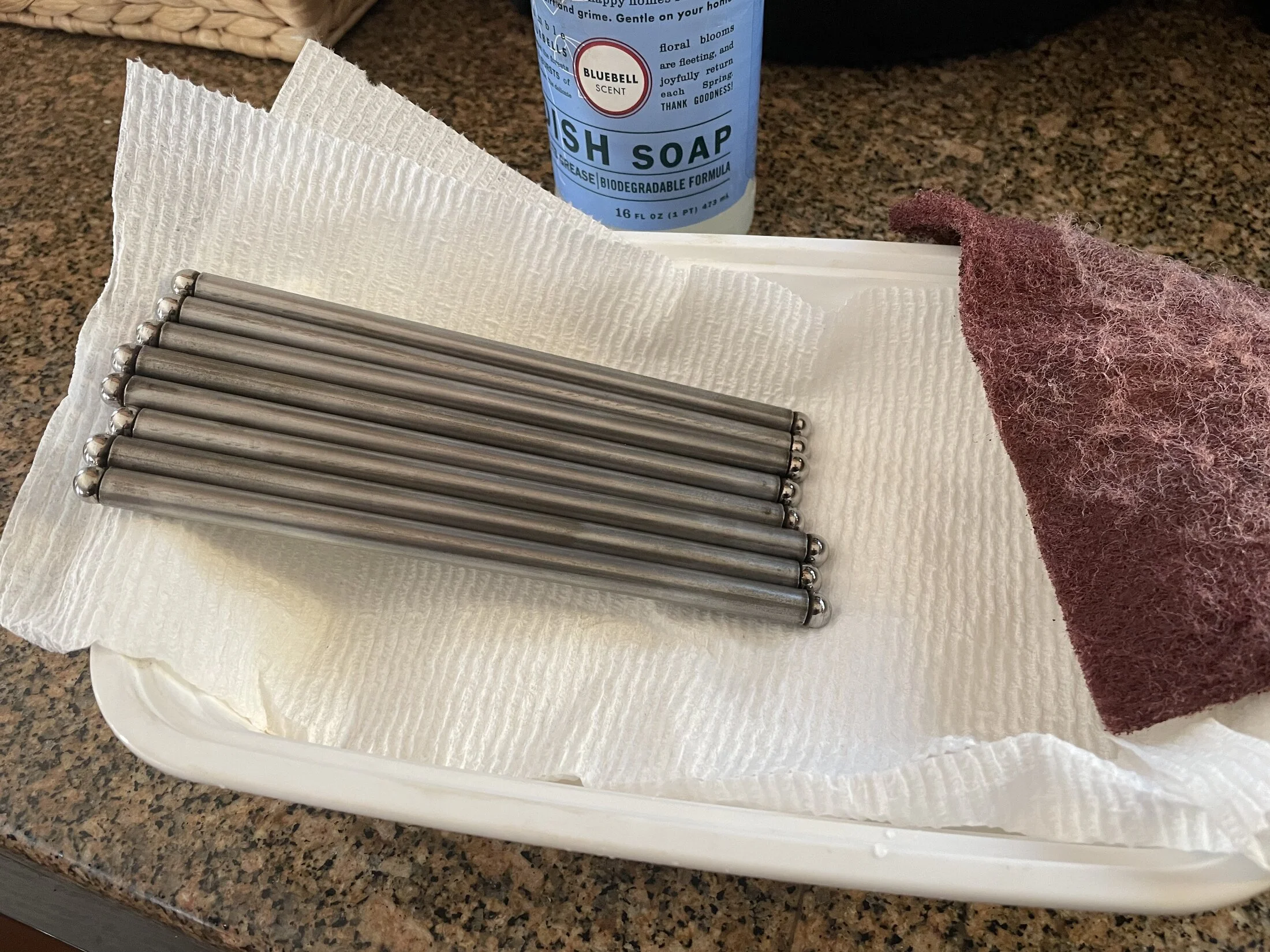

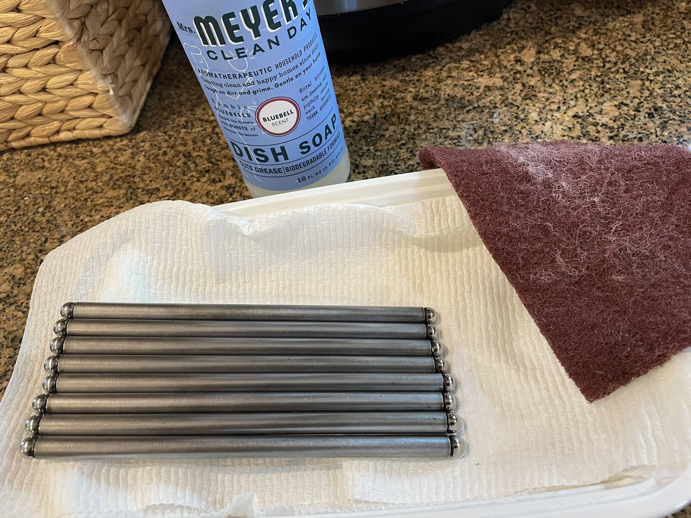

2nd set all clean
Next up rockers

Are you blowing out the insides with compressed air?
Does my mouth count?
