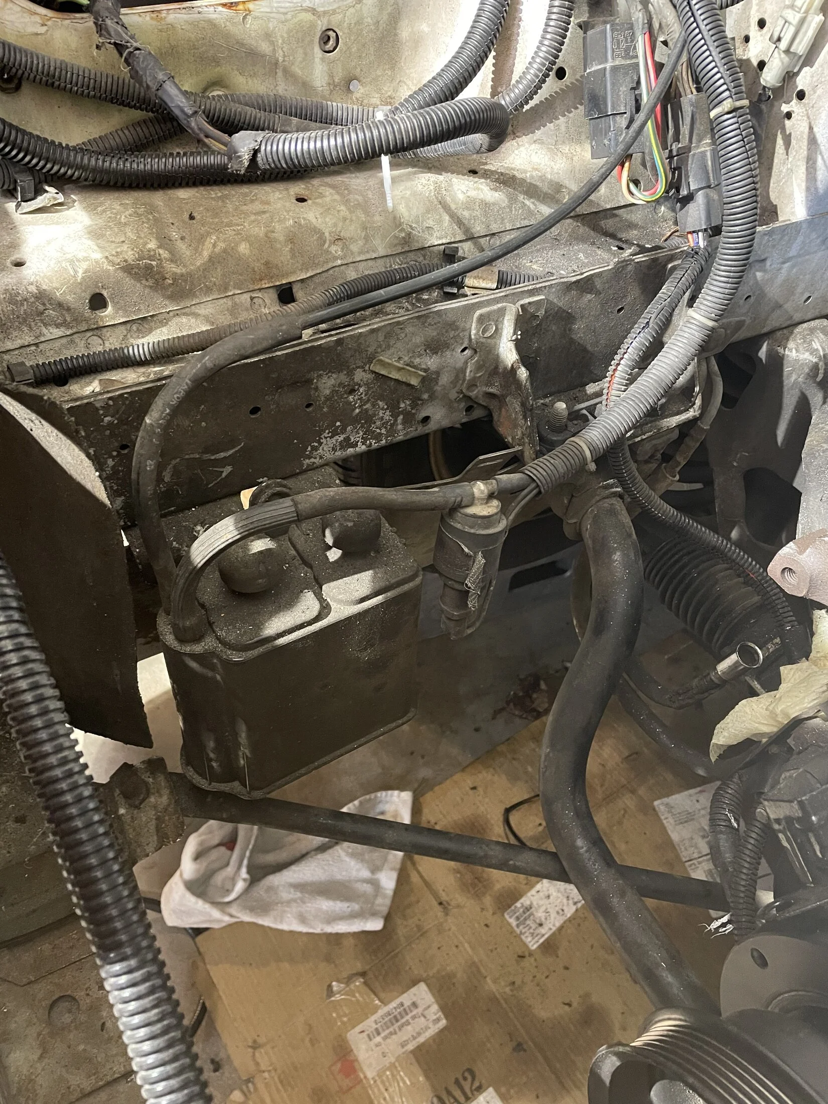

Is this needed? Looks like charcoal evap or something? I’m smog delete, is it needed?

Needle nose pliers or a big screw and pliers, just pulls out.
It's the PCV screen.
Reactions: JAA

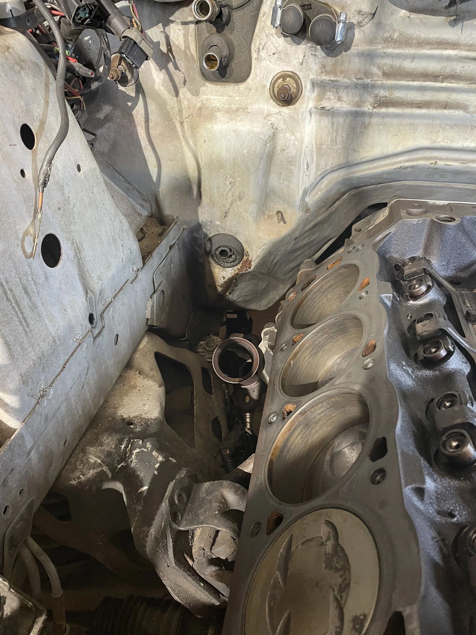

what’s that for? The hole in the firewall.

Does it need cleaning?

That’s the PCV valve filter screen. Pretty readily available so you can try and get it out to reuse but I usually just install a new one as I tore the only one up I tried to remove.

Hole in firewall is AC evaporator core drain for condensate. Coolant will also come out of it if the heater core pops.
Most cars that are smog delete keep the charcoal canister. It goes back to the gas tank and the vapors from the tank push into this canister. It then is introduced into the intake via the evap valve which is electrically operated.

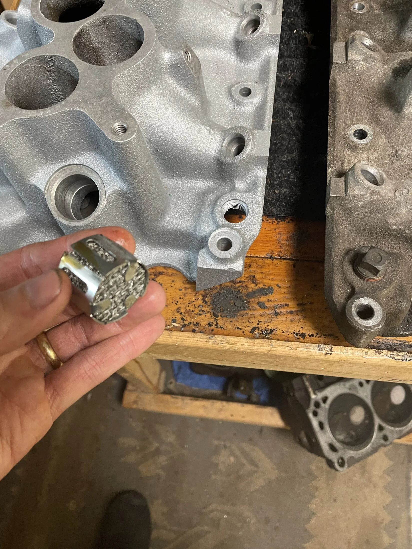

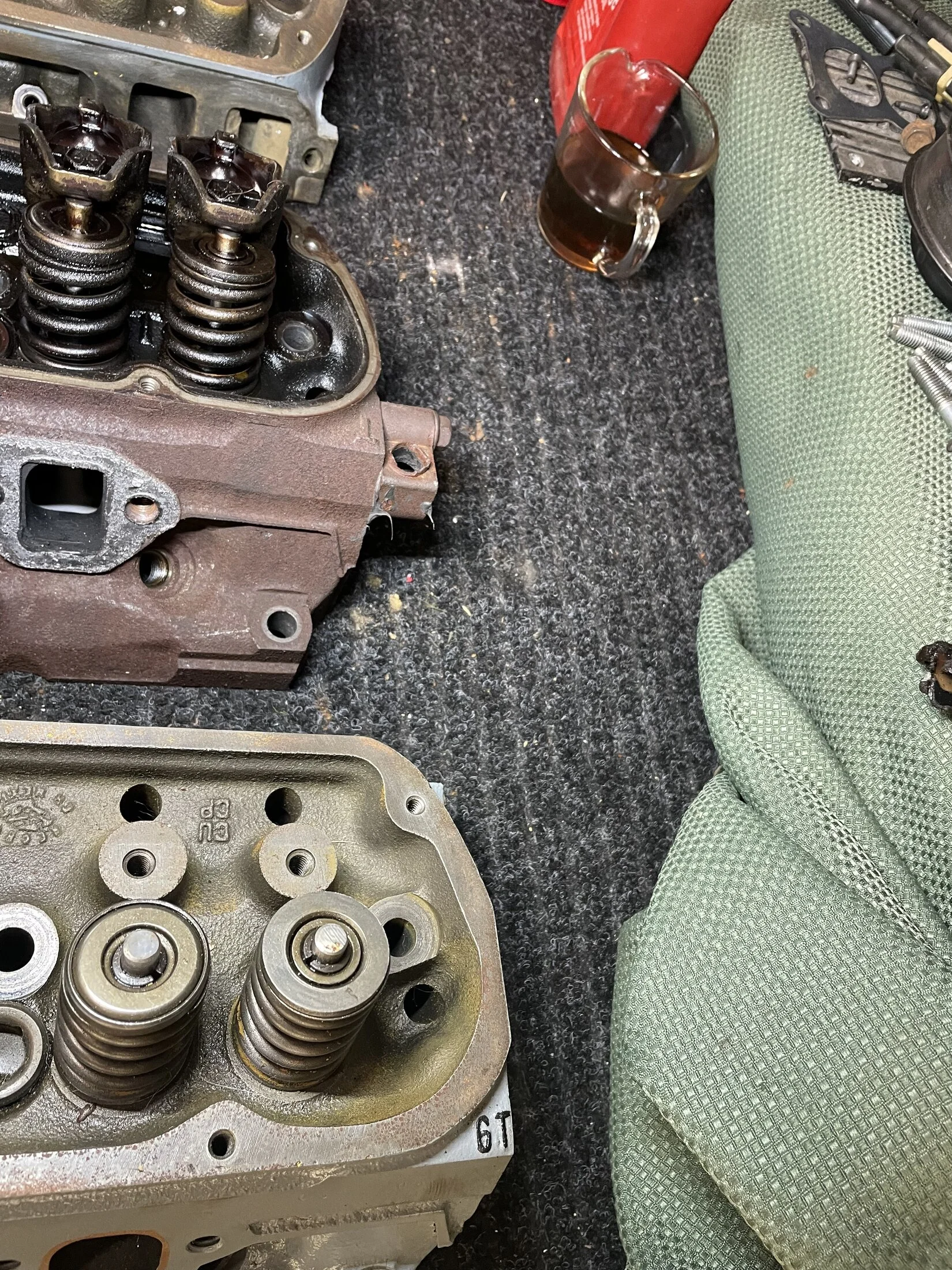

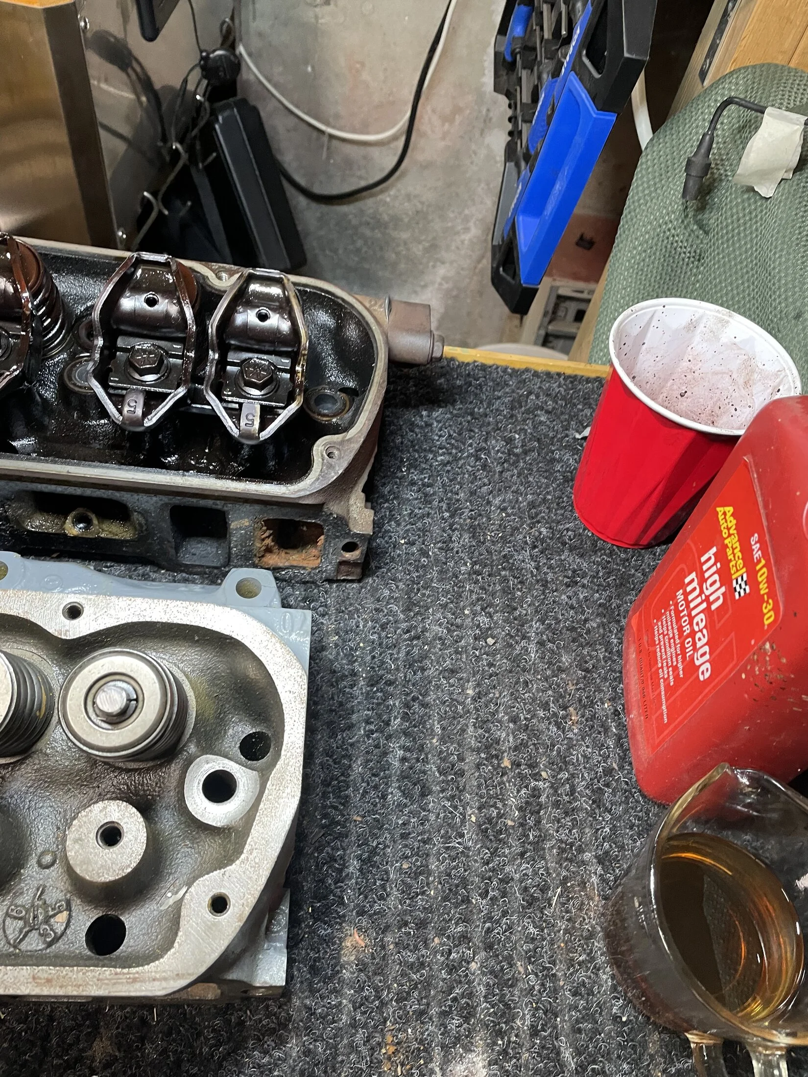

What are these rtv sealed attachments on the original heads? Don’t see them for new ones.

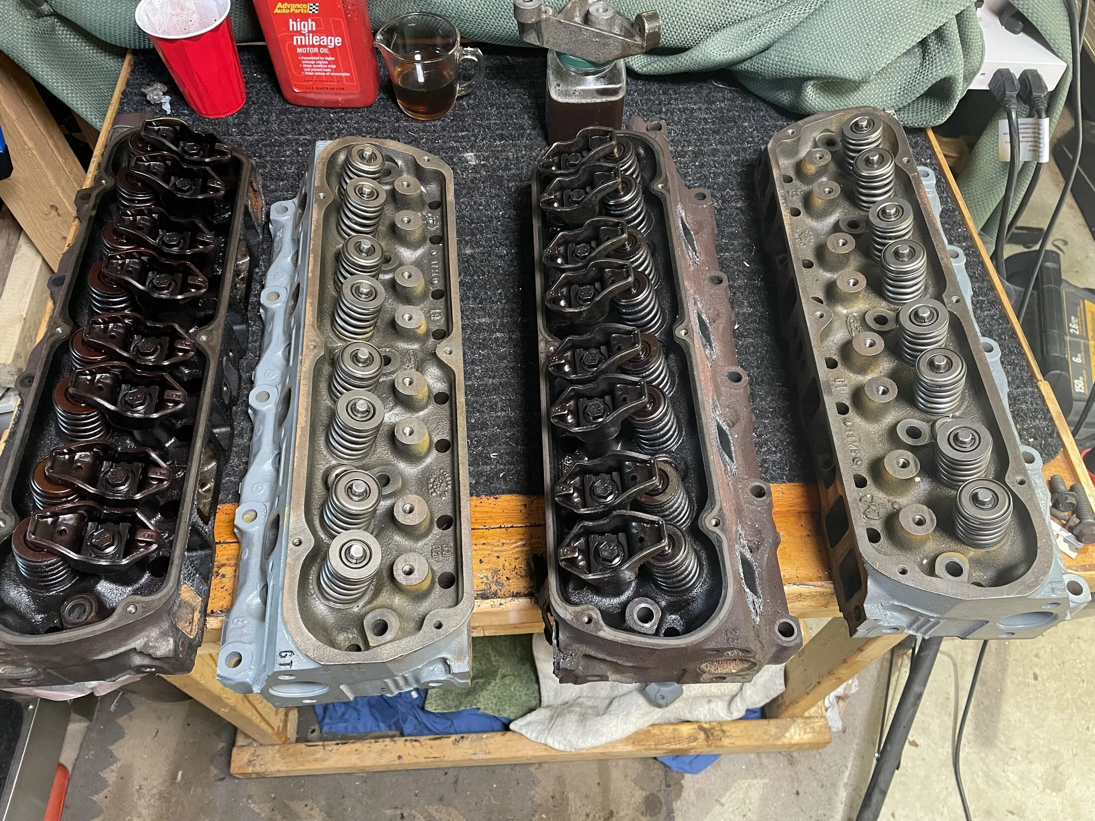

Uh, dumb question - how do I know which GT40 head is driver vs passenger? Looks like one is marked 70 and one 71?

Looks like original heads are marked 23 and 24. Match up smaller and larger numbers?

Attachments are the ends of the old pipe that attached to the back of the heads that was part of the smog system. Used them to plug those ports off. Aftermarket heads typically have the holes and you have to put these in them:
https://www.summitracing.com/parts/...bDSAmnRS63VmwZaZzzJE4ip086eHaEQ4aAi1BEALw_wcB
I had to put them in bother ends of the heads.
Cylinder heads do not have a left right so it does not matter.

Super weird here. Both sets of heads, old and new, have a different number stamped in the corner. 70/71 GT40 vs 23/24 for original. How is that possible?

Went to get heads resurfaced. Said the valves are sunk and guides are worn. Should be rebuilt and not worth the effort. Does that sound right?

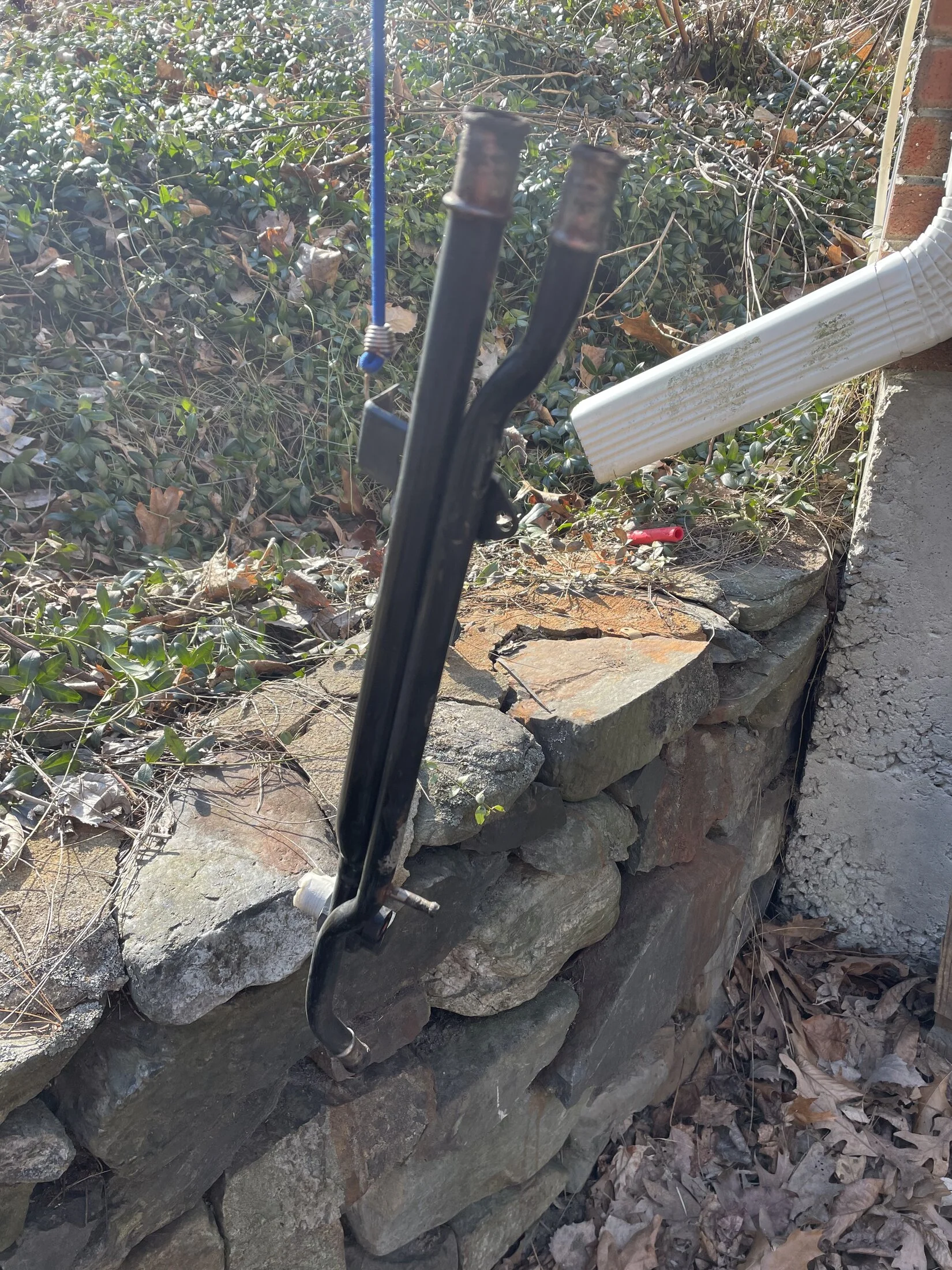

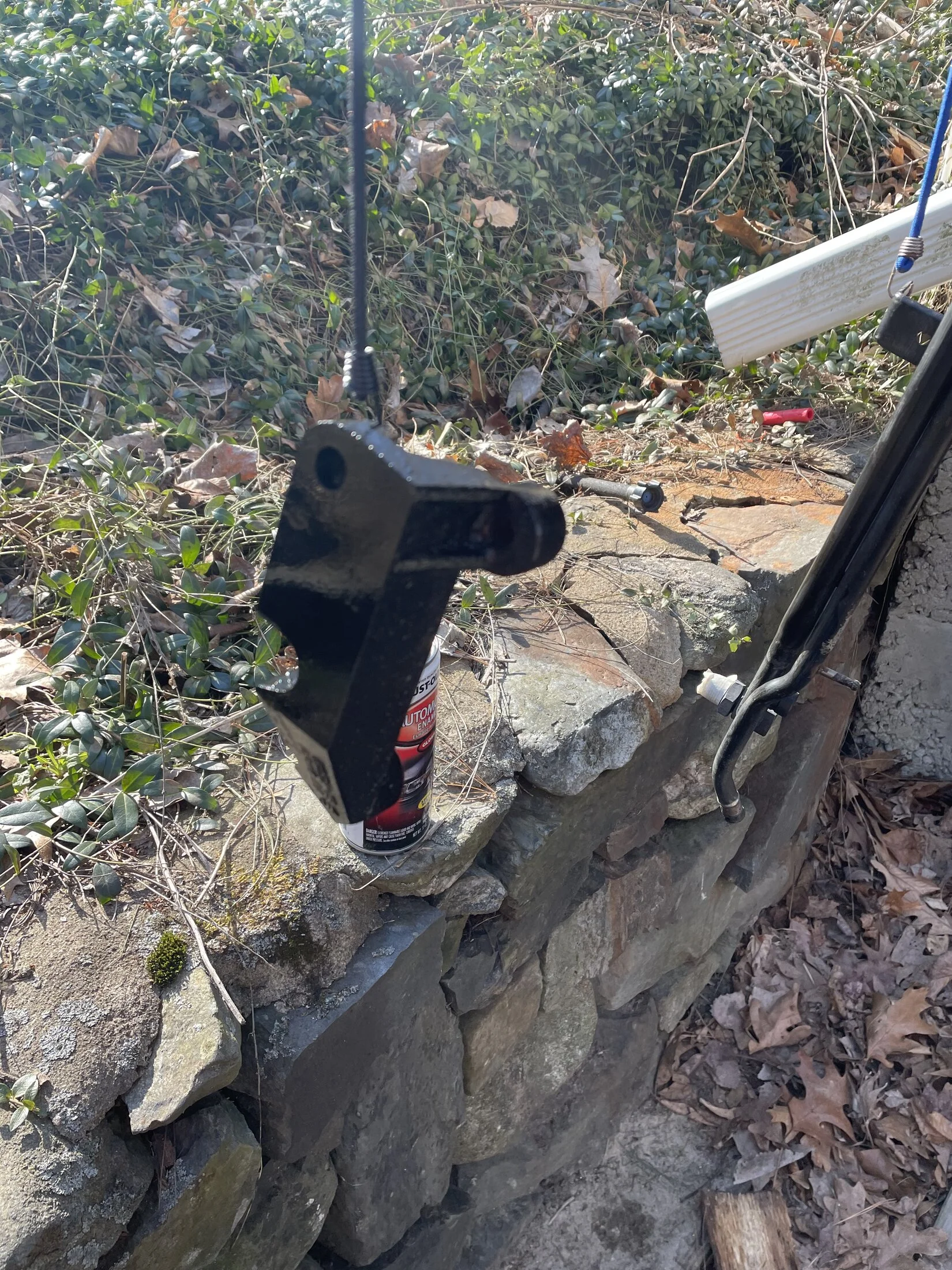

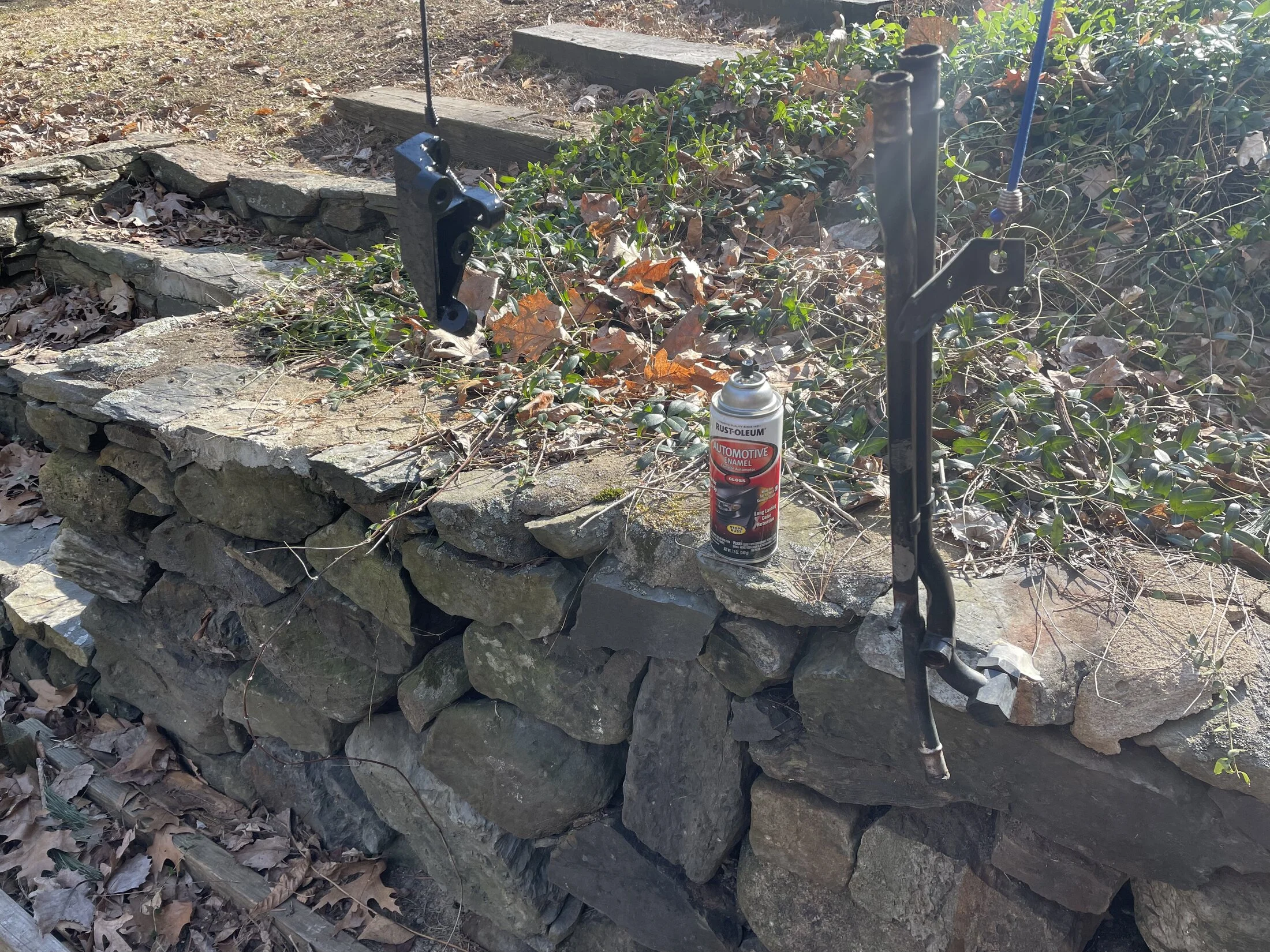

Such a beautiful day. Doing some painting. Silly bracket done. Next some sort of cooling rail.

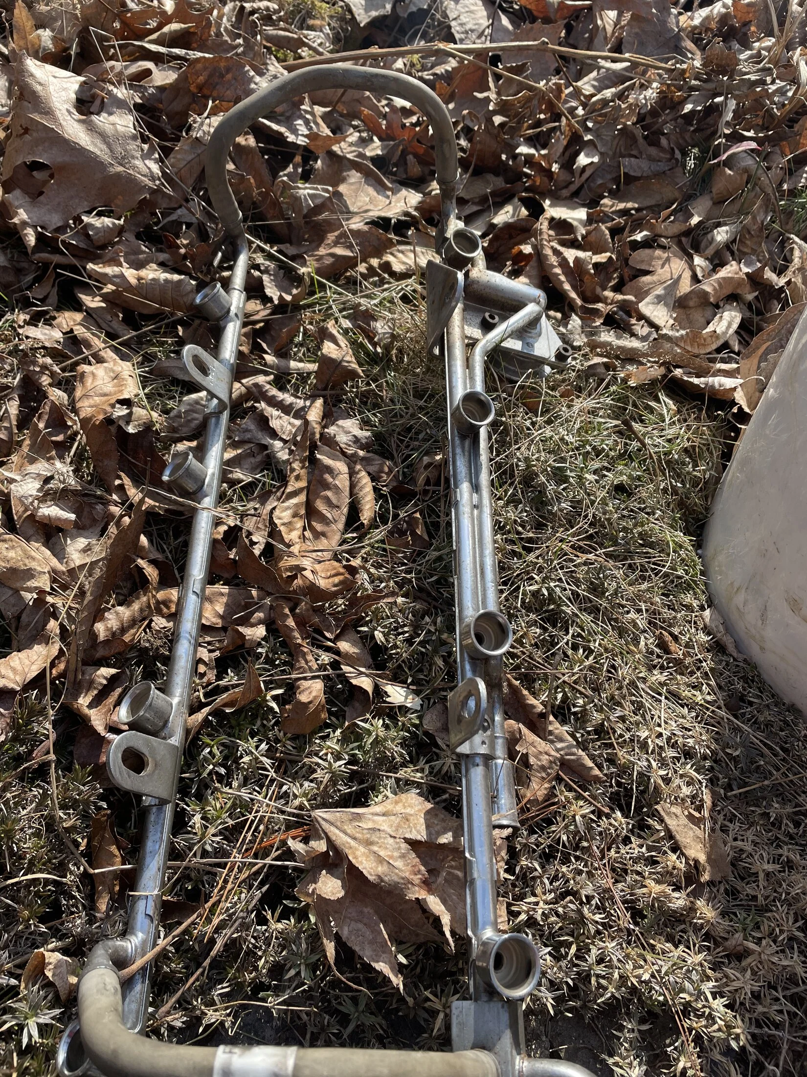

What do people do with their fuel rails? Ive read most folks powder coat them. What about paint? Ill at least get these cleaned up

I would not worry about the numbers stamped in the heads. Not what the "valves are sunk" means. Regardless having new guides, and valve job done, and resurfacing the heads is not expensive compared to new heads if that is what "it's not worth it" was referring to. Basically confused by most of that but I if the machine shop is saying rebuilding the heads is not worth it go to another shop.
Cooling rail are the metal heater tubes that run between the water pump and intake ports to the heater core.
As for the fuel rails. They can be very gently polished with 0000 steel wool. Use something like WD40 for a lubricant....on the injector rails.

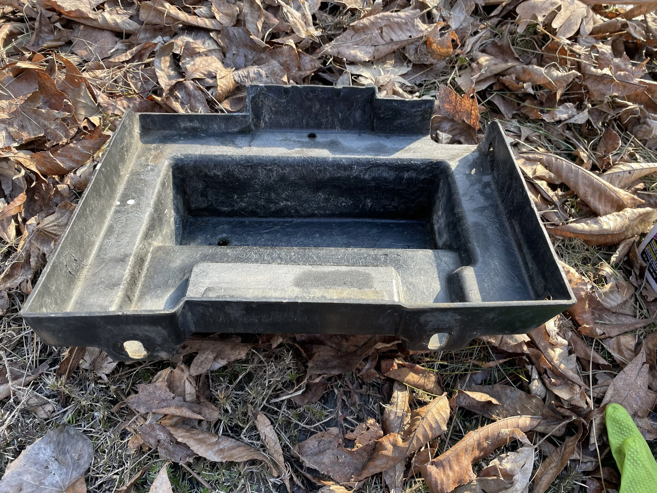

You can spray paint plastic right??

If that is the battery tray I would not paint it. A good scrubbing and reinstall. Not going to see it with the battery in it anyhow.

Yea - spoke to the guy who I got the heads from. He says machine shop is full of it. Weird as I was ready to hand out cash. FWIW going rate for machining in MA for v8 heads is $300.

But I just learned spray painting is not something I suck at. I want to spray paint it all!!!
