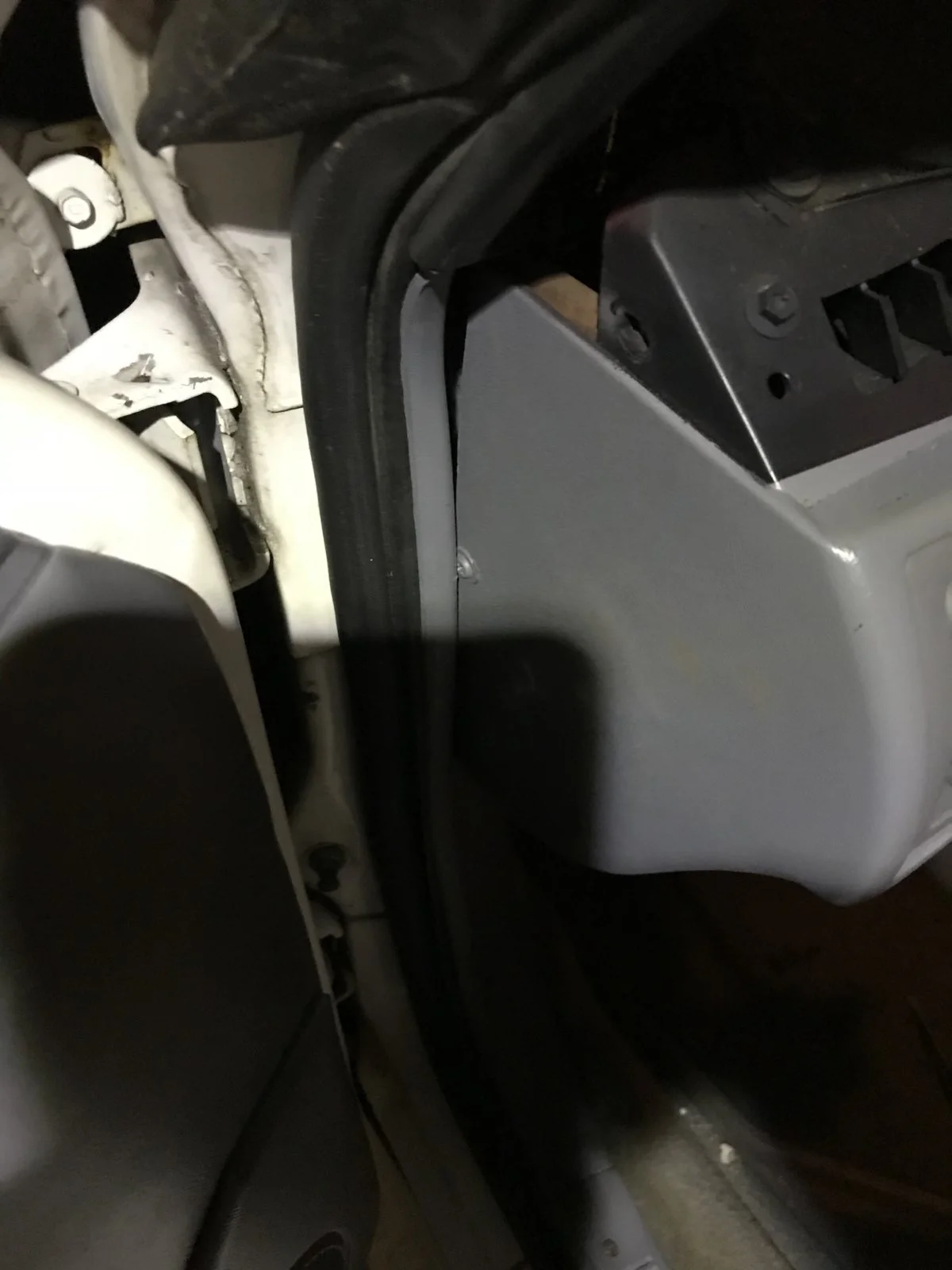

WTF are these? They are sacially Beijing the door frame trim

Can't tell what you're talking about

Ha, sorry. The little gray screw. It it behind the door trim. Not on any drawings or videos. I’m wondering since this vehicle interior was replaced from white to gray it was done after the fact. It was really annoying to get to.

Both of mine have the same screw, take the kick panel off makes it easy to get at

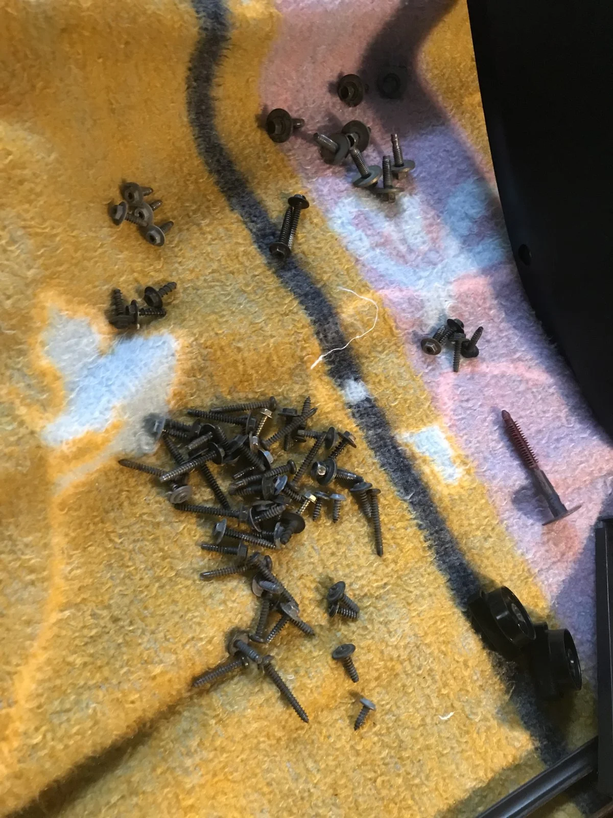

JAA
5 Year Member
Oct 2, 2018
674
110
63
Central MA
Oct 20, 2018
#26
  • Oct 20, 2018
  • #26
Weird. Yea, that’s what I did but it wasn’t included in the documentation.

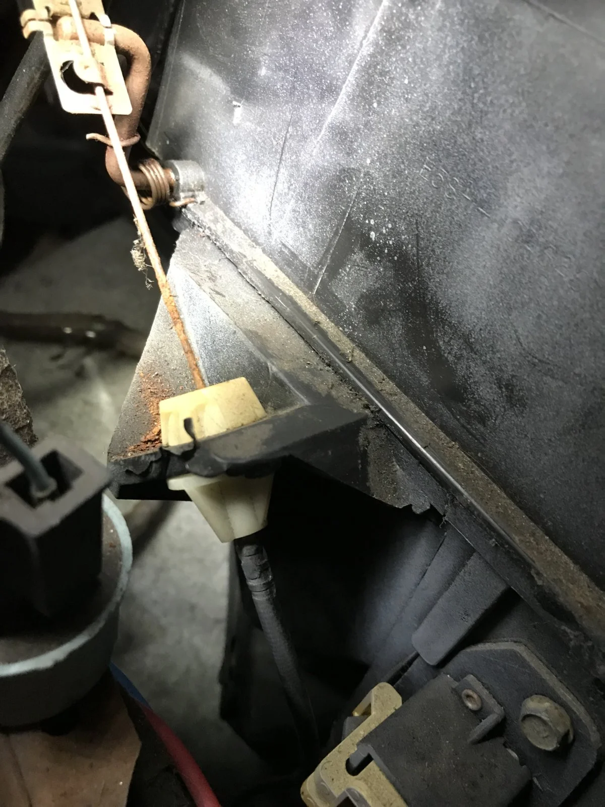

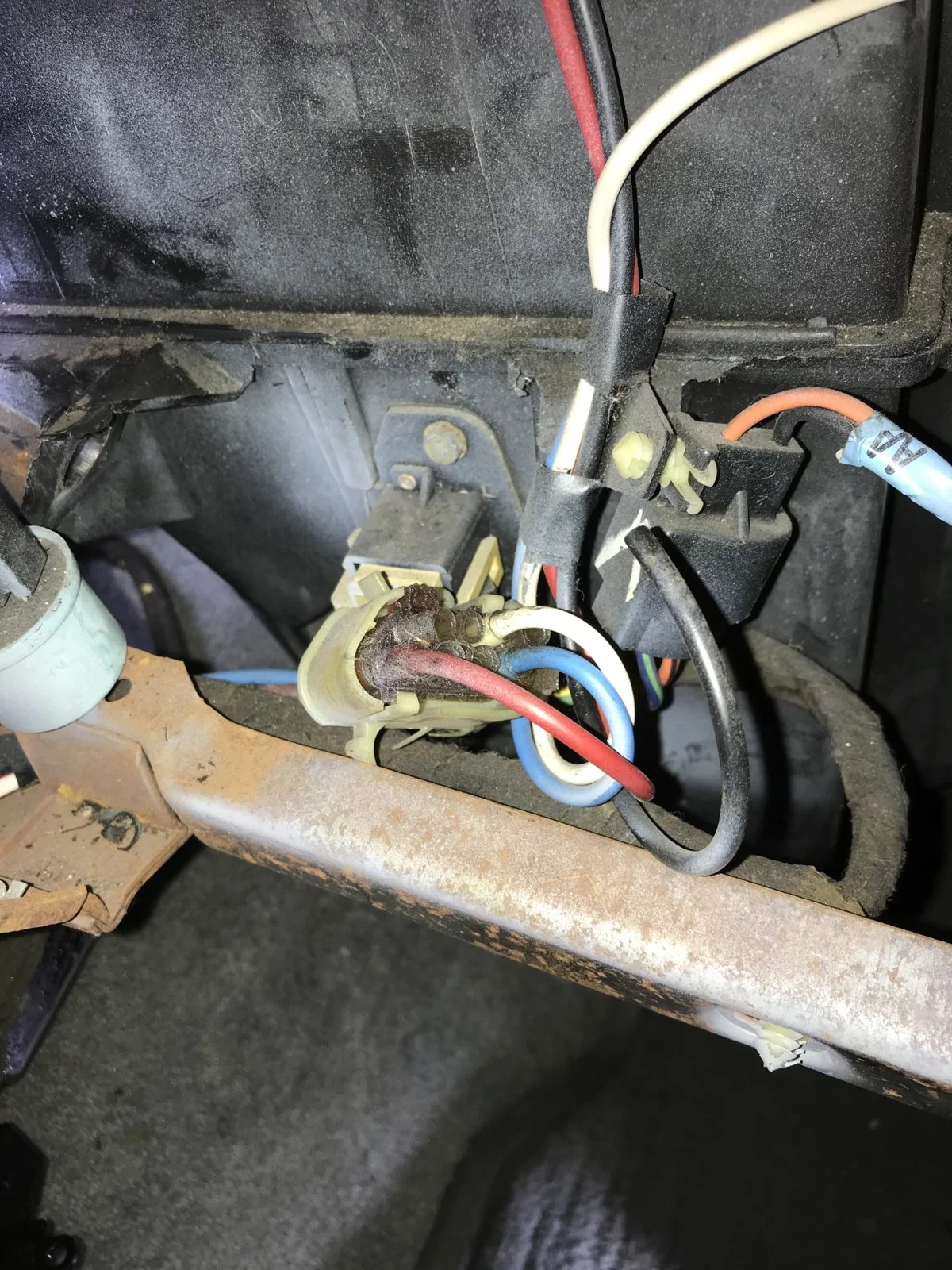

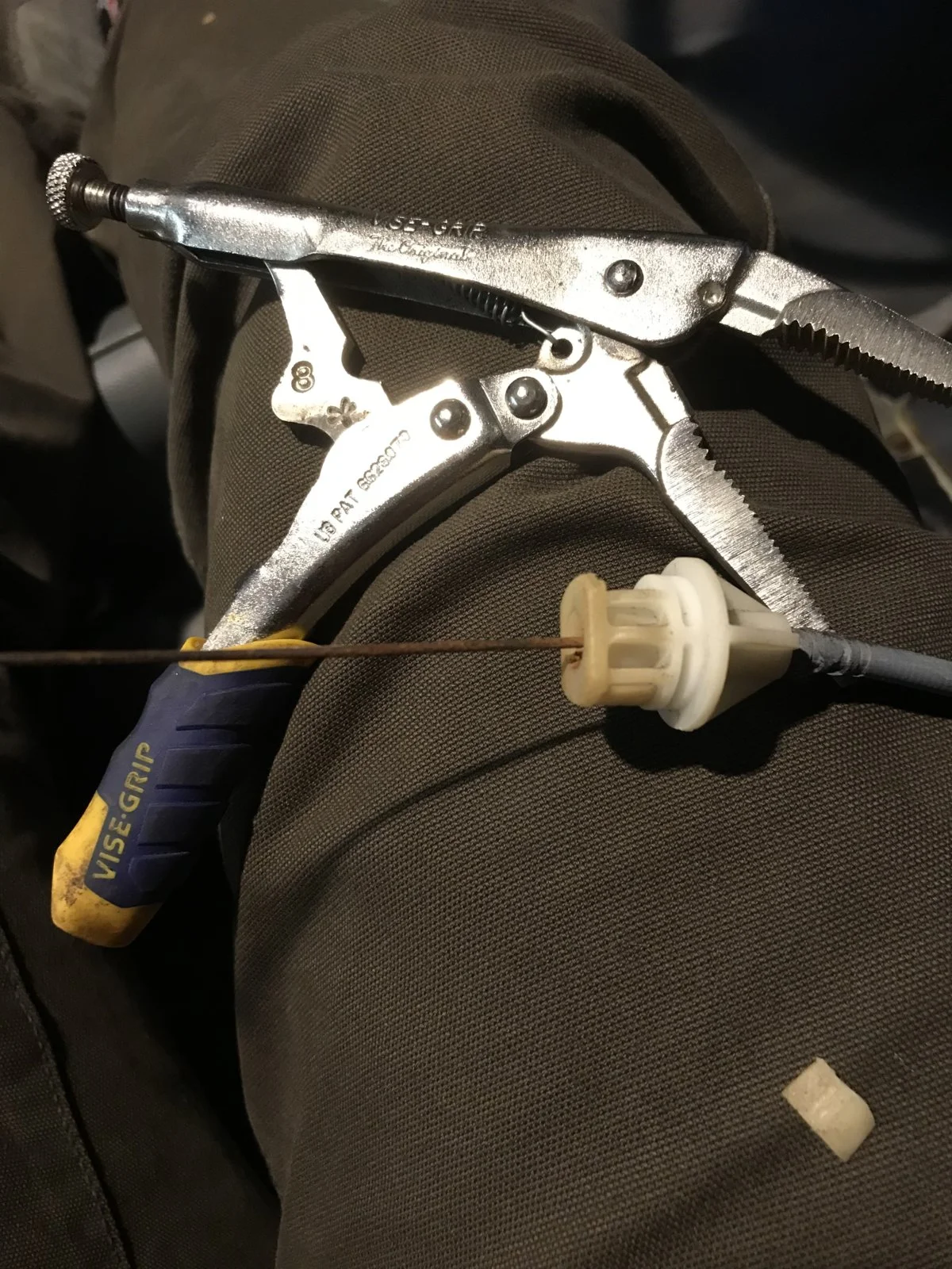

Ok, thank god I was wrong about the door arm. Only the cable is rusted. Once I remove from the arm the arm moves freely. Pretty annoying to get in there. I am hesitant to remove the steering wheel.
Next question, how do I remove the cable from the mount?
I don’t want this to happen ...
JAA
5 Year Member
Oct 2, 2018
674
110
63
Central MA
Oct 21, 2018
#28
  • Oct 21, 2018
  • #28

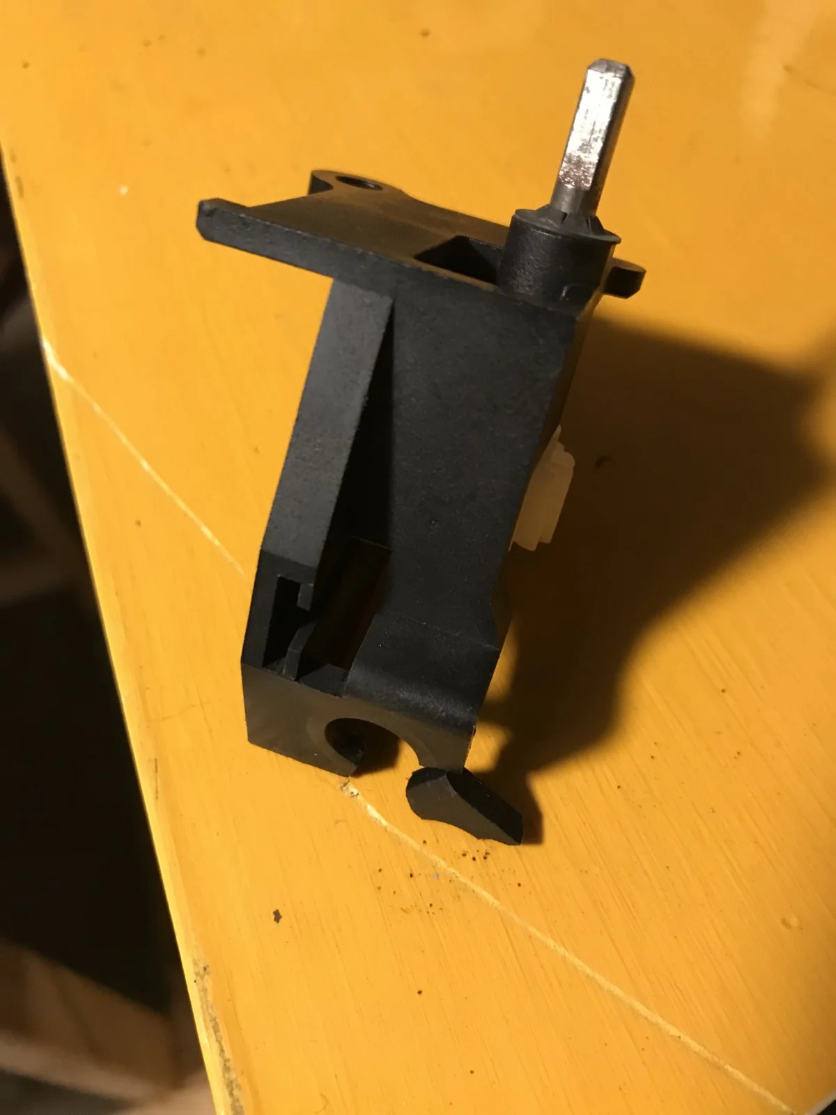

I guess this is how
Reactions: Davedacarpainter
JAA
5 Year Member
Oct 2, 2018
674
110
63
Central MA
Oct 21, 2018
#29
  • Oct 21, 2018
  • #29

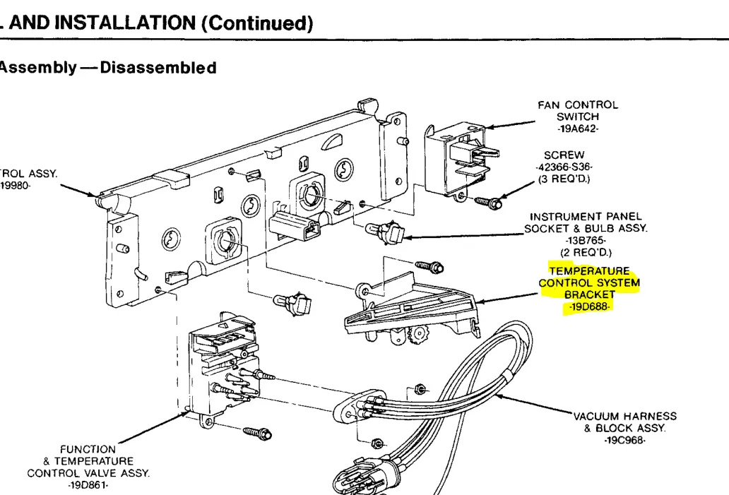

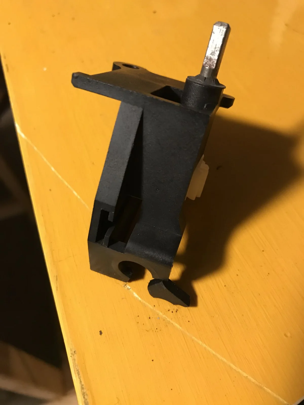

Now I just need to figure out the name of this so I can buy a new one.
anything else I should be getting to while o have the dash /half/ off? I know I need to fix the hood release cable tightness.

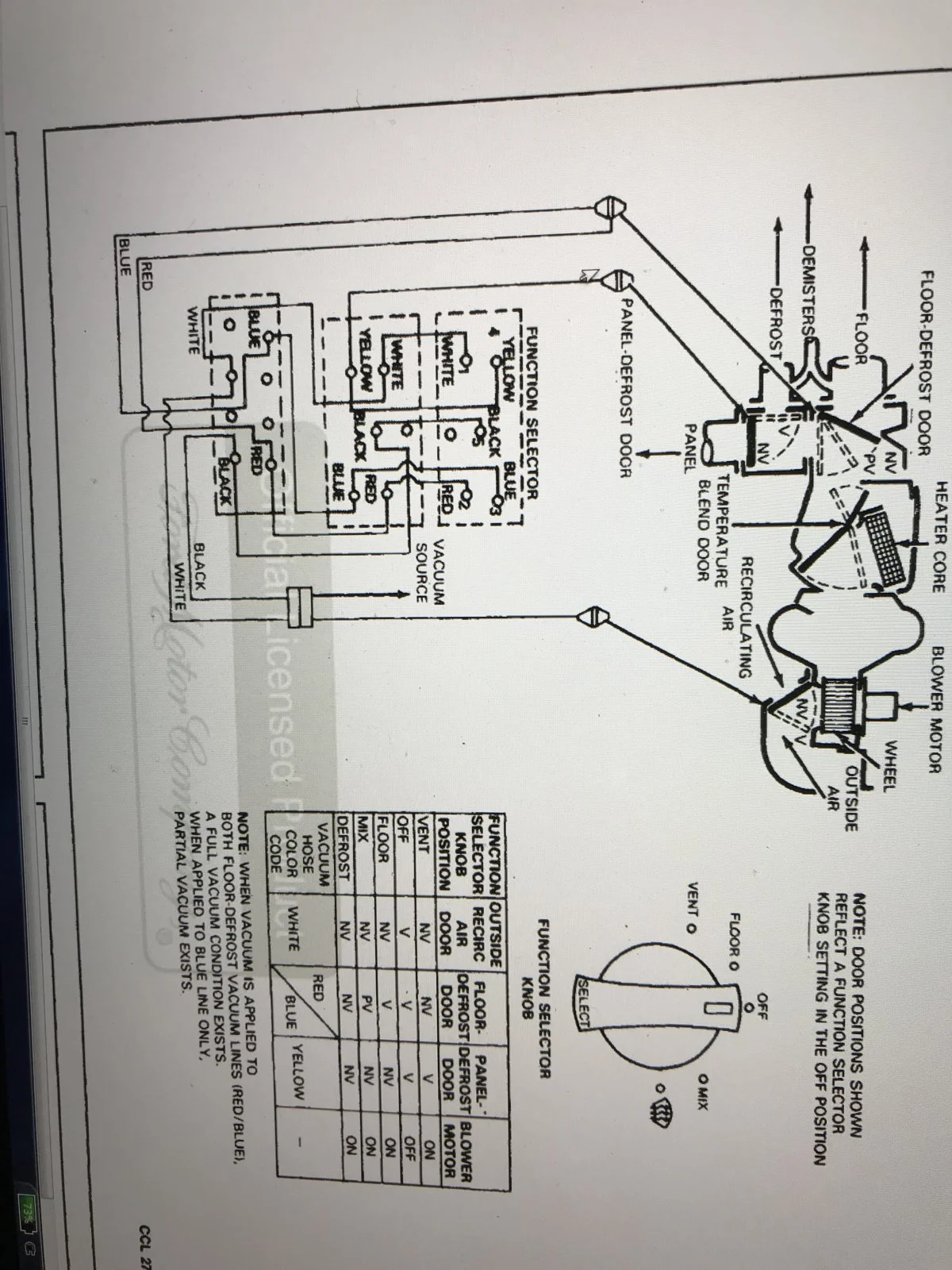

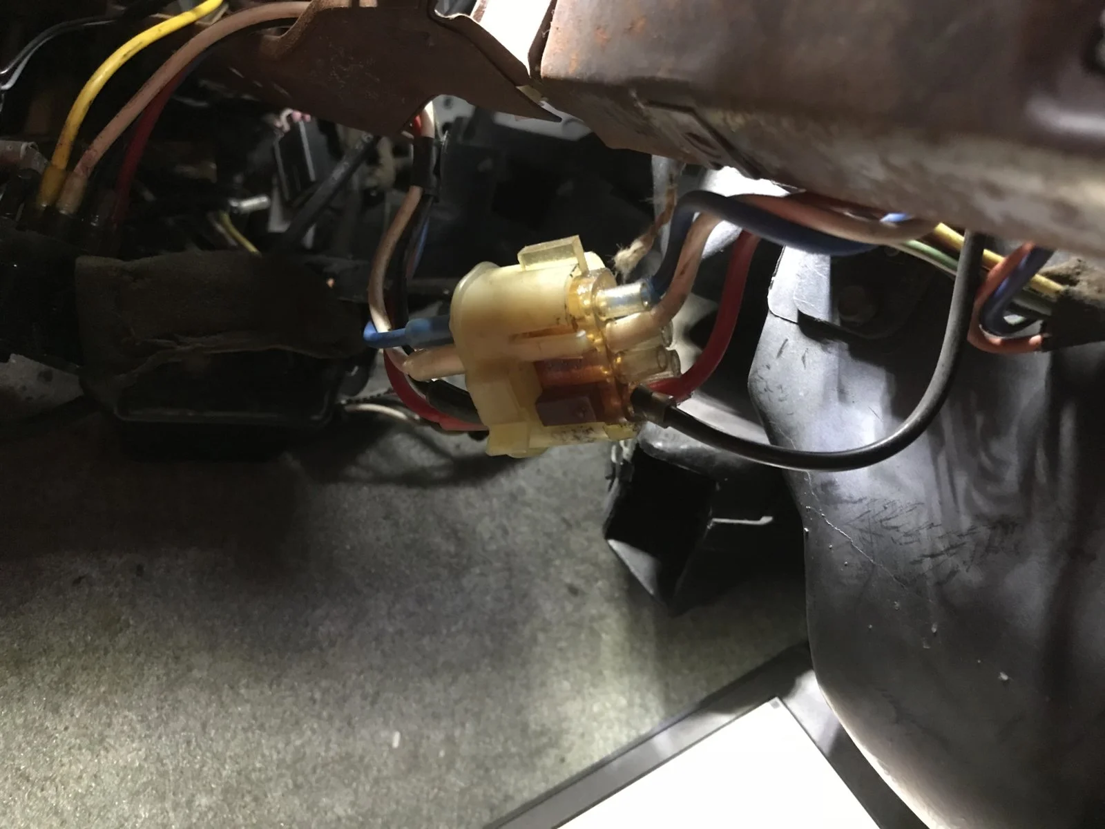

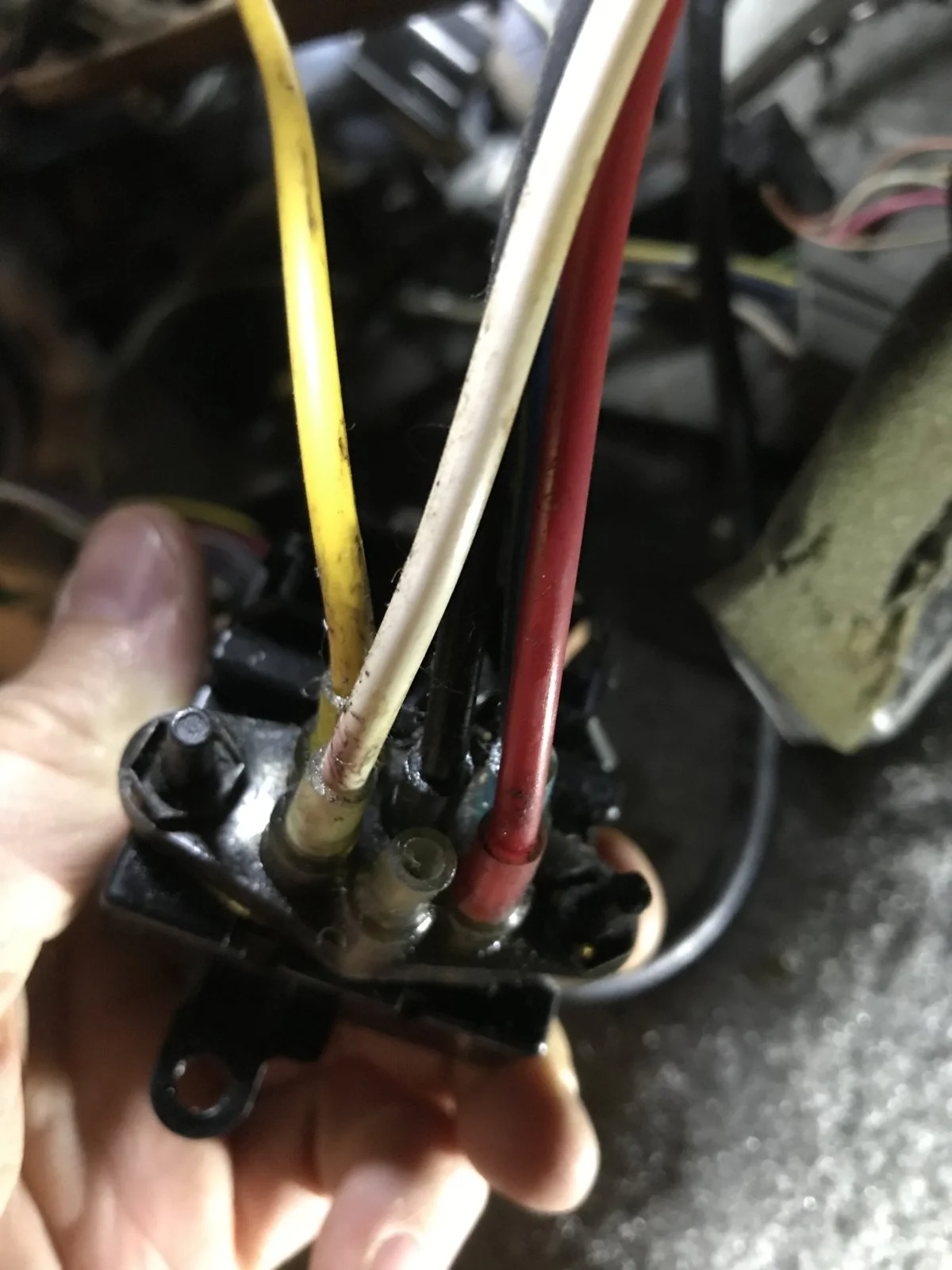

2 questions
Where does the black one go? Either I accidentally pulled it off or it was already off.
Am I missing a line here? I’ll go look at the schematics now, but it seems one is missing
JAA
5 Year Member
Oct 2, 2018
674
110
63
Central MA
Oct 21, 2018
#31
  • Oct 21, 2018
  • #31
Schematic shows only 5 on the function selector.
The backside of this connector looks to be a 1:1 with the other colors so I just hooked it up symmetrical

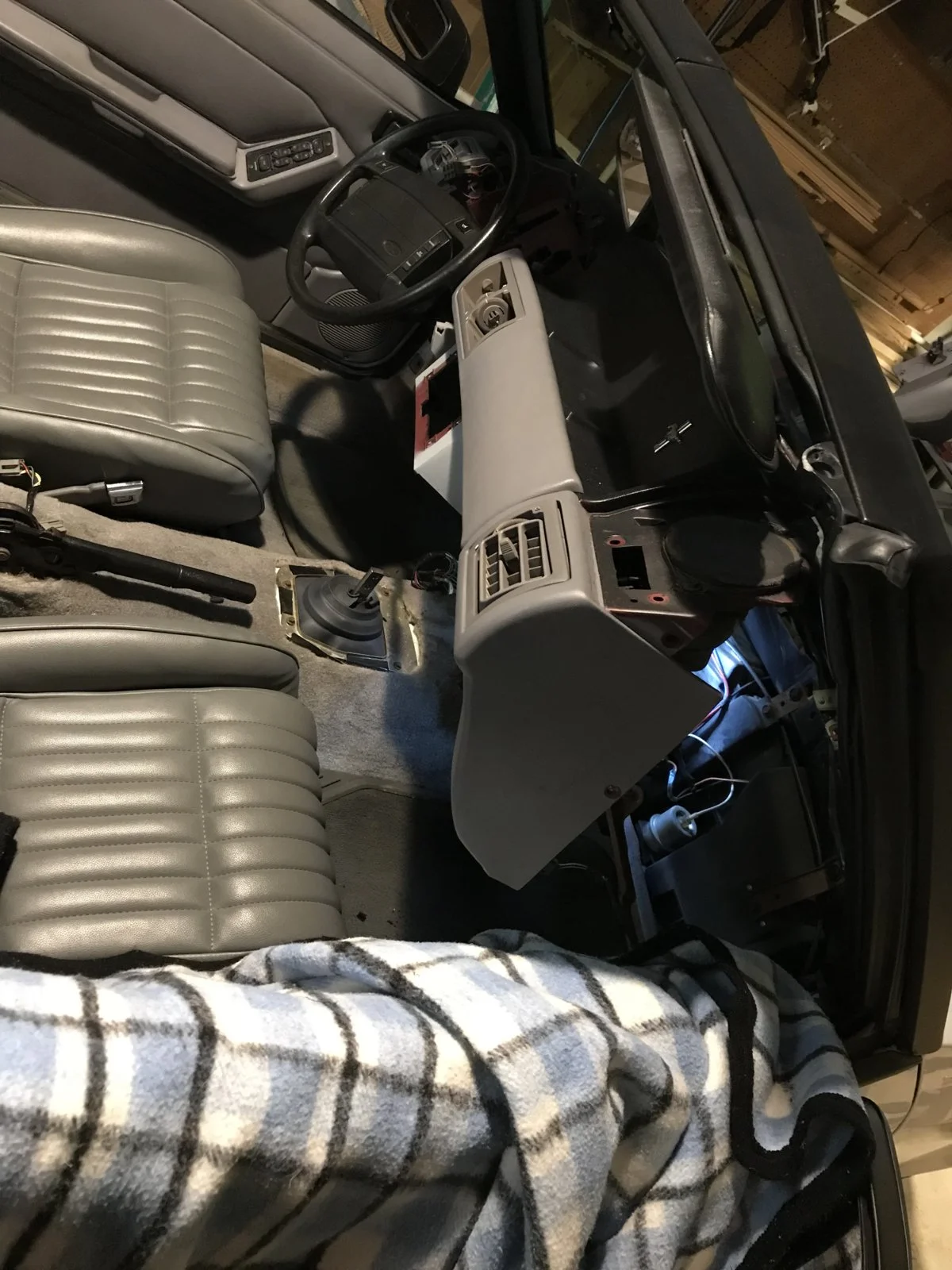

Not having cup holders really makes it tough to work under the dash and drink beer.

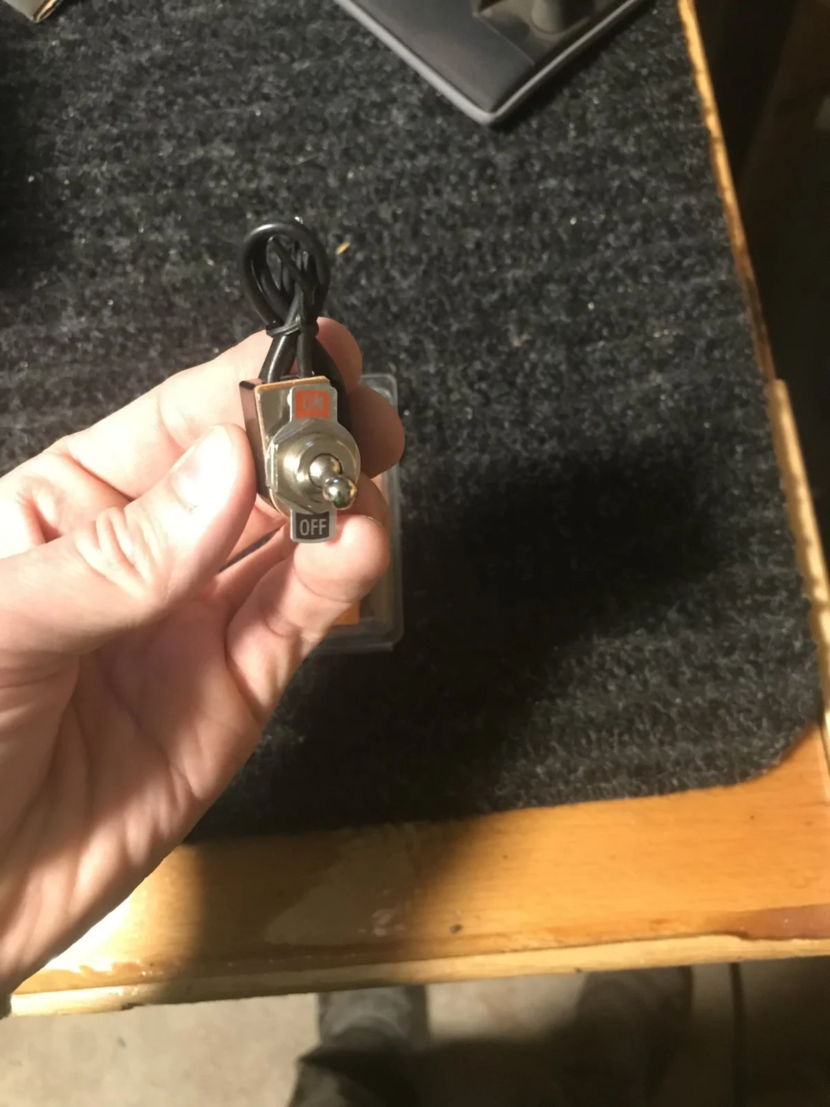

To be installed
Control cable and actuators
Fuel kill switch
Initial LED purchase to see how it goes, only 5 of them to check things out

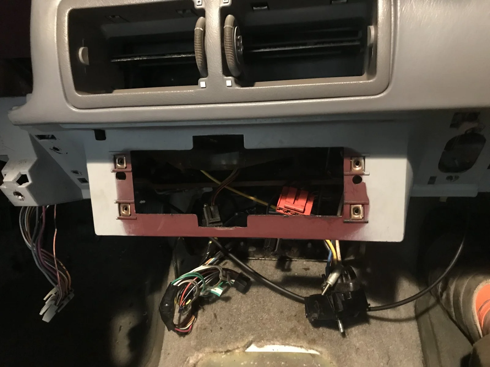

Control cable installed, not the hard part.
This will be the hard part
That;s an original screw, although it shouldn't be gray. Looks like your dash was painted or someone painted the screw head to match
Correct
JAA
5 Year Member
Oct 2, 2018
674
110
63
Central MA
Oct 24, 2018
#40
  • Oct 24, 2018
  • #40
Over/under on how many extra screws I will have? The line is set at 4.5.
