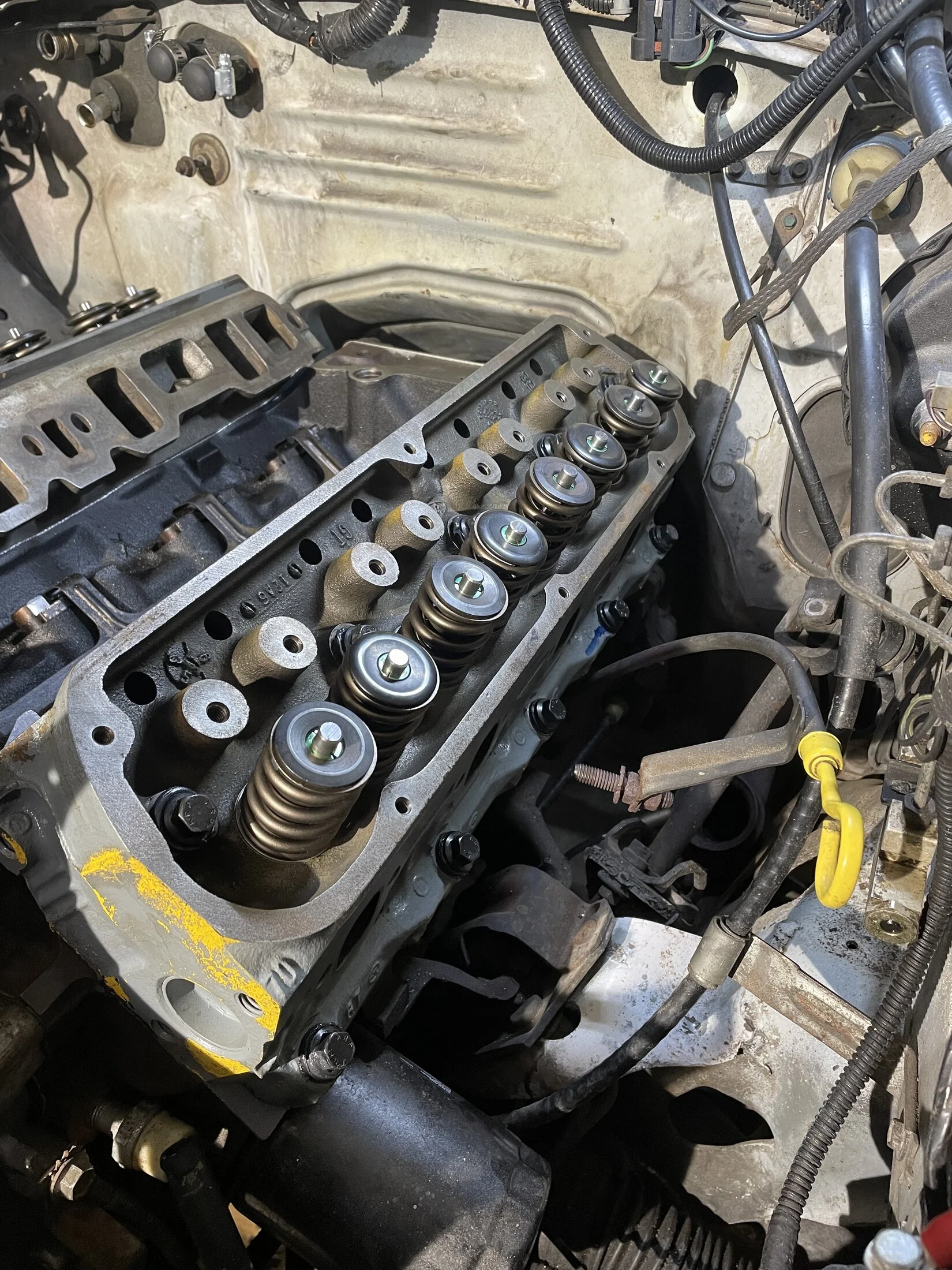

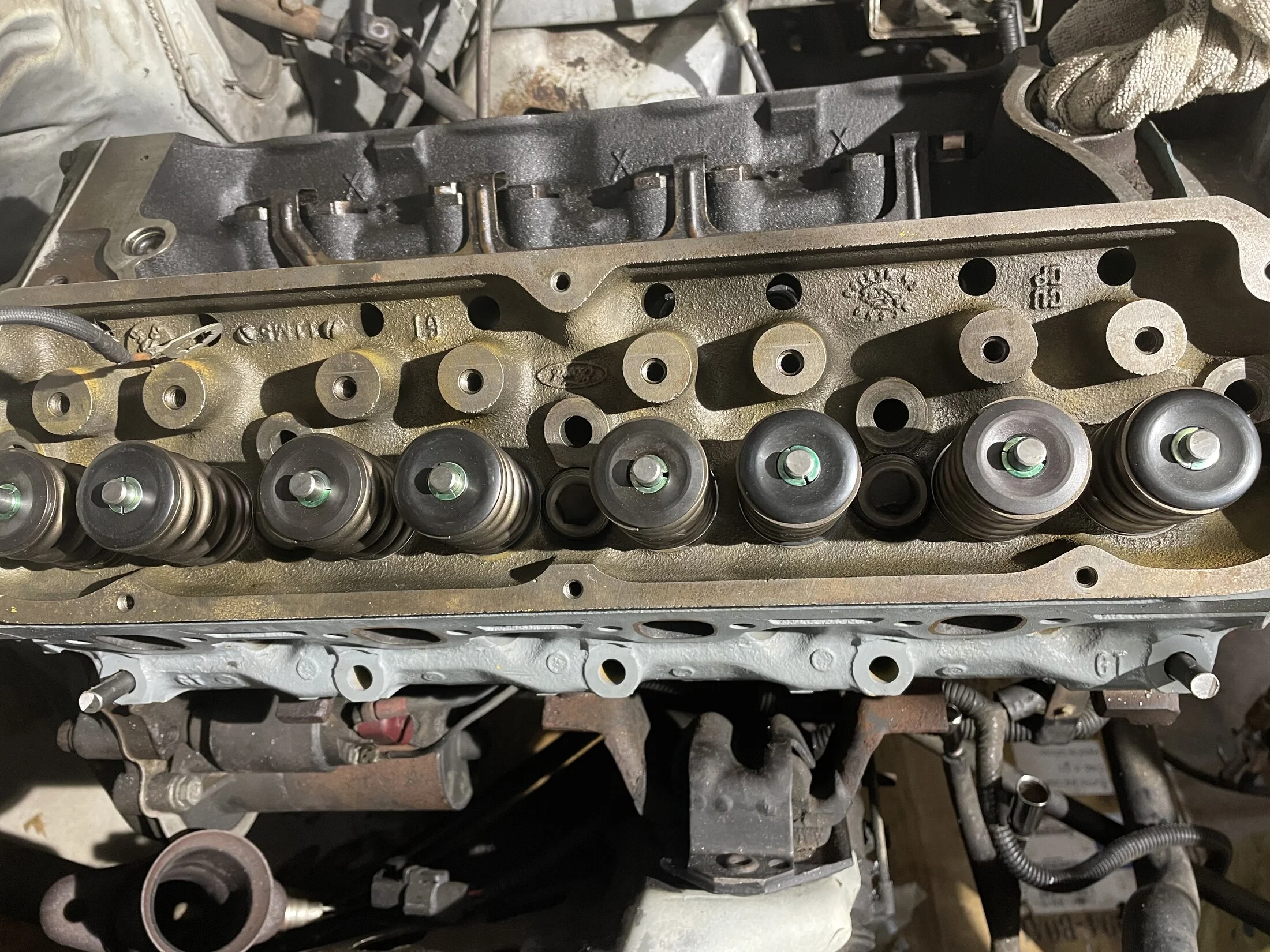

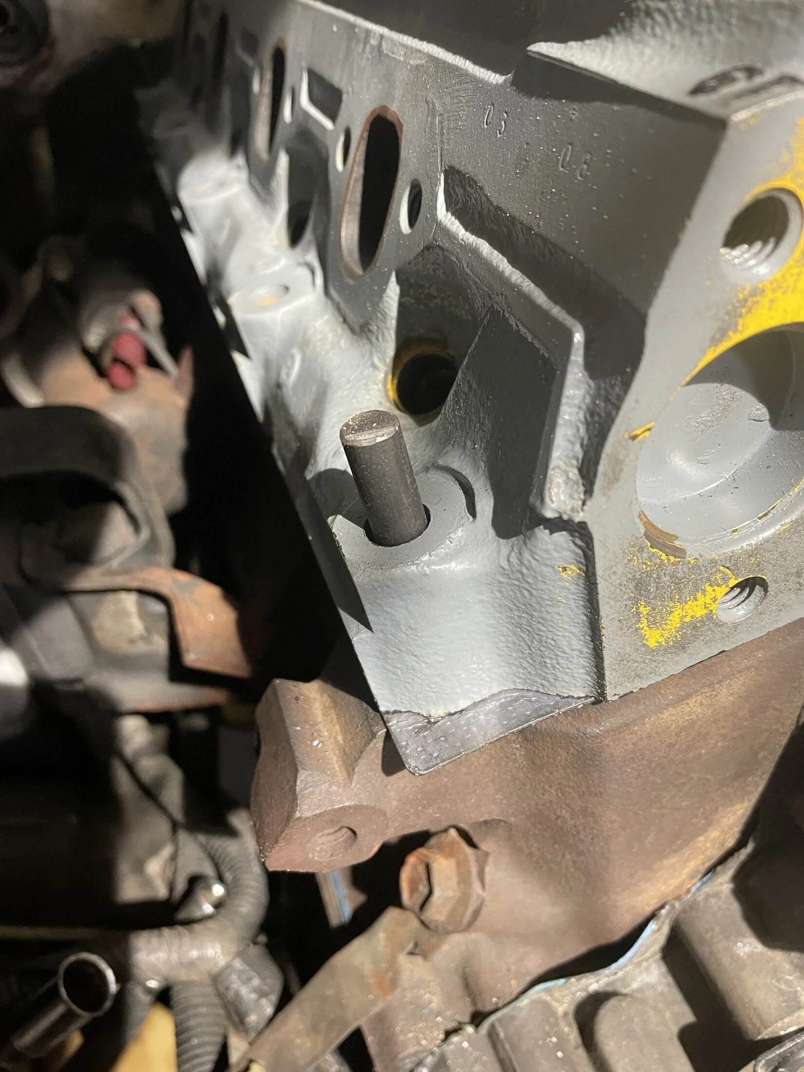

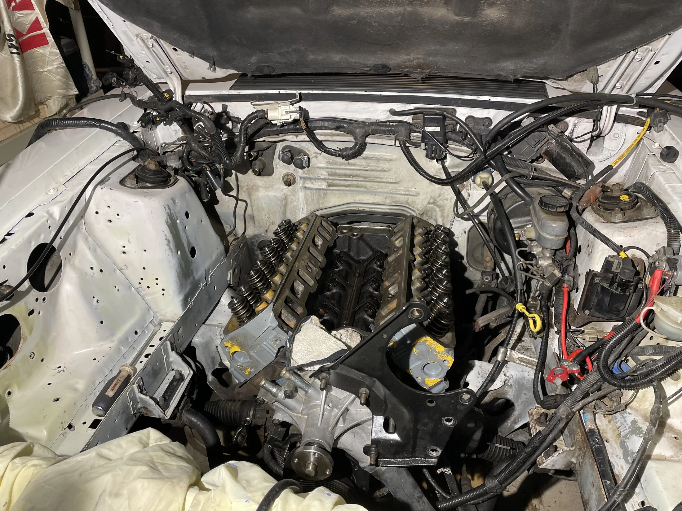

How the hell am I supposed to lean over the engine with that 50lb head and get those dowels lined up without the gasket slipping?
... off to youtube!

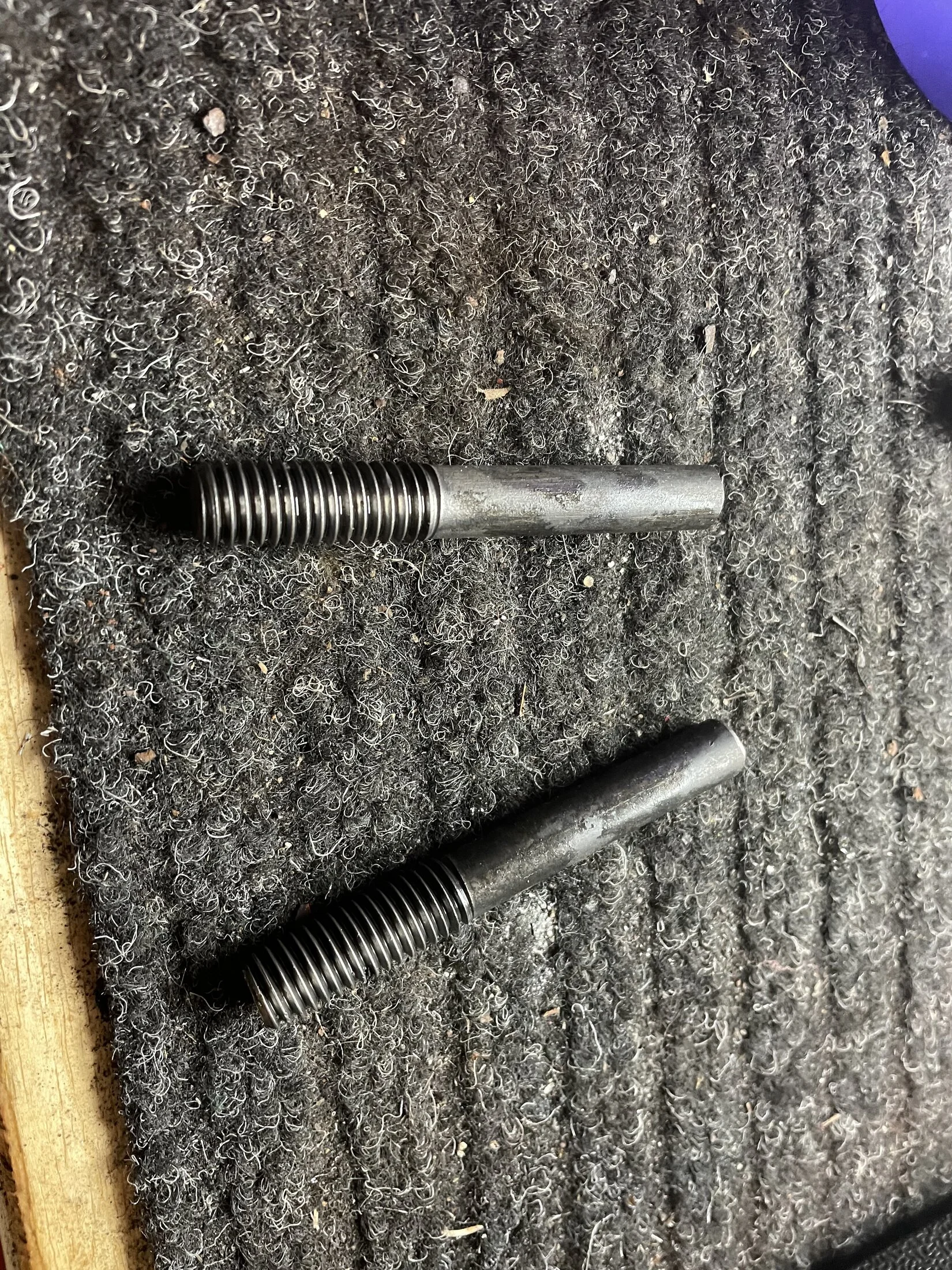

What if I cut the heads off of some of my old head bolts. Put 2 of the smaller ones in the dowels and then make it easier to line up the head?

Yes. Worked great, just use the longer bolts

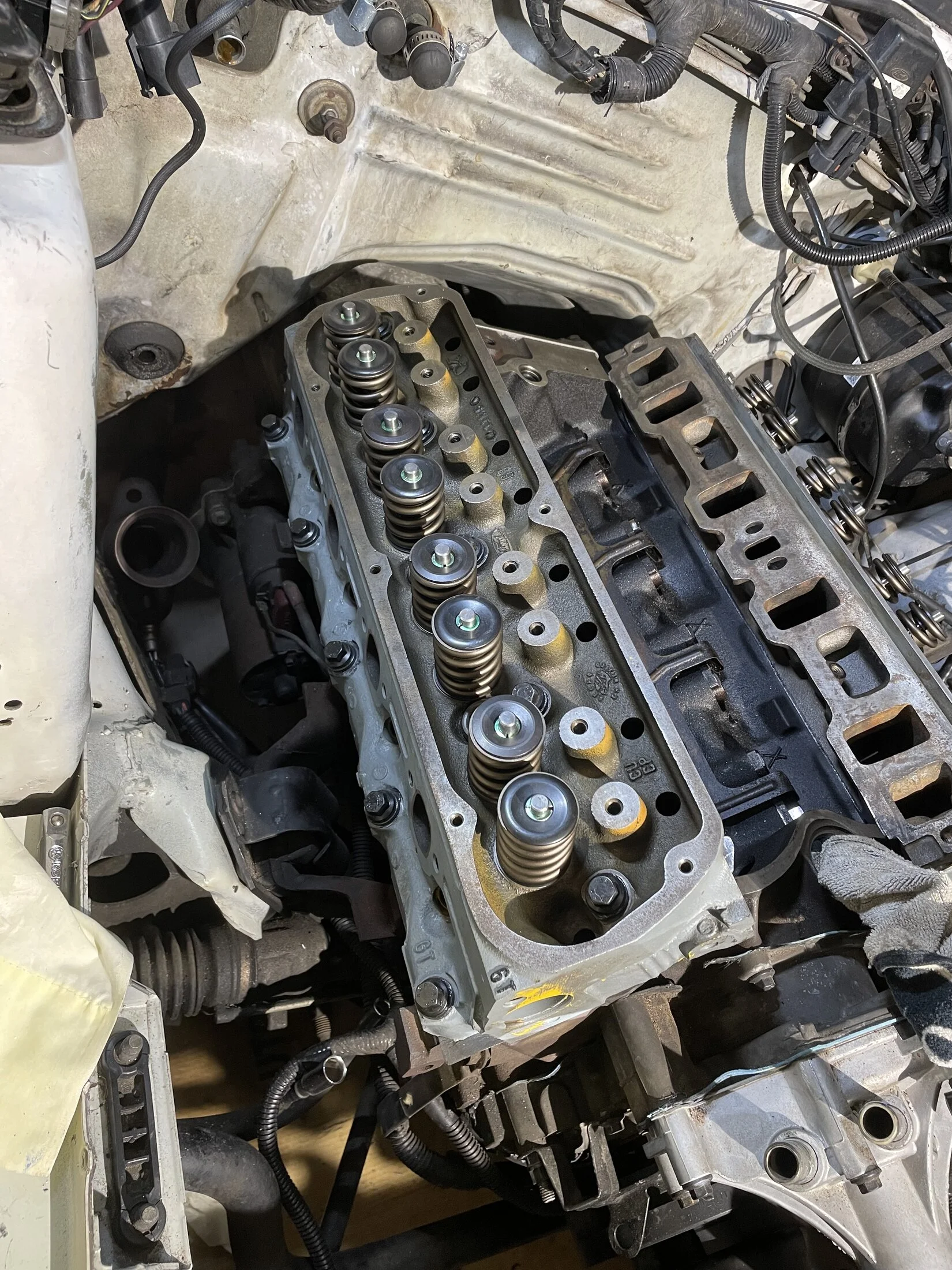

Hand tighten of the long bolts put in the top.
Headed to family for Easter. Back and sober on Monday.

50-60-70 both sides

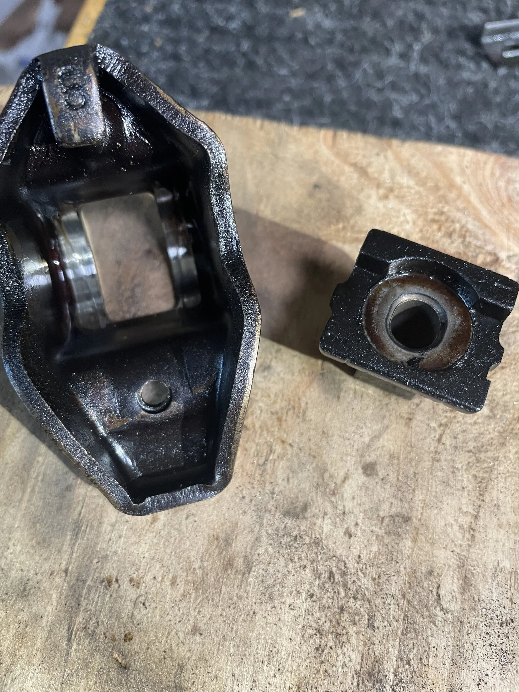

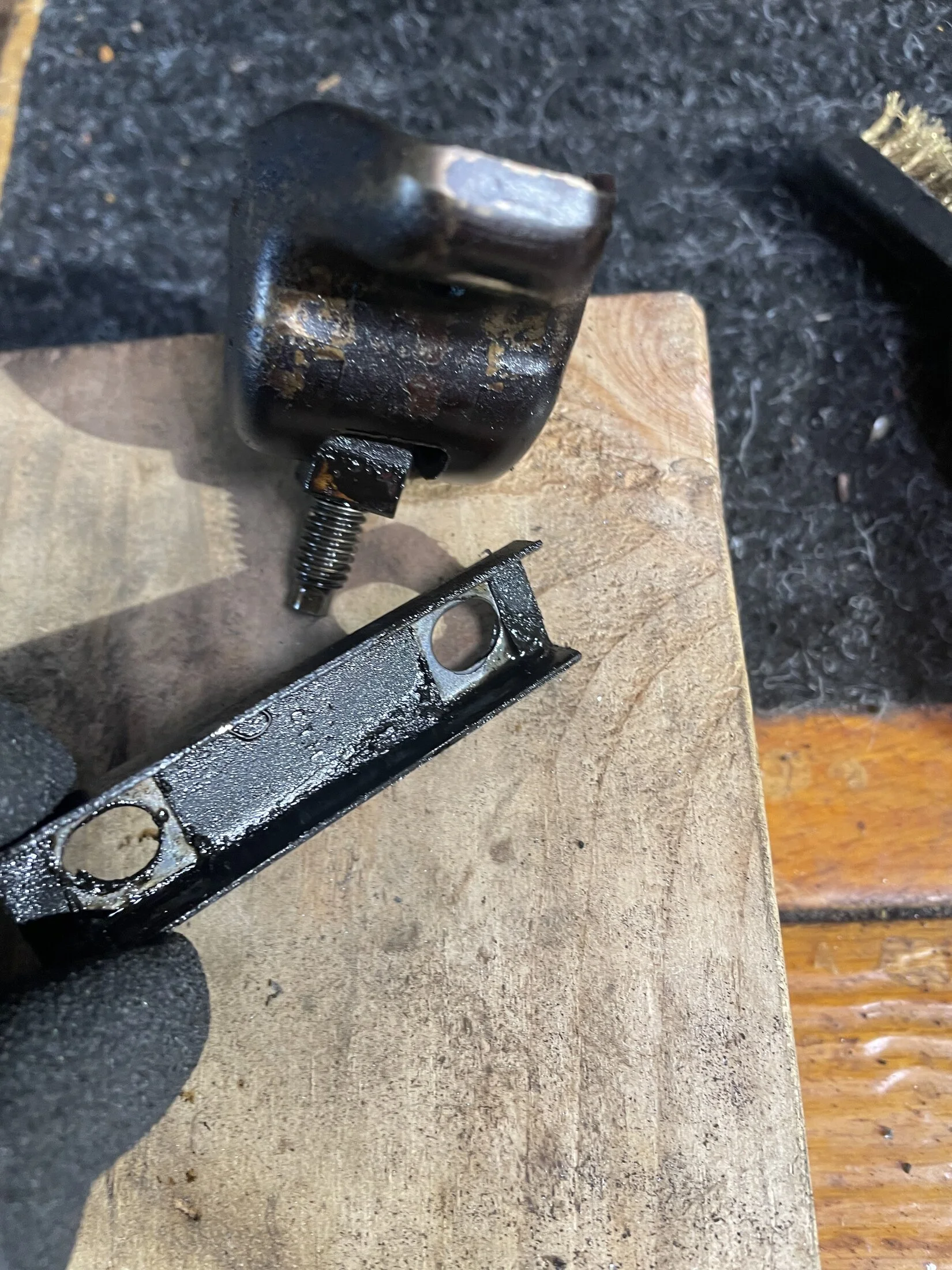

How much cleaning up of rocker arm hardware should one do or not do?

Clean the rocker arms and hardware up with some solvent and a good brush or something like that. Cleanliness is the key to happiness or in this case good oil pressure and no rod knock.

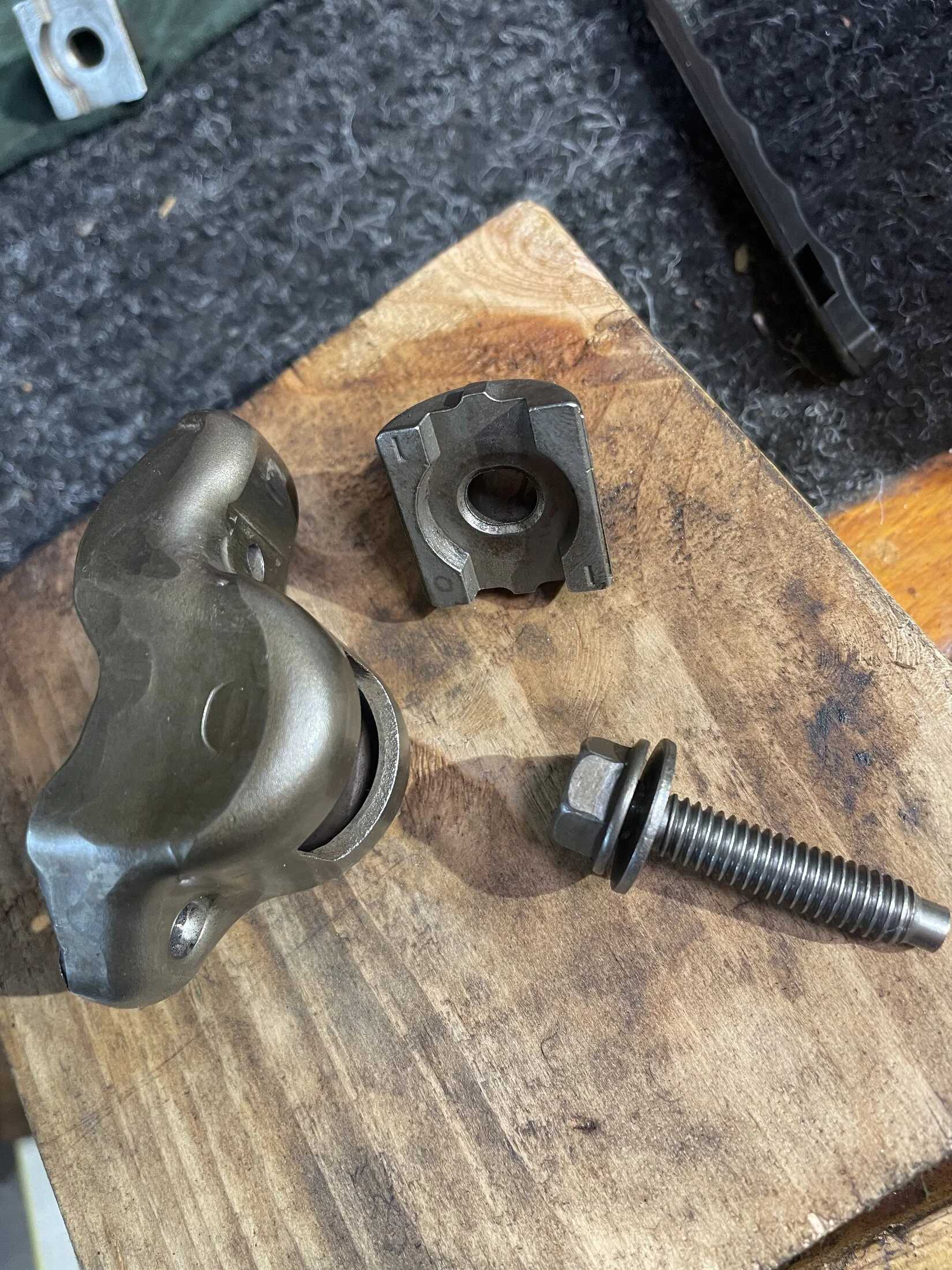

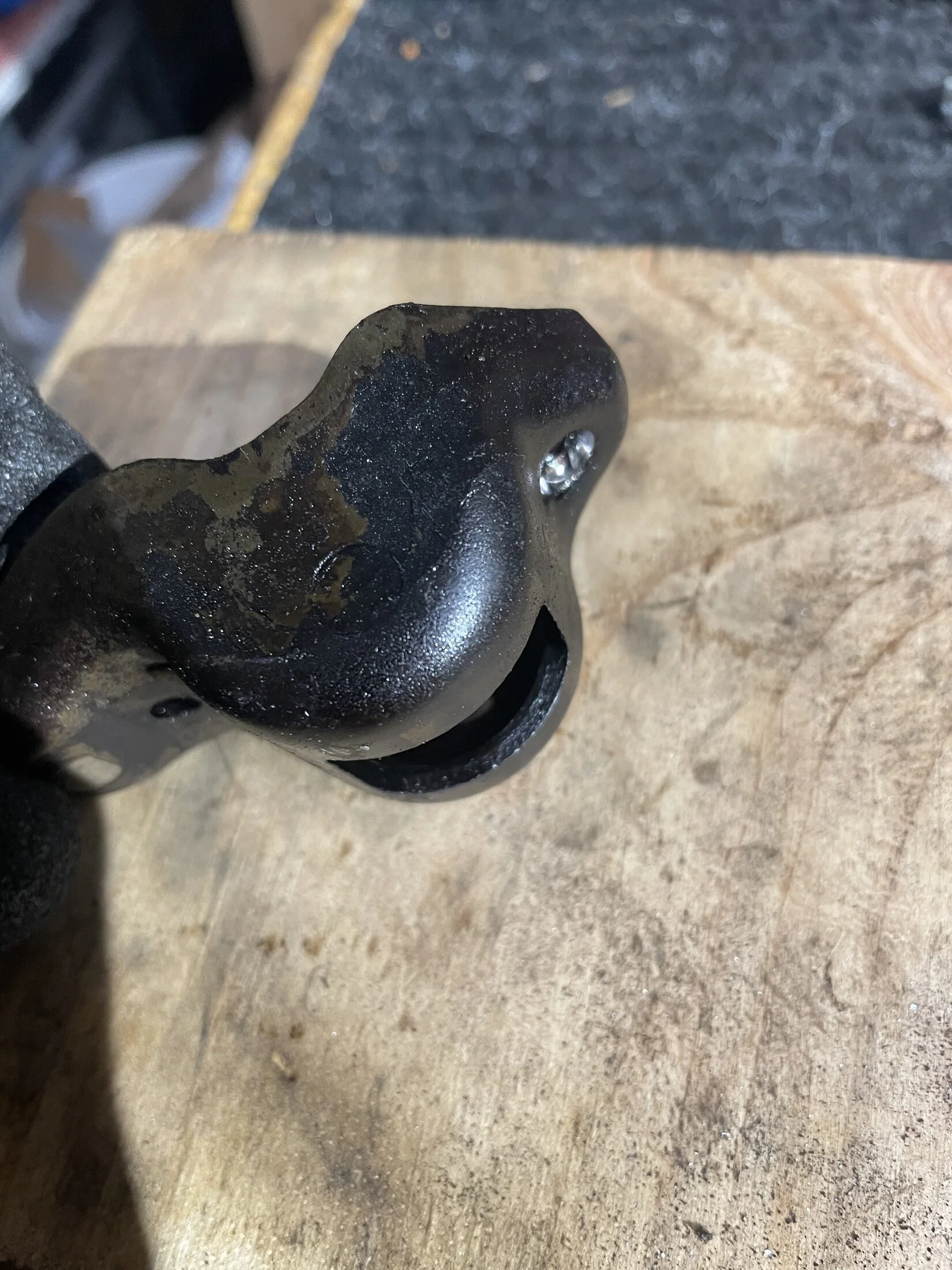

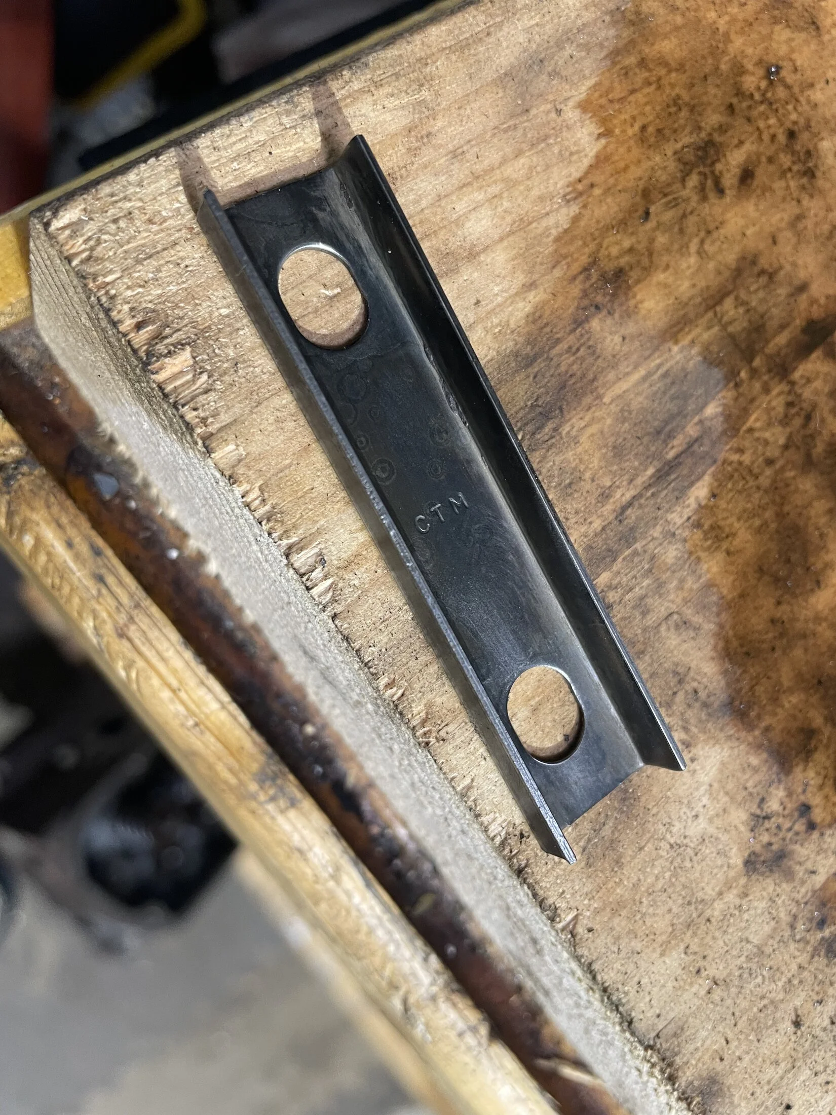

I’m going to keep rocker hardware together and keep their cylinder and valve, but is any of the hardware keyed? It looks like the pivot can be flipped over. As well, is that plate between valves keyed at all? Looks like it can be flipped.

Not sure about bolt down style rockers but someone will chime in.
