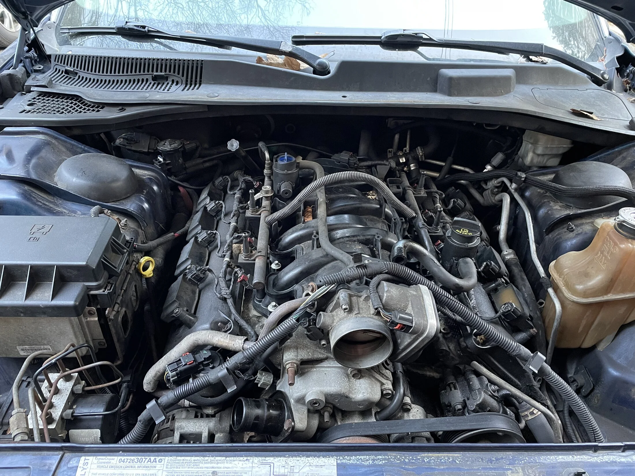

Please forgive me but I’ve been working on this, this afternoon for my oldest
Oct 28, 2001
6,117
4,212
183
Claremore, OK
Apr 16, 2023
#605
  • Apr 16, 2023
  • #605
What is it?

AeroCoupe said:
What is it?
5.7 hemi in 2005 Dodge Magnum

You should be able to fix it by pulling the drink holder out, remove said Dodge from the garage, drive any other vehicle into the shop, install the drink holder and enjoy.

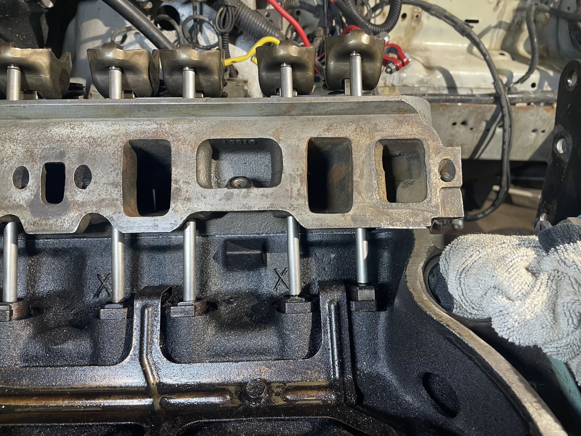

Spring has been busy. Lots of car work, just not with the fox.
Just finished cleaning all rocker bits. All assembled.
Gonna start tightening down valvetrain. Using these 2 videos as previously posted.
Gonna use this basic method of rotating cylinders 90deg and following firing order.
FIring order: 1-3-7-2-6-5-4-8

Complete: 1, 3, 7, 2, 6,
Good illustration: https://lmr.com/products/302-firing-order
So just got done 6, moved 90deg to go to 5. Unfortunately, this is what 5 looks like:
What did I miss? I checked each rocker visually before tightening down and they all were low

Its just not on the base circle of the cam.... I just use a bump switch on the starter relay until it is, as long as its on the base and not lift area of the lobe your fine to adjust adjust them.

It seems the lifters in cylinder 5 are sticking. If I poke them down they will go. Not a push them down, like an unsticking and they fall down.
