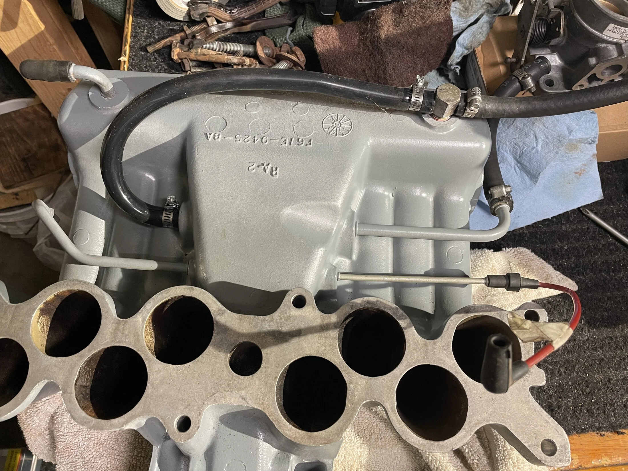

Looks like another $90 for something like this?

You just need vacuum hose so most parts stores should carry what you need.

JAA said:
Lol
What kind of hose is this? It is special?
Can I use this stuff? Already have it
5 Feet Length High Temperature Silicone Vacuum Tubing Hose for Multiple Use (Black,1/4 inch, 6 mm) https://a.co/d/cmXsQ6j

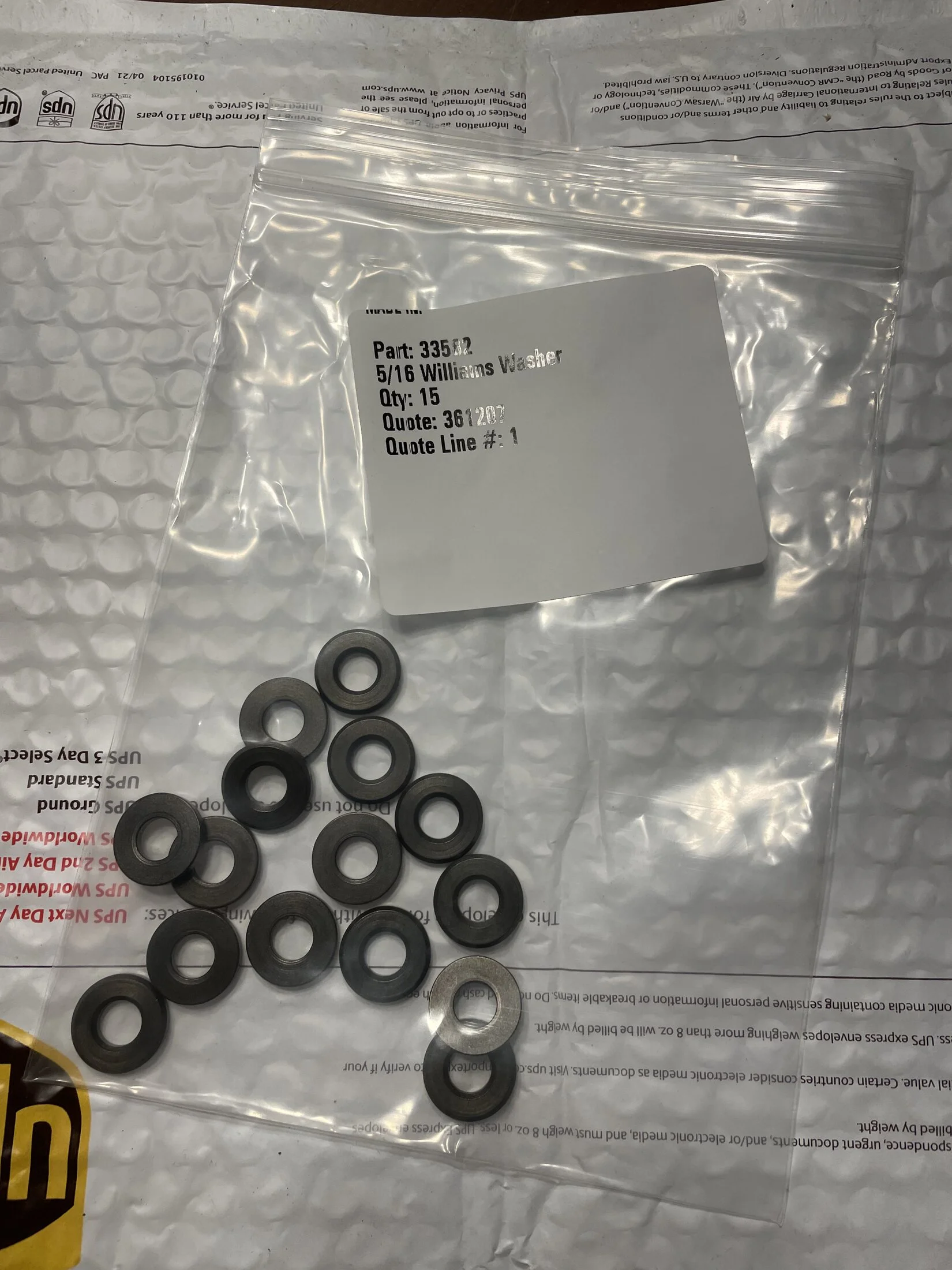

Aight - these super awesome ARP studs should be here shortly. The amazing washers too. Gonna watch a gazillion videos on how to install the intake with studs
I believe @General karthief mentioned to use a little oil with the washers. This still correct with these special washers?

Green light on the silicone hose here too. I would replace all those lines with it as they are all probably in bad shape.
Put some ARP lube between the nut and the surface of the washer it contacts. Remember a little bit goes a long way.

AeroCoupe said:
ARP lube between the nut and the face
Not how I would have posted but I do agree,
I believe the ARP stuff has a coating but still some lube will help with accurate torque readings.
Reactions: Monkeybutt2000 and JAA

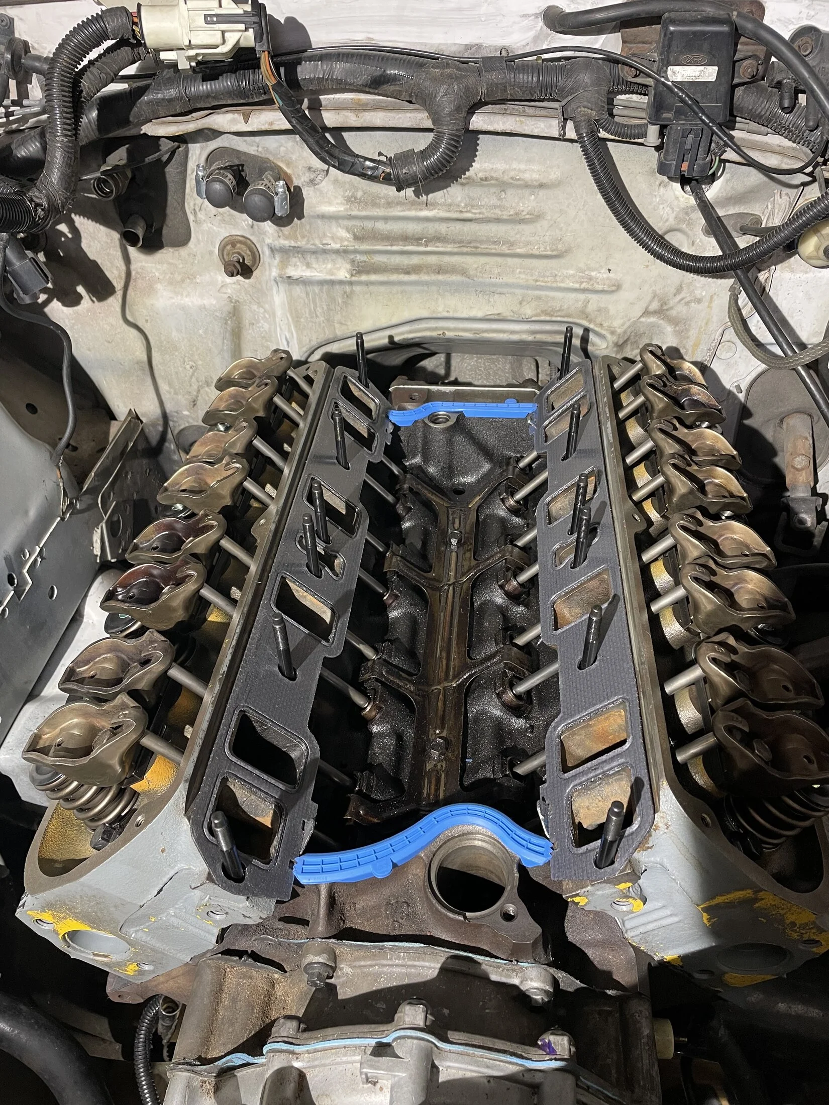

How do I know how far to put the studs in since they won’t bottom out? Just enough? Dealers choice?
I’m speculating the instructions will tell me. If not, I’ll prolly just do it to eye guessing.
Edit: Looking at the packaging from online, im speculating i should tighten until it bottoms (tops?) out?

The lower intake studs on my car bottom out being the lower threads are coarse and only threaded up the body of the stud so far.

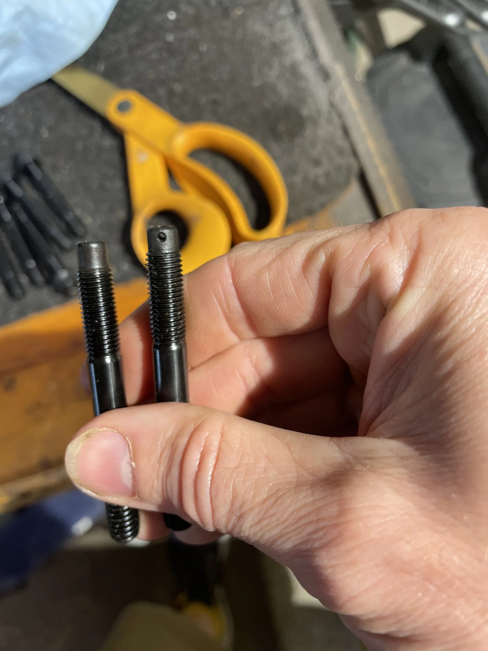

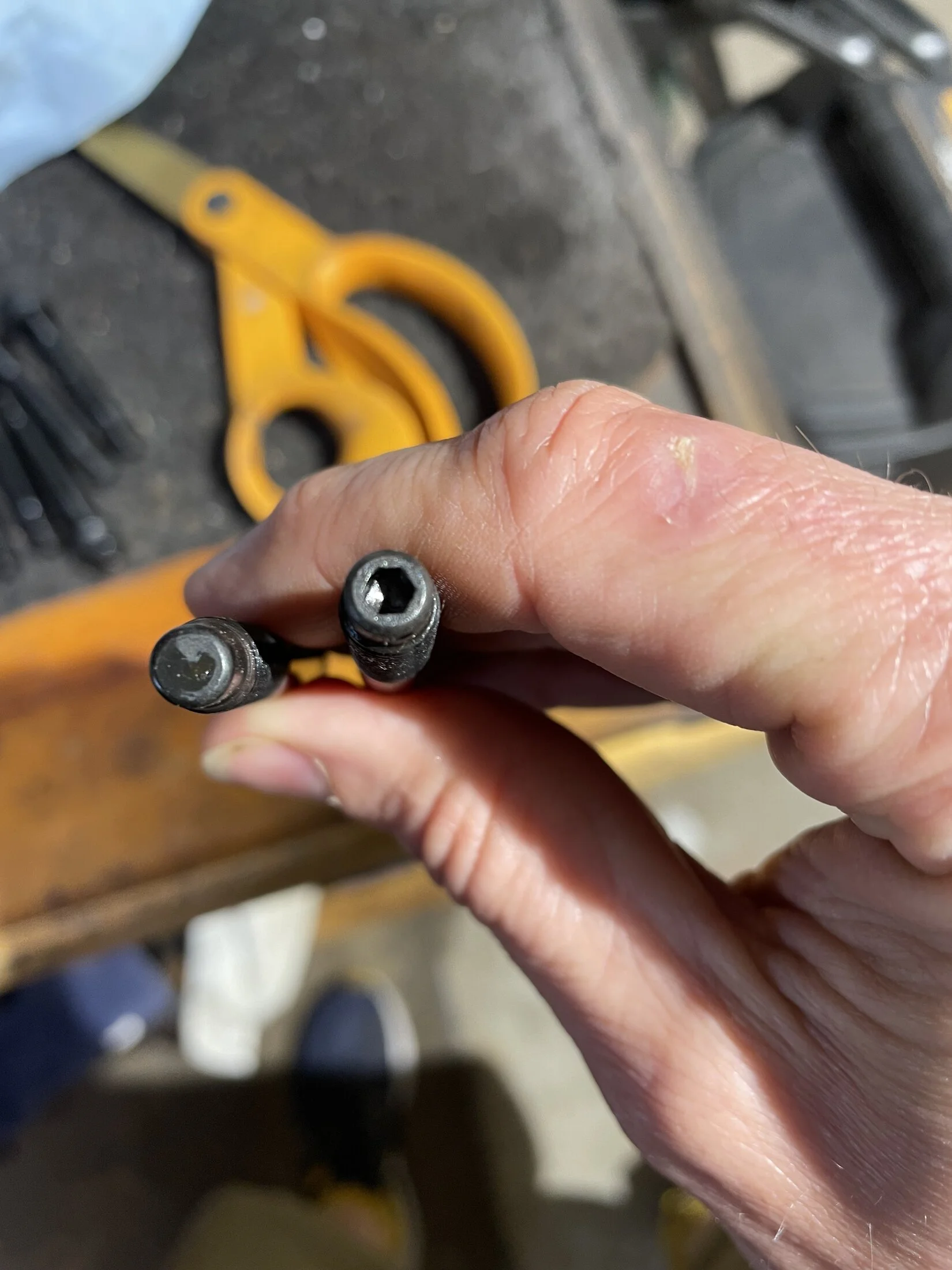

one of the intake bolts is hex and kottered? Is this for the drivers side one near the firewall that originally had the stud?
I’ll do some searching, just odd and I missed if the online instructions had anything. No instructions on package.

Studs in, assuming the odd one is in the correct spot.
Waiting on shipping of “special” washers. They better whistle Dixie as I tighten them!

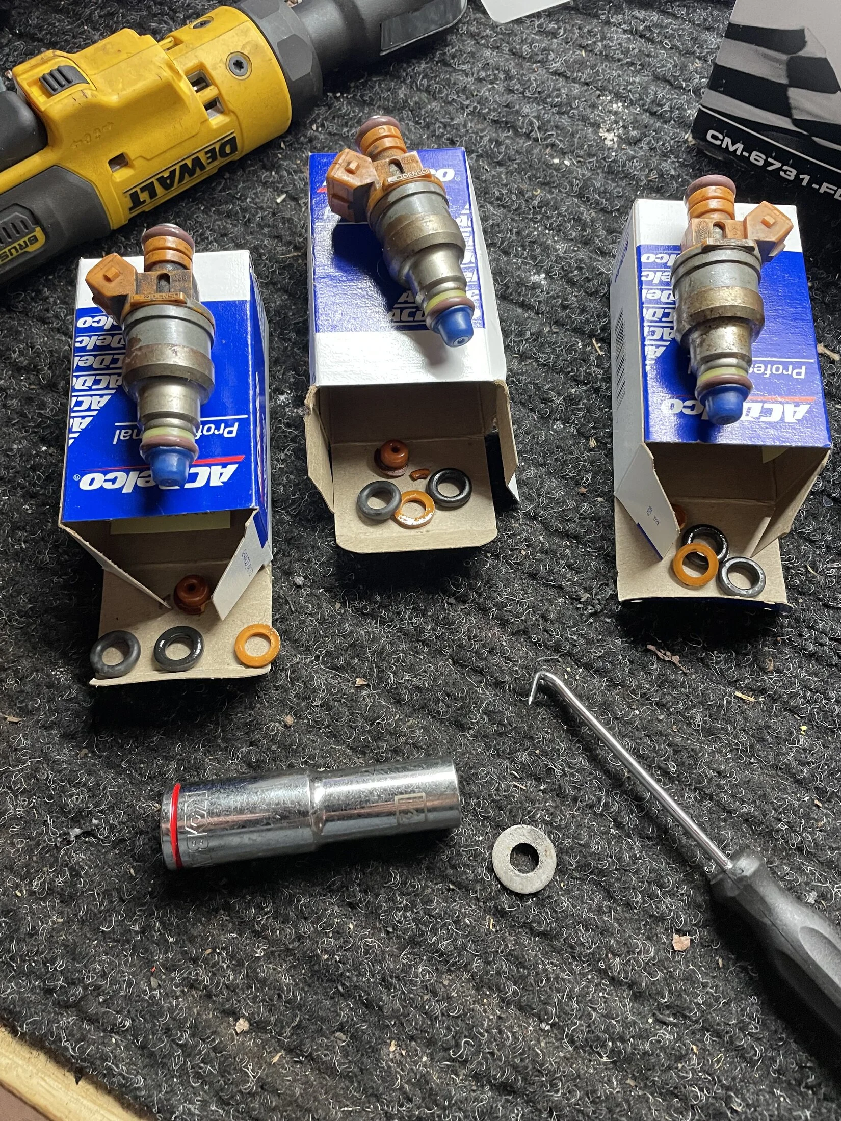

3 broken injectors redone

Lol. The new ones fit a lot more snug
No instructions on this kit. I may just call Arp today as I’m super curious.
My speculation is this is for that one original stud intake. Allen’d so that the second nut can be removed in the future without potentially un-torquing the stud.
I’m still a little perplexed with the hole. Do they really recommend a koetter pin there “just in case” that second nut starts coming loose? OEM certainly didn’t have anything like that.

@JAA - I have no idea as to why only the one stud has a hex end and the hole through it. I would not worry about it and just move on. The only lower intake stud that is used to attach something on the Coupe is the one for the heater core tubes on the passenger side and it just has a washer and regular hex nut and does not back off.

You know those washers have an 'up' side and a 'down' side
